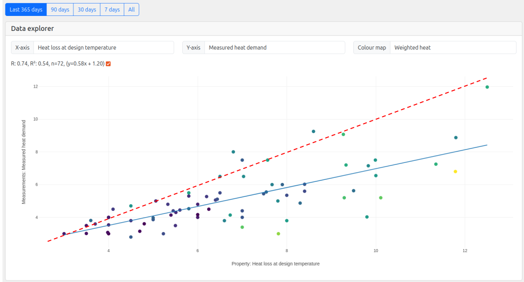

The following chart plots the pre-installation calculated heat loss with the post-installation measured heat loss for each system: [Open chart]
In a similar result to the chart on calculated vs measured design flow temperature, we see again here that measured heat loss is lower in practice than the calculated design heat loss for most systems.
To give a couple of examples that center on the line of best fit:
5.6 kW calculated heat loss = 4.5 kW measured heat loss (20% lower)
7.5 kW calculated heat loss = 5.6 kW measured heat loss (25% lower)
10 kW calculated heat loss = 7.0 kW measured heat loss (30% lower)
Many of the systems on HeatpumpMonitor.org use more accurate assumptions in their heat loss calculations such as lower air change rates. Some systems will have also had their calculated heat loss assumptions updated to produce a value that better matches the measured value (likely the few systems that track the red line). It’s expected that the overall gap here is lower than in the wider industry.
We do however see plenty of examples with greater differences, e.g a 10 kW Grant with a 6.6 kW calculated heat loss and 3.8 kW measured heat loss. This heat pump is 2.6x larger than the measured heat loss, a result that is not unusual.
The general result from the above chart is consistent with our understanding of how the assumptions used in heat loss calculations tend to over-inflate heat loss.

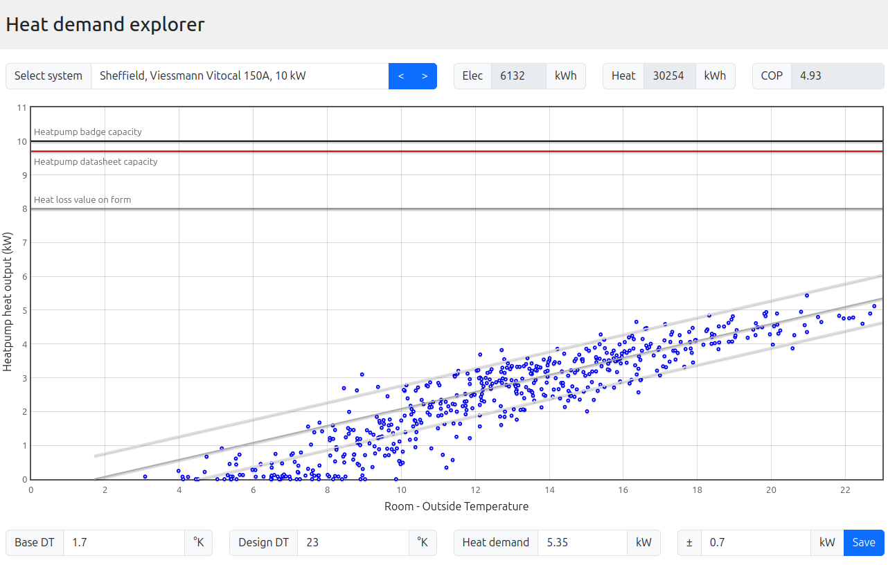

HeatpumpMonitor.org heat demand tool
Note: Unlike the flow temperature comparison the measured heat demand values used in the chart above have been extrapolated to design conditions (where design conditions have not been met). This is done using the HeatpumpMonitor.org measured heat demand tool.
A couple of examples of how this tool works can be found here:
System 68: 10kW Viessmann Vitocal, 7.2 kW calculated heat loss, 5.4 kW measured heat demand: https://heatpumpmonitor.org/heatloss?id=68
System 278: 10 kW Vaillant, 7.5 kW calculated heat loss, 7.0 kW measured heat demand: https://heatpumpmonitor.org/heatloss?id=278
Here’s a screenshot from the Viessmann Vitocal:
The precision of the measured heat loss value is typically +-15%.

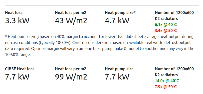

In order to explore the difference these assumptions can make, we have created a simple heat loss tool that compares more accurate assumptions with the CIBSE defaults. This tool is available here: https://openenergymonitor.org/tools/SimpleHeatLoss.
While using this tool, notice how an over-estimated heat loss suggests that a lot more radiators are required to run at lower flow temperatures than a more accurate heat loss calculation. Over-inflated heat loss calculations confuse our expectations for the flow temperatures needed.
