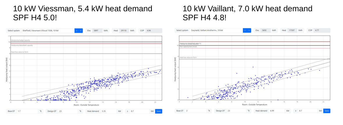

  • System 68, 10 kW Viessmann 5.4 kW heat demand, SPF H4 5.0 (80% margin on top of the measured heat loss, 35% margin on top of the pre-installation calculated heat loss.) [13].
  • System 278, 10 kW Vaillant, 7.0 kW heat demand, SPF H4 4.8 (35-40% margin on top of the measured heat loss, -15% margin on pre-2000 DHDG CIBSE assumptions = 11.7 kW) [14].
There are also plenty of 5 kW units on the site that are delivering SPF’s around 4.5 with a real world measured heat loss of 3.5 kW (40% margin).

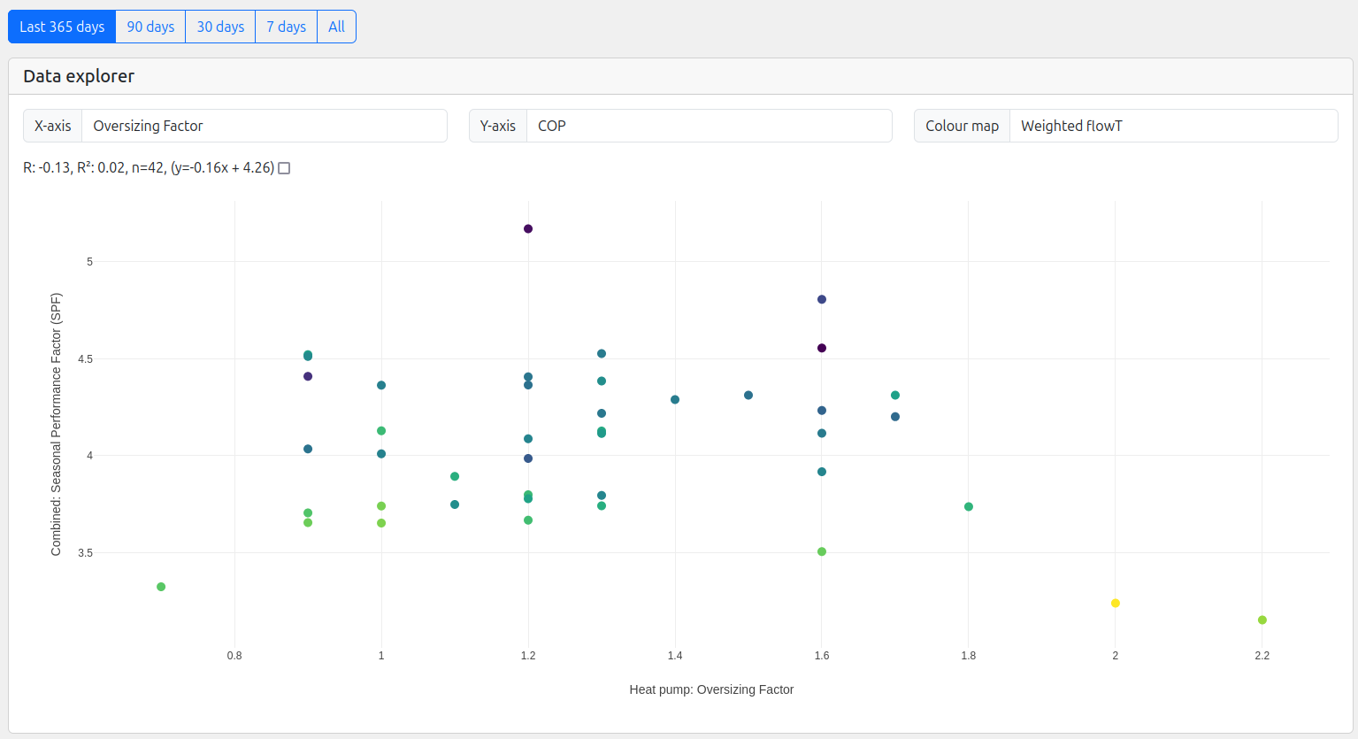

Over-sizing factor vs performance: Vaillant Arotherm+
Plotting over-sizing factor based on measured heat loss vs performance for Vaillant Arotherm+ units, we don’t see a strong relationship at least in the 0.9 to 1.6x range. We see an example of top end performance at 1.6x (system 139, 5kW Arotherm+) This is not to say there isn’t a relationship, plotting over-sizing against performance like this can give a misleading impression given that performance is dependent on a much greater range of factors (see next example looking at Daikin units). [Open chart]

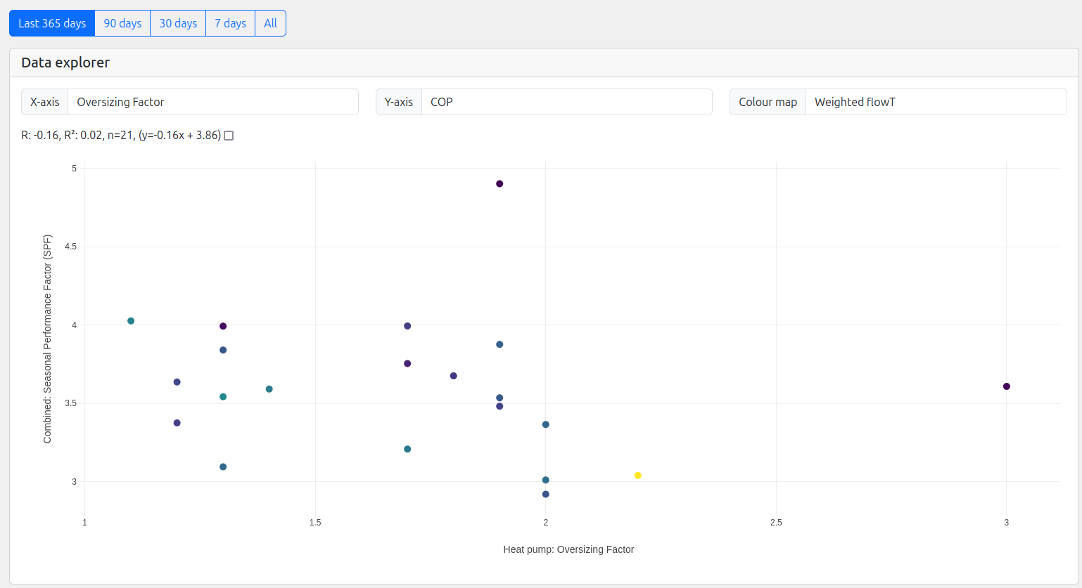

Over-sizing factor vs performance: Daikin Altherma
When we plot badge capacity based over-sizing factor against performance for Daikin units, this chart does not at first suggest a strong relationship [Open chart]:
This does not however reflect the real world experience on the OpenEnergyMonitor forum for the potential performance improvement from right-sizing a Daikin Altherma unit, see thread https://community.openenergymonitor.org/t/is-an-oversized-daikin-really-a-problem/26930/17.

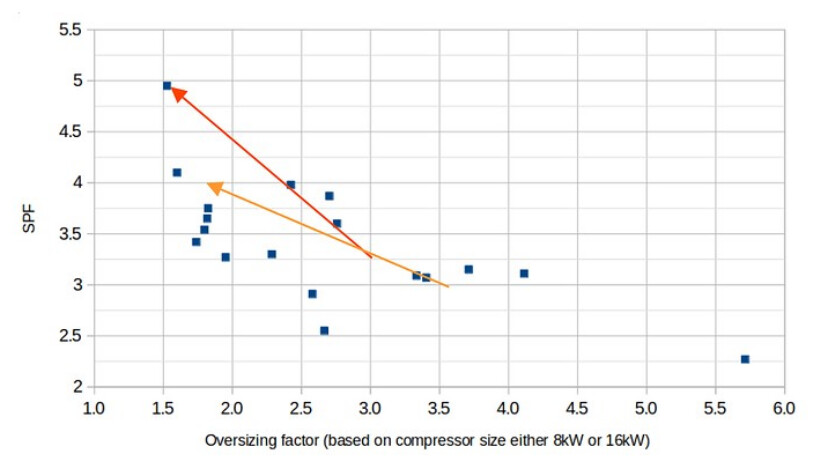

The following chart shows the very substantial performance improvement seen when two large 9-11 kW Altherma units were swapped out for 8kW units that better matched heat demand. Performance went up by a whole +1 SPF.
This highlights a limitation of de-rated heat pump models. The 9 kW Daikin Altherma uses the same compressor as the 16 kW unit, resulting in a relatively high minimum modulation level.
Example: While the 9 kW model appears to have an oversizing factor of 1.5x—50% above a real-world heat demand of 6 kW—the de-rated 16 kW compressor effectively increases this to a 2.7x oversizing factor.
Notice the much wider X-axis range on the following chart of over-sizing factor based on the compressor size vs performance:
