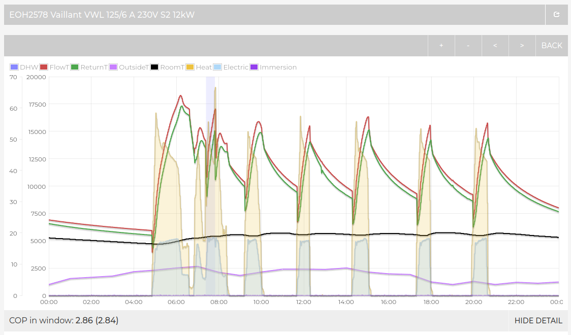

The following example from system EOH2578 is illustrative of one common issue seen across a fairly large proportion of Vaillant systems in the study.
The key issue here is that the system is ramping up to much higher flow temperatures than required, the system is then cycling on room temperature, turning on and off on the thermostat.
Dashboard link: https://eoh.heatpumpmonitor.org/emoncms/EOH2578/app/view?mode=power&start=1645488000&end=1645574400
The long off periods (~1.5 hrs) visible between the high temperature cycles together with the fact that the compressor is running at near full capacity when it is running, indicates an opportunity for the system to deliver the same amount of heat and comfort by running at a lower flow temperature and at a lower compressor modulation. This would result in a substantial improvement in performance.
The pattern seen here of the flow temperature ramping up to a higher flow temperature than required is consistent with either the weather compensation setting being set too high or the system being ran with a high fixed flow temperature target. The flow temperature and compressor modulation can be reduced by reducing the weather compensation curve setting and turning weather compensation on if not currently in use.

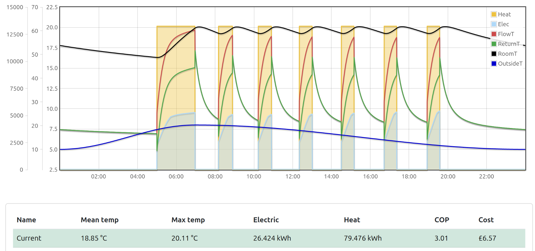

Simulated performance results: To get an idea of the performance improvement that might result from this change, we can simulate this system using our dynamic heat pump simulation tool.
Use the following parameters to simulate the illustrative example from system EOH2578 above:
  • A heat pump COP model based on interpolation of the detailed data tables provided for the 12 kW Vaillant Arotherm+ available in the Czech datasheets.
  • Building heat loss of 6.9 kW.
  • Radiator rated output at ΔT50 of 22 kW.
  • Room set point control enabled with a schedule targeting 19.6°C between 5am and 9pm.
  • Outside temperature averaging 6.5°C with a 4°C oscillation,
  • System volume of 120L
To reproduce the pattern observed of the heat pump running at near max output during the brief run periods, the Vaillant heat pump is simulated as having a fixed compressor at 74% modulation, this provides blocks of heat output at ~13 kW which is close to that observed in the EOH2578 example.
For ease of reproduction the following JSON configuration can be imported into the tool:
{"days":4,"building":{"heat_loss":6900,"internal_gains":390,"fabric":[{"proportion":52,"WK":576.9230769230769,"kWhK":48,"T":16},{"proportion":28,"WK":1071.4285714285713,"kWhK":8,"T":17},{"proportion":20,"WK":1499.9999999999998,"kWhK":4,"T":18}],"fabric_WK":299.99999999999994},"external":{"mid":6.5,"swing":3,"min_time":"00:00","max_time":"07:00"},"heatpump":{"capacity":17900,"system_water_volume":120,"flow_rate":12,"system_DT":5,"radiatorRatedOutput":22000,"radiatorRatedDT":50,"prc_carnot":47,"cop_model":"vaillant12","standby":30,"pumps":15,"minimum_modulation":40},"control":{"mode":"3","wc_use_outside_mean":1,"Kp":2500,"Ki":0.2,"Kd":0,"wc_Kp":500,"wc_Ki":0.05,"wc_Kd":0,"curve":1,"limit_by_roomT":true,"roomT_hysteresis":0.6,"fixed_compressor_speed":74},"schedule":[{"start":"00:00","set_point":10,"price":24.86},{"start":"05:00","set_point":19.6,"price":24.86},{"start":"21:00","set_point":10,"price":24.86}]}
This simulation run, yields a COP of 3.01, slightly higher than the COP of 2.86 observed in reality:

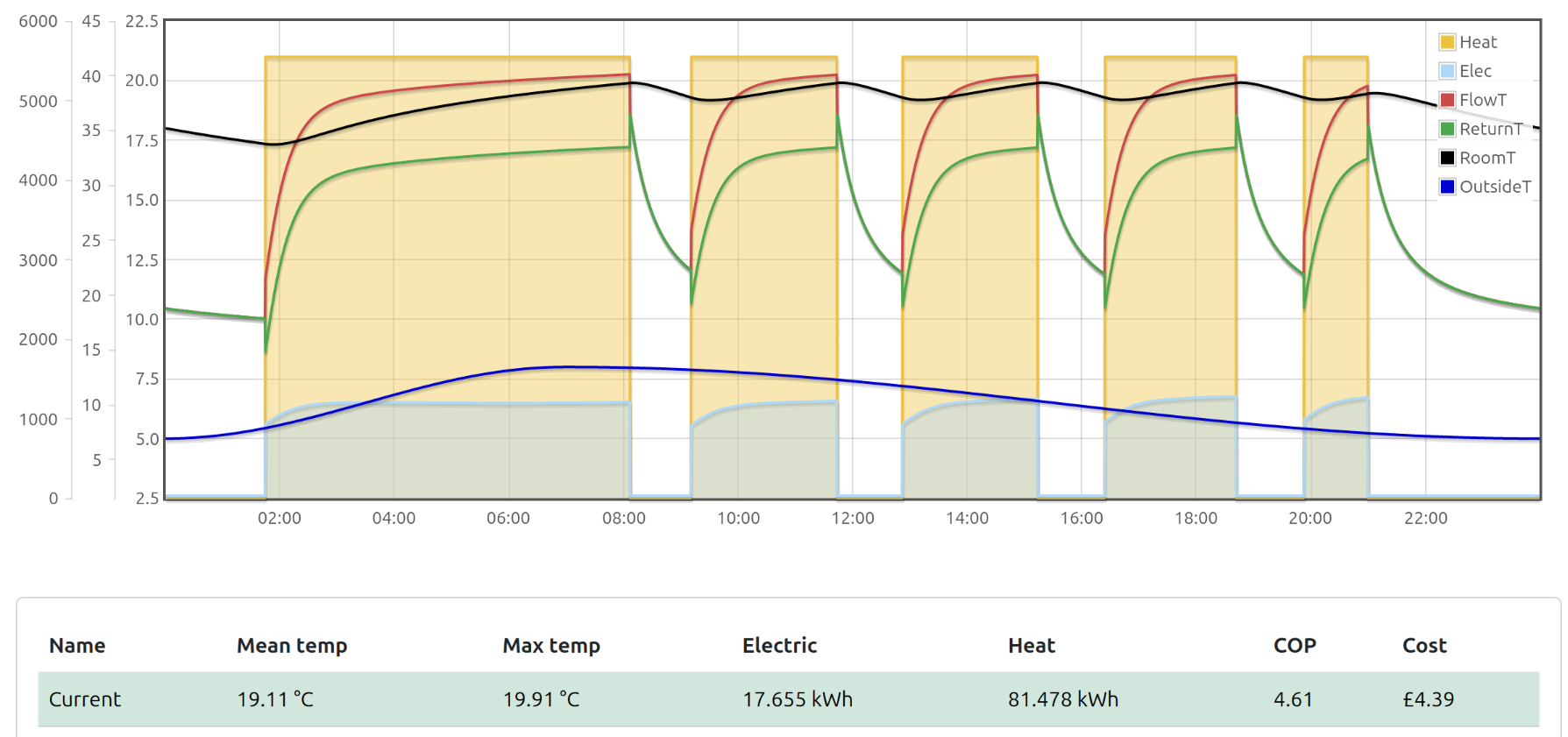

To assess the impact of optimizing the weather compensation curve, the simulation was repeated with the compressor speed reduced to the minimum required to maintain the indoor temperature set point. The schedule is also revised to start earlier in order to maintain the indoor temperature at the expected set point for the same period of time.
We typically see the 12 kW Vaillant Arotherm+ modulate down to ~5.5 kW of heat output on HeatpumpMonitor.org. This is reproduced in the simulator by setting the fixed compressor modulation to 31%. We need to move the schedule starting time forward from 5am to 1:45am to meet the same 19.6C average room temperature between 6:45am and 8:45pm.
This results in a COP of 4.61, demonstrating a substantial improvement in performance from this simple adjustment. The electricity consumed is reduced significantly, from 26.4 kWh down to 17.7 kWh. The morning peak in electricity demand is moved further into the off-peak period, and the peak demand at 6am is reduced from 5.1 kW down to 1.2 kW, providing further benefits to the wider energy system.
Import the following JSON configuration into the tool to reproduce:
{"days":4,"building":{"heat_loss":6900,"internal_gains":390,"fabric":[{"proportion":52,"WK":576.9230769230769,"kWhK":48,"T":16},{"proportion":28,"WK":1071.4285714285713,"kWhK":8,"T":17},{"proportion":20,"WK":1499.9999999999998,"kWhK":4,"T":18}],"fabric_WK":299.99999999999994},"external":{"mid":6.5,"swing":3,"min_time":"00:00","max_time":"07:00"},"heatpump":{"capacity":17900,"system_water_volume":120,"flow_rate":12,"system_DT":5,"radiatorRatedOutput":22000,"radiatorRatedDT":50,"prc_carnot":47,"cop_model":"vaillant12","standby":30,"pumps":15,"minimum_modulation":30},"control":{"mode":"3","wc_use_outside_mean":1,"Kp":2500,"Ki":0.2,"Kd":0,"wc_Kp":500,"wc_Ki":0.05,"wc_Kd":0,"curve":1,"limit_by_roomT":true,"roomT_hysteresis":0.6,"fixed_compressor_speed":31},"schedule":[{"start":"00:00","set_point":10,"price":24.86},{"start":"01:45","set_point":19.6,"price":24.86},{"start":"21:00","set_point":10,"price":24.86}]}

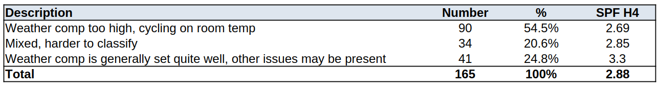

In order to quantify the prevalence of this poor or lack of weather compensation issue, we visually inspected the data from all 165 Vaillant Arotherm+ systems in the Electrification of Heat, one system at a time (Automation of this process needs further work!).
The following spreadsheet includes a comment on each system and simplified categorisation into Good, OK and Bad. Please note, this first attempt at categorising this issue should be seen as a first pass, a rough guide for the prevalence of this issue in the data, further refinement and ideally automation of the categorisation process would be beneficial. The following is published here as an interim result.
Download spreadsheet: EOH_WC_analysis.ods.
The following table summarises the result of this analysis. We can see that this issue does affect a significant share of systems and that the average performance of systems with this issue is worse than those with more optimal weather compensation settings.
The average performance of the systems with more optimal weather compensation settings is still relatively poor compared to the HeatpumpMonitor.org average of 3.9 indicating that other issues are still present.
