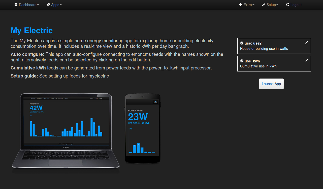

2. Emoncms Feed Setup
See Emoncms > Log Local section of the setup guide.
For automatic MyElectric App setup use the suggested feed names below. The names are case sensitive.
Assuming CT1 (P1) = site-consumption
Click on spanner icon to configure
emonPi2/P1.Select
log to feedand create a feed calledusewith the feed engine set to PHPFina and feedinterval=10s.Select
power to kwh, create a feed calleduse_kwhwith feed enginePHPFinaand feedinterval=10s.
3. Configure MyElectric App
With your inputs configured as above and with use of the suggested feed names the MyElectric app will launch with no further configuration required.
Alternatively the MyElectric app will automatically show the configuration screen if it can’t detect the expected feeds. It’s then possible to select feeds from the drop down feed selector menus:
Once the required feeds are selected, the Launch App button will appear.

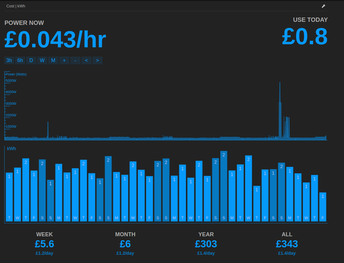

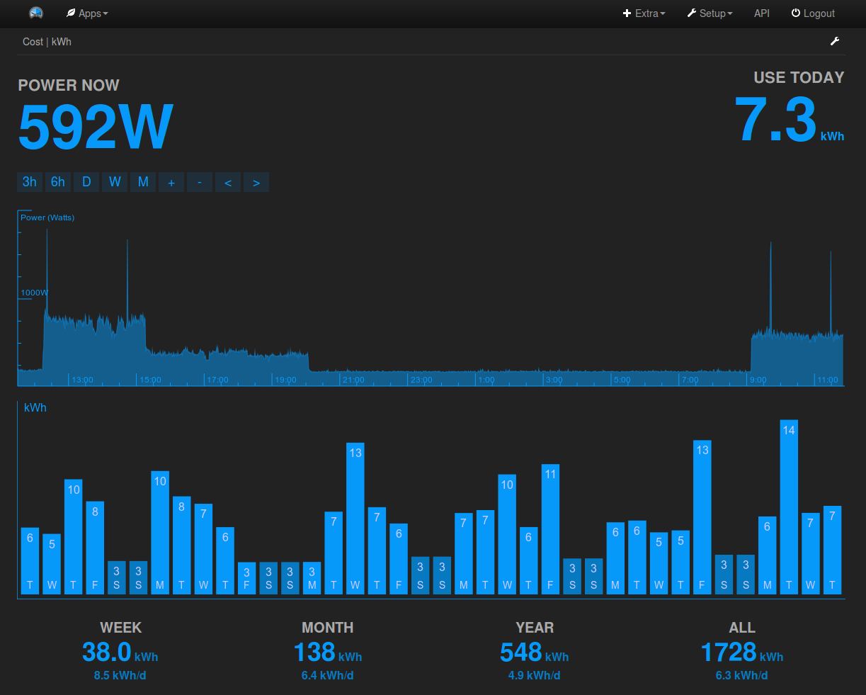

The main view shows a moving window power view of site-consumption in the top half and historic daily energy consumption in kWh in the bottom half.
Energy View
Cost View
