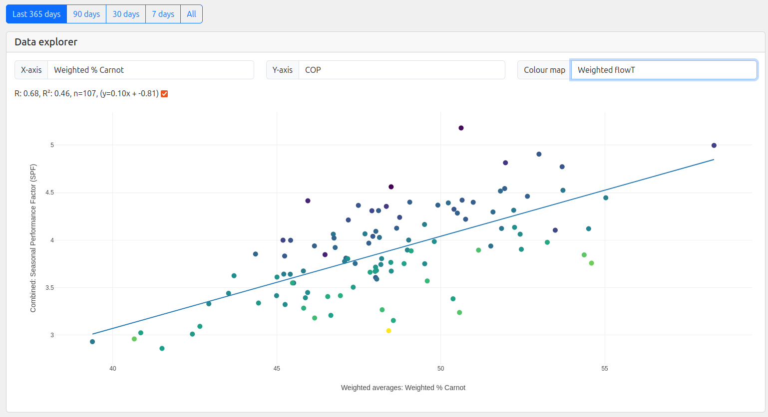

Another strong but less straightforward correlation with performance is the practical efficiency factor, also known as the percentage of the ideal Carnot COP.
This factor could be seen as a measure for the remaining variation in performance once we control for flow and outside temperature.
The carnot COP equation states that the ideal performance of a heat pump is governed solely by the condensing and the evaporating temperature.
Carnot_COP = (T_condensing + 273) / ((T_condensing+273) – (T_evaporating + 273))
In practice, real world heat pumps do not achieve this ideal efficiency and so we have to multiply the ideal efficiency with a Practical efficiency factor. This is usually suggested to be around 0.5 or 50%.
Practical_COP = Practical efficiency factor x Carnot_COP
The following chart shows the weighted by heat output % of ideal carnot COP for each system on HeatpumpMonitor.org compared to it’s seasonal performance factor (SPF). The interesting result here is both the relatively high correlation factor and the wide range of results. Most systems sit between 45% and 55%, this might seem like a small range but the effect is significant.
Chart: % of ideal carnot COP vs Performance [Open Chart].

As we can see, a system operating at 55% of the ideal Carnot COP will achieve significantly better performance at the same system temperatures than one operating at 45% of the ideal Carnot COP.
