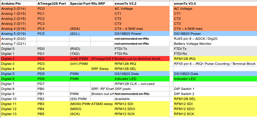

Port Map
Note: The FTDI connector Tx and Rx pins are reversed on the PCB legend and on the Schematic. Data is received by the emonTx on the Tx pin and transmitted by the emonTx on the Rx pin.

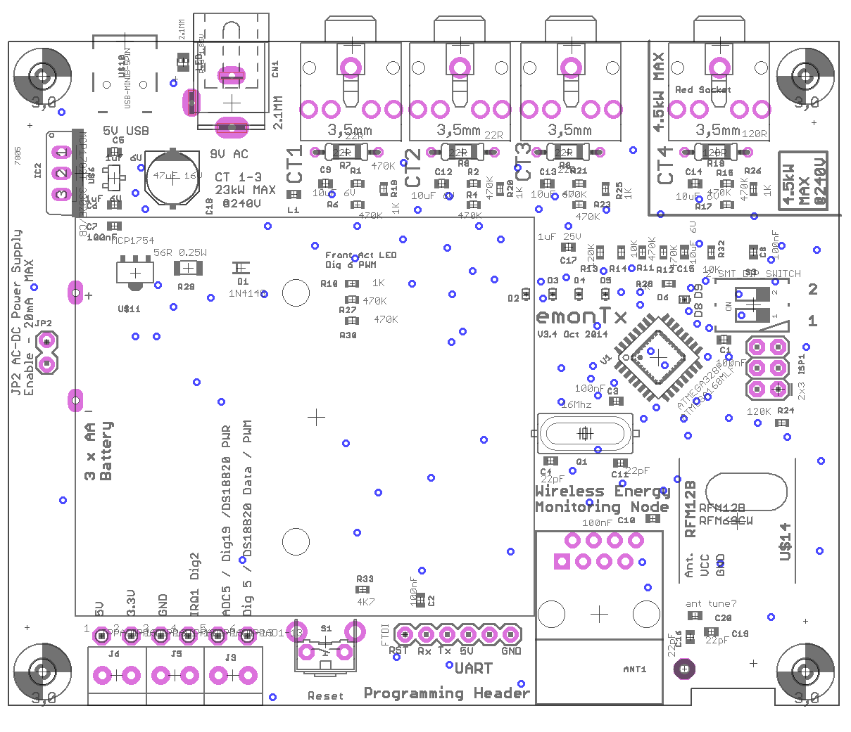

Schematic and Board files
Proudly open source, the hardware designs are released under the Creative Commons Attribution-ShareAlike 3.0 Unported License:
emonTx Schematic and Board files:
https://github.com/openenergymonitor/emontx3/tree/master/hardware
