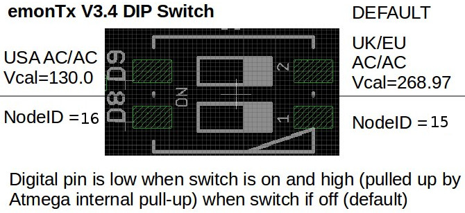

DIP Switch
The on board DIP switch can be used as a convenient way to change both the node ID and the voltage calibration of the emonTx3.
Multiple emonTx unit’s can operate on a single network posting to a single emonBase web-connected base station, each emonTx on the same network group must have an unique node ID. If more than two emonTx’s are required on the same network then further nodeID values can be set via RF node ID serial config.
The following image shows the DIP switch configuration looking at the emonTx with the CT sensor inputs at the top of the board.
Move the top switch D9 to the left to select USA ACAC Voltage calibration.
Move the bottom switch D8 to the left to select RF node ID 16 rather than 15.
