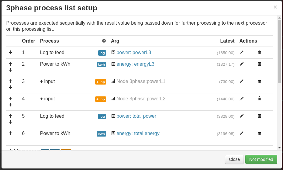

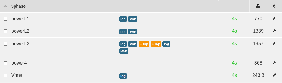

2. Emoncms Input processing
Setup the input processing as follows,
Use the + Input input process to add the phase power inputs together to create a feed for the total power e.g
