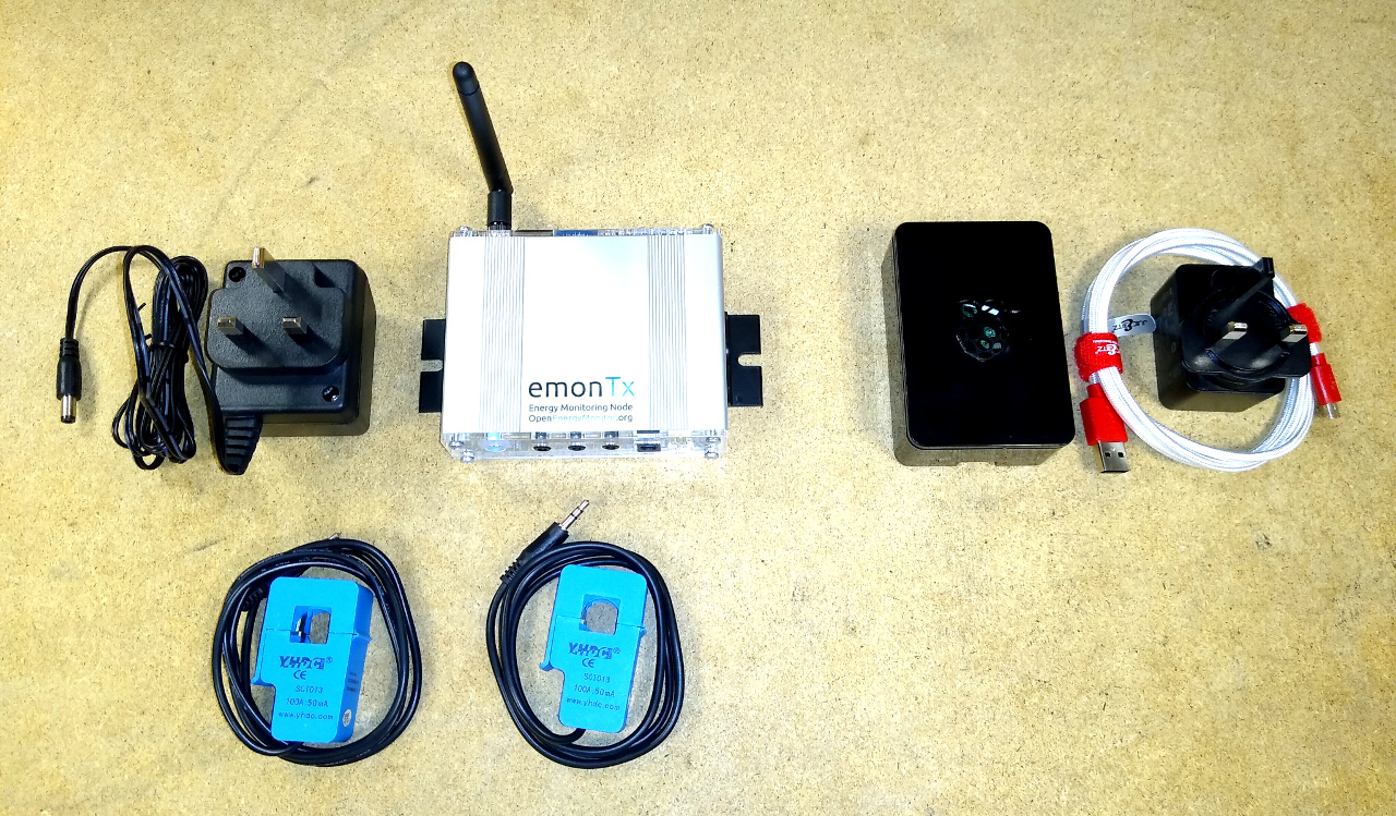

A typical emonTx & emonBase system consists of:
1-4x 100A CT sensors
1x emonBase (RaspberryPi + RFM69Pi adapter board + Enclosure + emonSD card)
1x USB Power supply and micro-USB cable

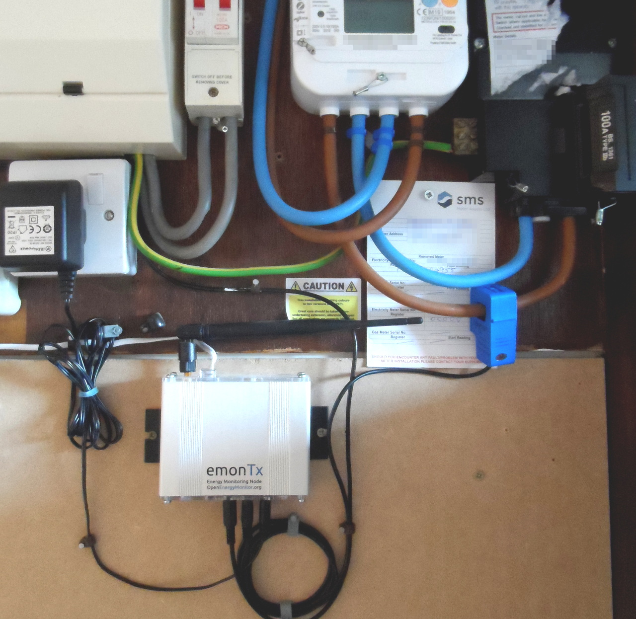

Example emonTx sensor node installation
In this example installation the total house electricity consumption is measured using the CT sensor attached to the brown cable (main feed to the house). Another CT sensor is located inside the main consumer unit, in this case monitoring the electricity supply to a heat pump.
A dedicated socket was installed for the AC-AC Voltage sensor and combined power supply.
A RFM69 433 MHz antennae is attached and also a DS18B20 temperature sensor connected to the emonTx RJ45 Temperature and Pulse input socket.
The emonTx transmits real power, cumulative watt-hours, mains voltage and temperature measurements every 10s over RFM69 radio to an emonBase connected via Ethernet to the internet router in the living room.

Plug CT sensors into the emonTx first and then clip around either the Line or Neutral cable of the AC circuits that you wish to measure. If the power reading is negative, reverse the CT sensor orientation. Please read the CT installation guide before installing.
Attach temperature sensors or/and pulse sensor as required. See guides: + Add Temperature Nodes and + Add Optical Pulse Sensor.
Plug in and connect the AC-AC adapter to provide voltage measurement and power. This may require installation of a new outlet or extending an existing one.

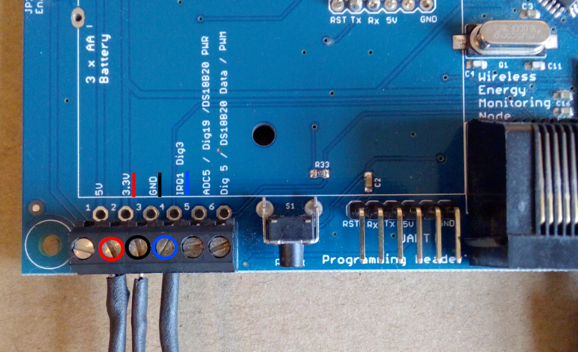

A DS18B20 digital temperature sensor can easily be connected to the emonTx V3 by connecting the sensor to the emonTx V3 screw terminal block or RJ45 connector.
The continuous Monitoring firmware (default) supports 3x temperature sensors. The Discrete Sampling firmware (used for battery operation) supports up to 6x temperature sensors.

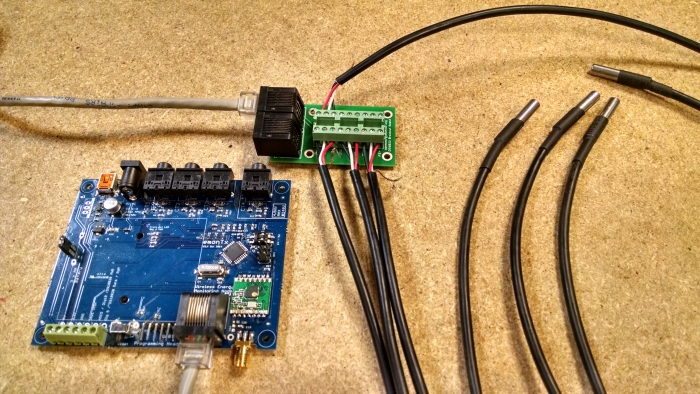

A DS18B20 sensor can be connected directly to the RJ45 socket, or an RJ45 to terminal block breakout can be used to connect multiple sensors:
Note: The RJ45 socket does not support power supply switching via Dig19 (ADC5).
Shop: emonPi / emonTx RJ45 to Terminal Block Breakout for DS18B20
Additional RJ45 breakouts are available from Sheep Walk Electronics

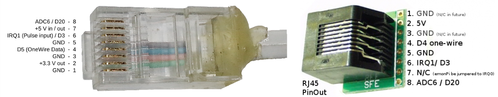

RJ45 Pinout
The RJ45 implements a standard pinout used by other manufacturers of DS18B20 temperate sensing hardware such as Sheepwalk Electronics.
Note: The RJ45 socket does not support power supply switching via Dig19 (ADC5) as described above.

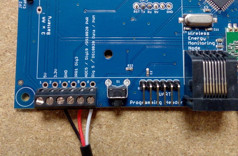

Terminal Block Connection
To connect an external DS18B20 to the emonTx V3 screw terminal block, connect the black wire to GND, red to ‘ADC5 / Dig19 / DS18B20 PWR’ and white to ‘Dig 5 / DS18B20 Data / PWM’:
EmonTx Power Supply
When using multiple temperature sensors and or an optical pulse sensor with the emonTx it is recommended to power the emonTx via a 5V USB rather than AC-AC adapter due to increased power requirement. An AC-AC adapter can still be used to provide an AC voltage reference.
EmonTx Low power battery mode
In order to save power when running on batteries, the emonTx V3 supports switching off of the DS18B20 in-between readings and performing the temperature conversion while the ATmega328 is sleeping. To do this, power (3.3 V) is supplied to the DS18B20’s power pin from Dig19 (ADC5), this digital pin is switched off between readings. (This facility is available only if the temperature sensors are connected via the terminal block.) The data connection from the DS18B20 is connected to Dig5, this I/O pin has a 4K7 pull-up resistor on-board as required by the DS18B20.

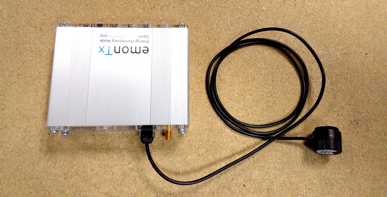

The emonTx supports the OpenEnergyMonitor optical pulse counter. The optical pulse counter plugs into the RJ45 socket on the EmonTx.
