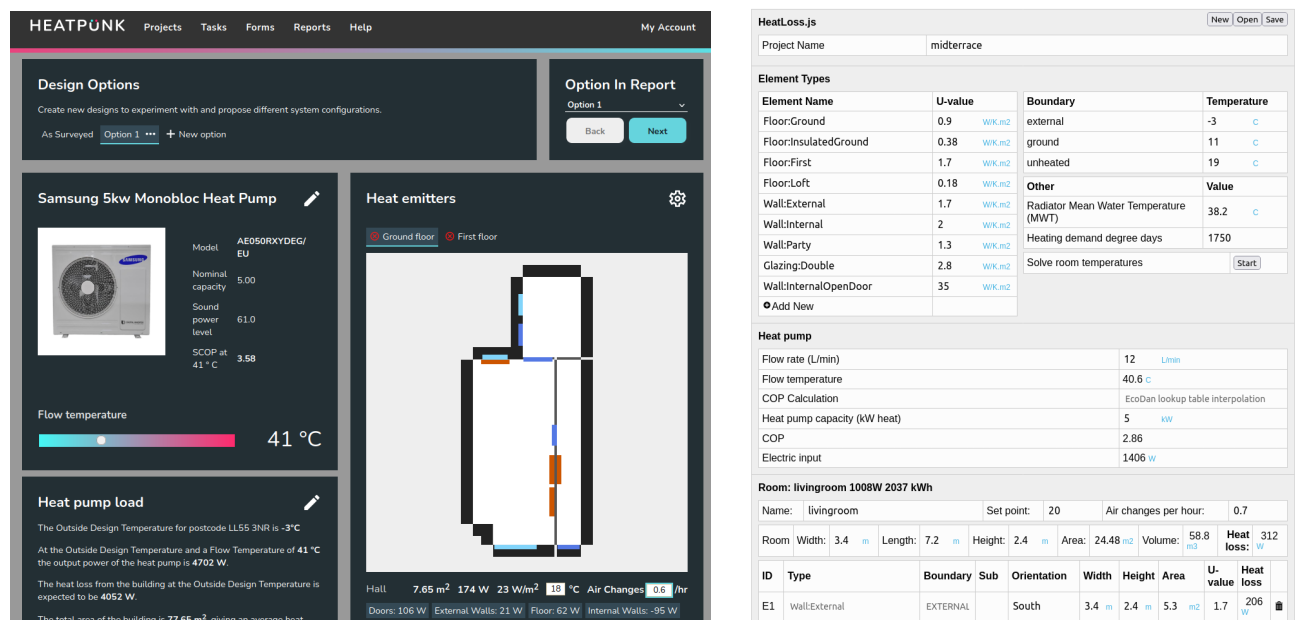

There are a large number of good heat loss calculation tools. One of the easiest free tools is https://heatpunk.co.uk by Midsummer. We have also developed our own open source tool called HeatLoss.js and while it has some advanced features, it is certainly harder to enter in all the building dimensions.
Left: HeatPunk by Midsummer. Right: HeatLoss.js by OpenEnergyMonitor.

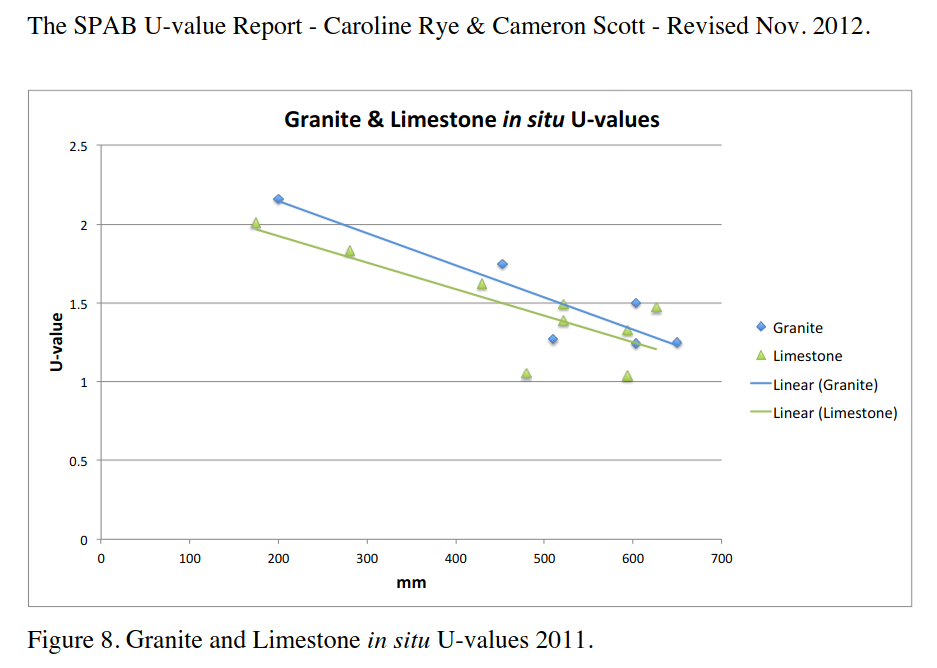

Tools typically start by defining a list of the materials and associated U-values for the different building elements: external walls, internal walls, ground floor, intermediate floors, loft/roof, windows, and doors. MCS provides a guidance document on U-values, which offers a useful starting point; see: Guidance on U-values from Domestic Heating Design Guide.
It is worthwhile to search for the latest research on U-values, as the design guide is not always realistic or up-to-date. A good example is the research by SPAB on real-world U-values of solid stone walls, which suggests typical U-values closer to 1.5 W/K.m² for 500mm thick walls.
../_images/spab_solid_stone.png

Measure all the room, window, and door dimensions. With Heatpunk, you can draw the house using the 2D design tool on the fly. While it is good to be as accurate as possible, it does not have to be perfect, as the errors introduced by other assumptions are much greater than those likely to be caused by minor inaccuracies in the plan. For that matter, the calculation method itself and the convention of using internal dimensions without fully accounting for internal wall widths and corner details will introduce more significant sources of error than being off by a few centimeters. It can make sense to simplify and rationalize the plan so that dimensions line up between floors to make entry easier.

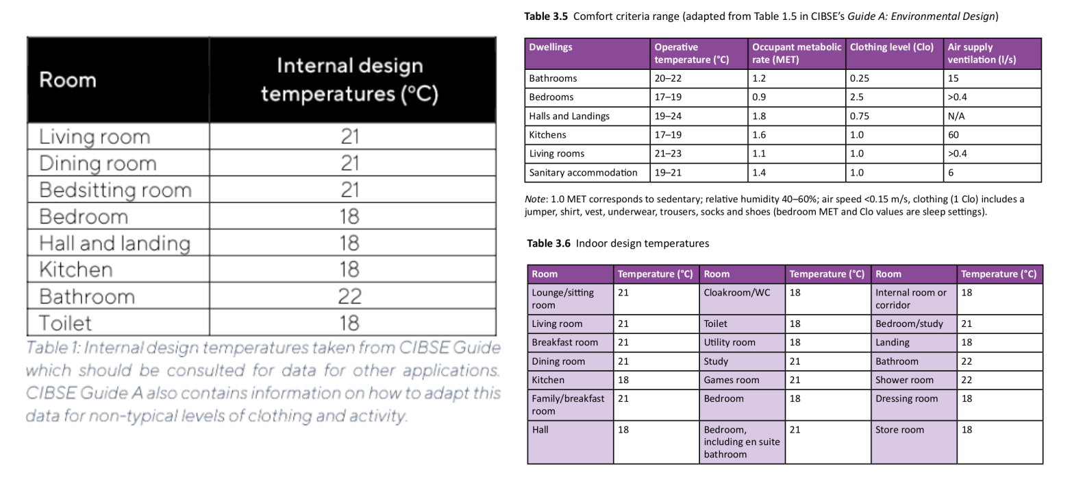

3. Select room temperatures
For non-MCS installations, you can choose the internal temperatures to match your comfort preferences. For an MCS installation, the MIS_3005 MCS design standard states that the system “should” use internal temperatures not less than those specified in Table 1. The term “should” indicates a prescribed “requirement or procedure that is intended to be complied with unless reasonable justification can be given.” This suggests there could be some flexibility for selecting lower temperatures (e.g., in the bathroom), but what might pass for “reasonable justification” is not described in any further detail in the document.
Here are the relevant tables from the MCS MIS_3005 standard document and the CIBSE Domestic Heating Guide for reference:
The average internal temperature resulting from the range of standard MCS room temperatures in a typical domestic property is less stringent than assuming a uniform internal design temperature of 20°C throughout (e.g., Passivhaus requirement). In our mid-terrace house example, setting 21°C in the living room, 22°C in the bathroom, and 18°C everywhere else results in an average internal temperature of 19.3°C.
The most challenging room temperature target for system design is often the bathroom temperature target of 22°C. The bathroom in our mid-terrace example has an assessed heat loss that is relatively high due to its two external walls, and the space for a large radiator was limited, leading to an undersized bathroom radiator at the design flow temperature that works for the rest of the house.
Note from author: The temperature of the bathroom worked out just fine in reality, typically around 19-20°C when in use, which feels comfortable enough. The bathroom gains some heat from the hot water cylinder and heat pump pipework, which are not usually included in simple heat loss calculations. It is also partly heated by warm air moving up from an over-sized radiator in the hall.

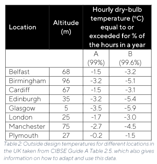

5. Select a Suitable Design Outside Temperature
The MCS design standard states that the heat loss calculation “should be performed .. using external temperatures specified in Table 2 colum A or B, according to the MCS Contractor’s assessment of the building location. If column B is selected no uplift factor for intermittent heating is required.”. The term should again means that alternative values are allowed provided reasonable justification can be given.
We can see from this table that the suggested design temperature varies significantly across the country:
../_images/mcs_design_temperatures.png
The HeatPunk tool suggests a design temperature of -3.6°C for our North Wales, mid-terrace example but there is a good case for a higher design temperature in reality. Analysing measured outside temperature data over 5 years suggests a design temperature of -1.1°C (99.6%) and 0.0°C (99%). Met office data for the local village over a year suggests -1.4°C (99.6%) and -0.1°C (99%). There are further results and example code for calculation documented here.

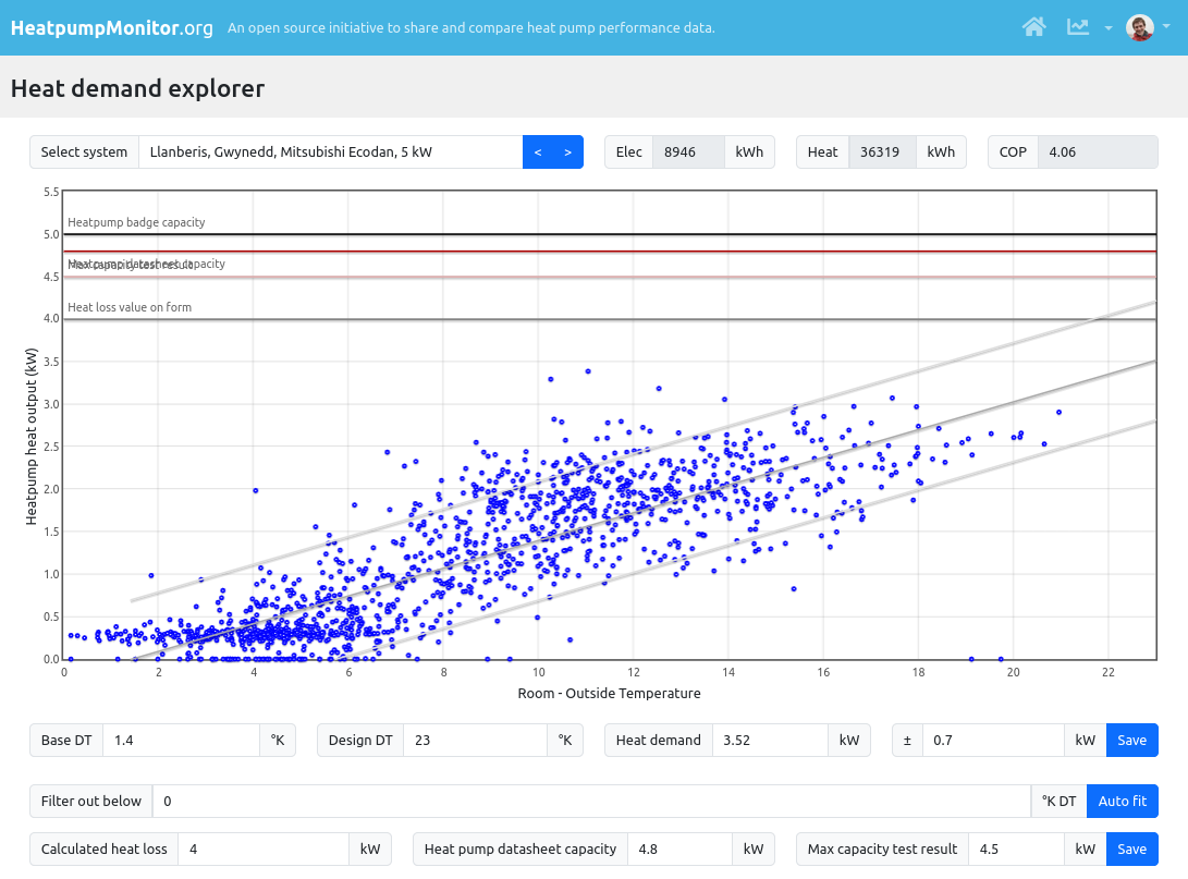

Comparison with Monitored Heat Demand
Our example house, System 2 on HeatpumpMonitor.org, has now had a heat pump running with detailed monitoring for five and a half years, enabling comparison with the actual maximum heat demand that the heat pump has provided.
See HeatpumpMonitor.org heat demand tool here: https://heatpumpmonitor.org/heatloss?id=2
Results:
  • The maximum heat demand recorded was 3.4 kW over 24 hours on a relatively warm 7.5°C day at the start of January 2024. As is often the case, this high demand was due to reheating the house after being away.
  • The highest cold weather heat demand was recorded on the 1st of December 2023, at 2.9 kW over 24 hours with an outside temperature of -1°C and an average living room temperature of 20°C.
  • A couple of days around 0°C to +1°C showed heat demand slightly higher, at 3 to 3.1 kW.
  • The coldest day recorded was -1.6°C, which had a surprisingly low heat demand of 2.5 kW. Other cold days around -1.4°C had a heat demand of 2.6 kW.
  • The central line crosses 3.3 kW at a DT of 21.4K, corresponding to a design temperature of -1.4°C.
  • There is a wide range of values, suggesting that it could be feasible to see heat requirements ranging from ±0.6 kW, or from 2.8 kW up to 4.0 kW.
  • Maximum output testing of the 5 kW Ecodan (older R410a model) during below-freezing conditions suggests it should be able to maintain a net heat output of 4.2-4.5 kW during periods of heavy defrosting: 5kW R410a Ecodan PUHZ-W50VHA2(-BS) maximum output testing.
