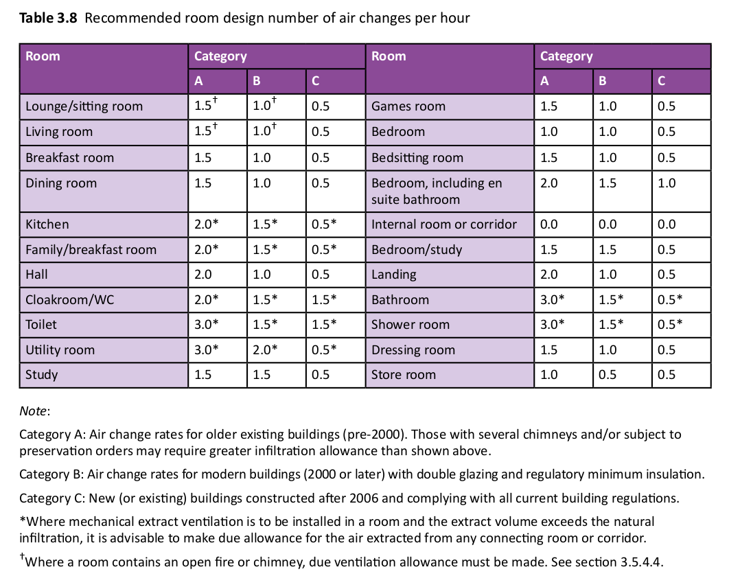

Default values from the CIBSE Domestic Heating Design Guide
Most standard heat loss calculators do not provide a method for deriving room air change rate values from other inputs such as a blower door test or building fabric details as is common in whole house calculators such as SAP 2012. Typically, there is a selection for the age of the property, which is then used to apply default air change rate values from the CIBSE Domestic Heating Design Guide.
cibse
These defaults, especially the values for category A (pre-2000 older buildings), lead to a significant overestimation of ventilation heat loss in most houses. Considering that 93% of the UK housing stock was built before 2000 (Wikipedia: Housing in the United Kingdom), this poses a substantial challenge for accurate heat loss calculation.
These defaults can usually be overridden, and many heat pump installers are applying more realistic air change rate values based on experience and engineering judgment. However, the lack of clear evidence-based guidance from CIBSE in the design guide remains an issue, as not all installers are comfortable deviating from these default values.

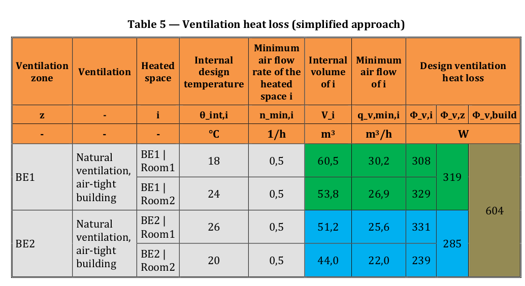

Simplified calculation method
Note: The simplified method is only applicable to very airtight buildings. The standard provides an example of an n₅₀ value of less than 3 ACH, which is extremely low. Arguably, any building with such a low ventilation rate would also require a mechanical ventilation system to maintain healthy indoor air quality—at which point, the full calculation method becomes necessary. This raises the question: are there any practical buildings where the simplified method can actually be used?
The main equations for the simplified method are given in 6.3.3.2.2. Notice how qv,min,i is multiplied by fi-z in equation 13 but not in equation 14.

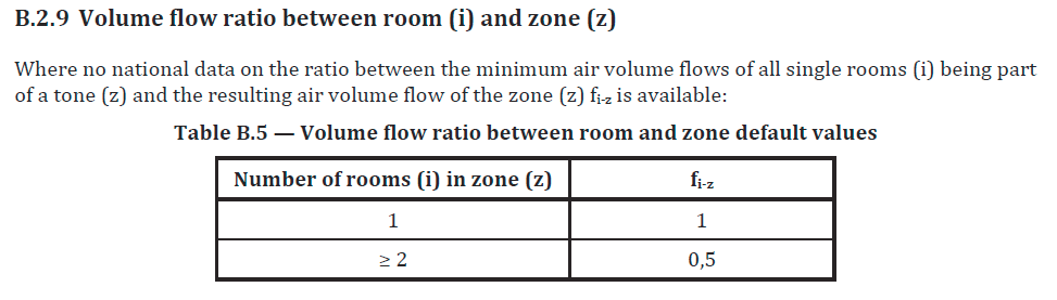

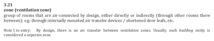

Default values for factor fi-z is given in table B.2.9 and appears to be 0.5 in all cases where there is more than 1 room in the zone:
A zone is defined as a group of rooms that are air-connected by design. The shortened door leaf sounds like the undercut required for part F (“From part F: 3.27 Internal doors should allow air to move within the dwelling by providing a free area equivalent to a 10mm undercut in a 760mm wide door”).
An example of this simplified calculation and fi-z factor in action can be found in the supplementary EN12831-2. Notice again how individual room heat losses are halved when summed as a zone.

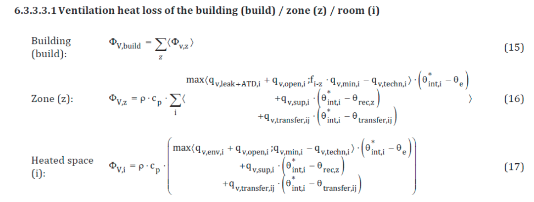

The final equations for the standard calculation method are given in section 6.3.3.3.1, equations 15, 16 and 17. Notice again the factor fi-z. The implementation is slightly different here, when calculating ventilation heat loss for a room in equation 17, there is a selection for qv,env,i, this is replaced with qv,leak+ATD,i in equation 16.
  • qv,env,i is the external air volume flow into the room through the building envelope.
  • qv,leak+ATD,i is the external air volume flow into the room through leakages and ATDs (air terminal devices).
Reading the full standard is required to understand the detail here, this description is not meant to be a substitute. Rather, it aims to provide a set of pointers on what to watch for.
One of the things to notice is that the calculation for qv,env,i includes an orientation factor fdir that doubles the infiltration air volume rate. Skipping qv,env,i and using qv,leak+ATD,i directly later in naturally ventilated zones halves the ventilation heat loss with the same effect as the fi-z factor.
The exact reasons for these factors are not clearly articulated in the standard. A logical explanation could be that under wind load, rooms facing the wind might have cold air pushed into them. This air would then move, pre-warmed, to adjoining rooms on the other side of the building, resulting in higher heating requirements for wind-facing rooms than those on the leeward side. The latter halving likely reflects an averaging out of these effects across the entire building.

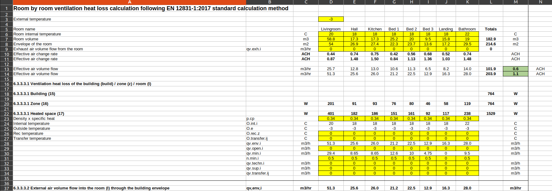

Example spreadsheet calculation using the EN12831-1:2017 standard method
The following spreadsheet example implement the standard method as closely as possible. Please check these calculations and use with caution.
Download: EN12831_2017_ventilation_calculation_v2.ods (Updated May 2025).
Online javascript tool: EN12831 Ventilation Calculator (New May 2025).
The example given is of Trystan Lea’s mid-terrace solid stone house. It uses the measured blower door test air permeability result of 8.4 m3/h/m2 (corrected up to 15.2 m3/h/m2 as blower door test noted envelope area included party walls). Assuming natural ventilation + intermittent extraction it suggest a whole house air change rate of 0.6 ACH. This whole house air change rate agrees well with CO2 monitoring derived results and coincidentally the part F minimum.

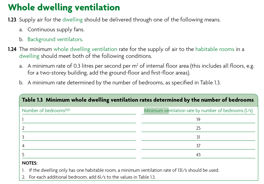

Part F of the building regulations addresses ventilation and improving air quality inside buildings. Section 1.24 specifies minimum whole dwelling ventilation rates. These values are coincidentally quite close to measured ventilation rates in pre-2000 buildings with natural ventilation and/or intermittent extraction.
Example calculation
A two story 3 bed house with a floor area of 77m2 and ceiling heights of 2.4m has an internal volume of 185 m3.
a) The minimum of 0.3 litres per second per m2 of internal floor area results in this case to:
0.3 L/s x 77 m2 = 23.1 L/s
23 L/s × 3600s/hr × 0.001  m3/L = 83.2 m3/hr
83.2 m3/hr / 185 m3 = 0.45 air changes per hour (ACH)
b) The minimum rate determined by the number of bedrooms is higher at 31 L/s:
31 L/s × 3600s/hr × 0.001  m3/L = 111.6 m3/hr
111.6 m3/hr / 185 m3 = 0.6 air changes per hour (ACH)
This gives us a useful guide for minimum ventilation rates from an air quality perspective which is an important factor for whole house system design.

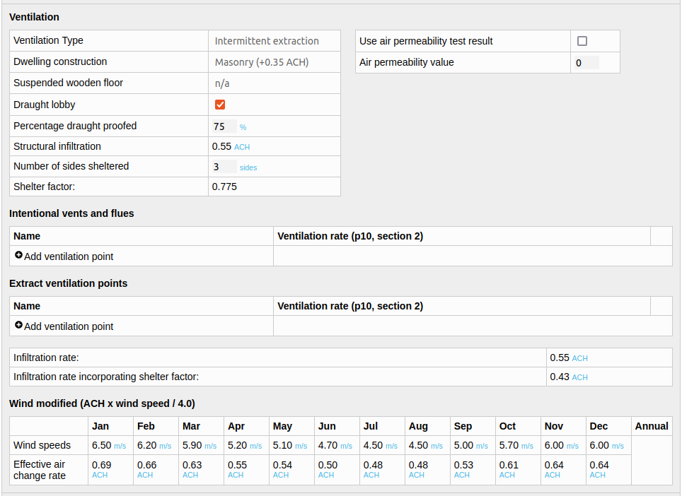

The infiltration and ventilation calculation in SAP 2012 provides a method to estimate air change rates using either basic details about the dwelling or results from a blower door air permeability test. Over ten years ago, we developed a tool in collaboration with CarbonCoop, based on the SAP model, named MyHomeEnergyPlanner. Below is a screenshot of the ventilation section from our more recent minimal implementation, SAPjs:
Try the tool here: https://openenergymonitor.org/sapjs/
SAPjs source code: https://github.com/TrystanLea/SAPjs/
OpenBEM underlying model code: https://github.com/TrystanLea/openBem

A 2 story house, masonry, solid floor, with draught lobby, 75% draught proofed:
0.1 (floors) + 0.35 (construction) + 0.25 - (0.2 x 0.75) = 0.55 ACH
Next it applies a shelter factor (assuming 3 sides sheltered in this example):
shelter_factor = 1 - (0.075 x number of sides sheltered);
infiltration after shelter factor = infiltration x shelter_factor
shelter_factor = 1 - (0.075 x 3 sides) = 0.775
infiltration after shelter factor = 0.55 ACH x 0.775 = 0.43 ACH
Then the wind factor (example 6.5 m/s):
windfactor = windspeed / 4
infiltration = infiltration x windfactor
windfactor = 6.5 m/s / 4 = 1.625
infiltration after wind factor = 0.43 ACH x 1.625 = 0.69 ACH

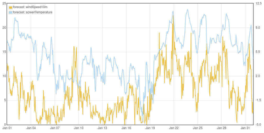

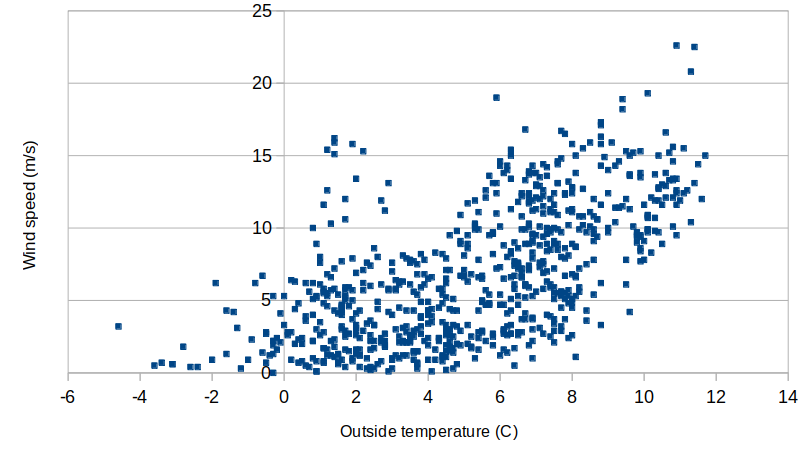

Wind speed correction
Here’s the wind speed and temperature for the example house in January, there is a rough correlation between wind speed and outside temperature, milder weather generally brings higher winds, convenient for heat loss (but less convenient for wind generation when you need it).
Correlation (each datapoint is an hour):
The simple SAP wind speed factor appears to yield reasonable results. During the storm from January 20th to 24th, when wind speeds were approximately 12.5 m/s, this results in a multiplication factor of 3.1x (12.5/4). Applying this to the base blower door rate of 0.403 ACH results in 1.26 ACH. CO2 monitoring during this period measured an average of 1.2 ACH, a close agreement!

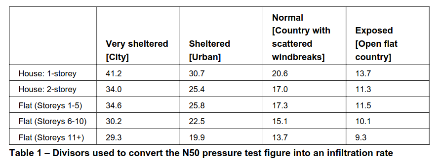

Home Energy Model
The SAP replacement (Home Energy Model) has a very similar calculation. One of the main differences is the divisor table, which gives different factors to divide the n50 value, other than divide by 20.
The shelter factor equation and the wind factor equations as used in SAP 2012 are the same but the result from the mid terrace example house would go up slightly if the Normal (Country with scattered wind breaks) divisor is used to around 0.74 ACH.
