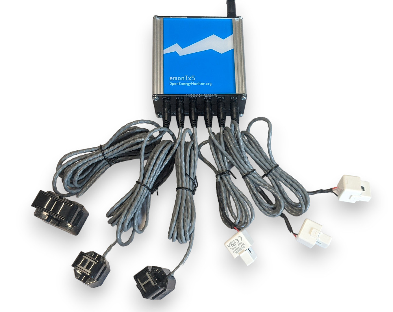

The emonTx5 builds directly on recent emonTx4 and emonPi2 development and replaces the emonTx4 as our latest energy monitoring transmitter node. The emonTx5 transmits data via an inbuilt 433MHz radio to an emonPi or emonBase. It is useful for expanding an emonPi2 monitoring setup where more CT inputs are required either in the same location or in a different part of the building.
Like the emonTx4 and emonPi2, the emonTx5 uses the same focus on higher accuracy, more CT channels, precision voltage sensing and the new microcontroller core. When combined with the emonVS voltage sensor, a selection of CT sensors and an emonPi2 or emonBase base station, it provides an end-to-end electricity monitoring solution perfect for monitoring home consumption, solar generation, EV charging, heat pumps, battery storage among other applications.

6x clip-on CT current sensor inputs (suitable for a range of 333mV voltage output CT sensors).
emonVs precision voltage sensor input.
Full Real/Active power measurement & continuous sampling.
Cumulative energy persisted on reboot.
Both single and 3 phase support.
3 pluggable terminal block inputs for DS18B20 temperature sensing*, pulse counting or an analogue voltage input.
On-board USB to UART converter for easier programming and serial output.
433 MHz radio transceiver
Wall-mount aluminium enclosure
