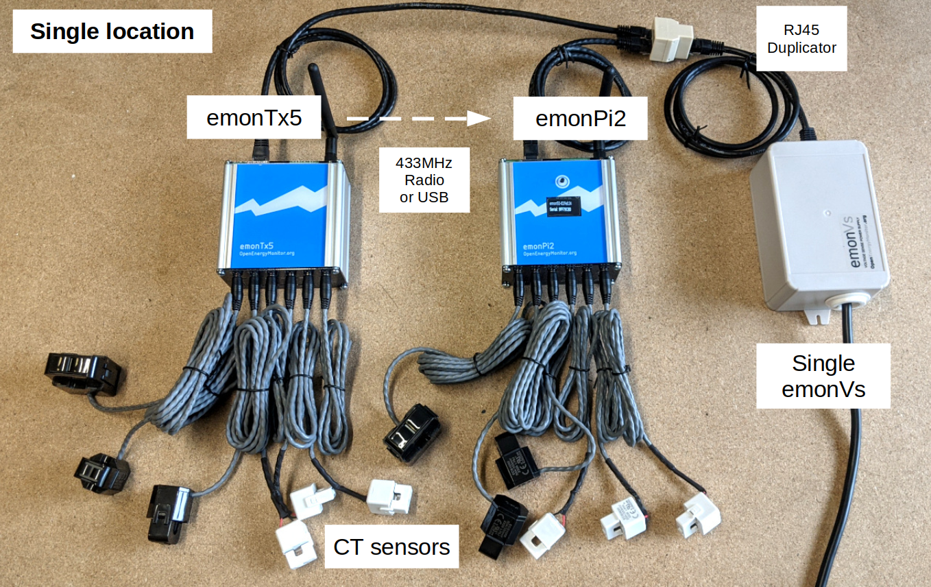

2. EmonTx5 and emonPi2 in the same location with shared emonVs
The emonPi2 with a Pi Zero 2W inside can be extended from 6 CTs to 12 CTs with an expansion board that fits inside the emonPi2 unit itself. You can have an emonTx5 close by to add another 6 CT channels, or 12 when it too has the expansion board fitted, to take the total to 24 CT channels.
When it is desirable to have a full Raspberry Pi 4B with USB ports and Ethernet in the emonPi2, this limits the number of CTs on the emonPi2 to 6, reducing the possible total CT channels to 18.
The emonVs can be shared between the emonPi2 and the emonTx5 using a RJ45 duplicator (available in the shop here).

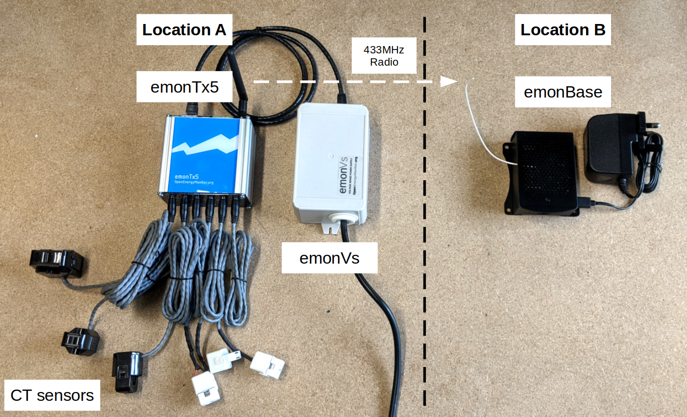

3. emonTx5 and an emonBase base-station
Another common arrangement is to use the emonTx5 with a seperate emonBase base-station. The emonBase can be located next to the internet router for a hard wired Ethernet connection.
Data is transmiteed from the emonTx5 (left) to the emonBase (right) via 433 MHz radio (which has a practical range similar to WiFi, a 433 MHz repeater can be used if required, available here).
