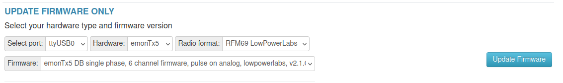

The easiest way of updating the emonTx5 firmware is to connect it to an emonBase with a USB cable and then use the firmware upload tool available at Setup > Admin > Update > Firmware.
Warning
System update may be required: If you don not see the latest firmware version as listed above in the firmware list a full system update is required first.
Refresh the update page after connecting the USB cable. You should now see port ttyUSB0 appear in the ‘Select port` list.
Double check the serial port, this is likely to be ‘ttyUSB0’ when plugged in via USB device connected. Select ‘emonTx5’ from hardware.
The standard radio format is ‘LowPowerLabs’, if you wish to use the emonTx5 with an original emonPi (v1) system running JeeLib classic radio format you can select the JeeLib classic radio format here.

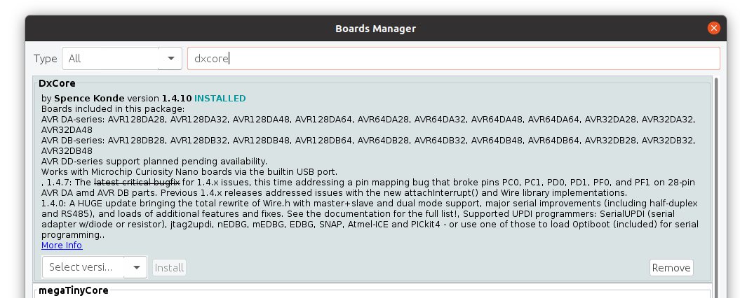

Once you have the IDE installed, you then need to install Spence Konde’s DxCore. This can be done by first pasting the following board manager URL in Arduino IDE > File > Preferences:
http://drazzy.com/package_drazzy.com_index.json
Then navigating to: Tools > Boards > Boards Manager, Select “DxCore by Spence Konde” and click Install.
For more information on DxCore installation see: https://github.com/SpenceKonde/DxCore/blob/master/Installation.md.

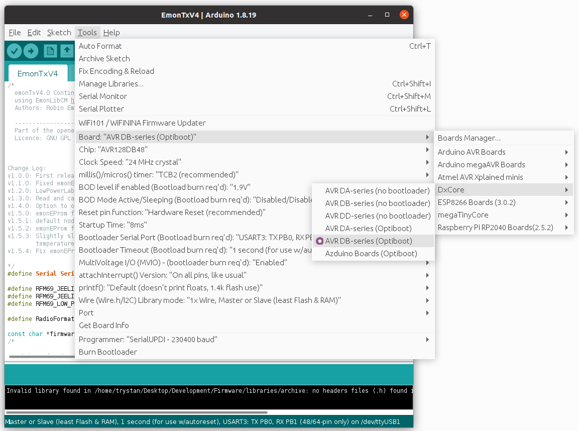

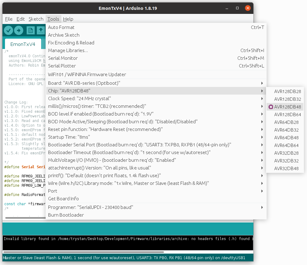

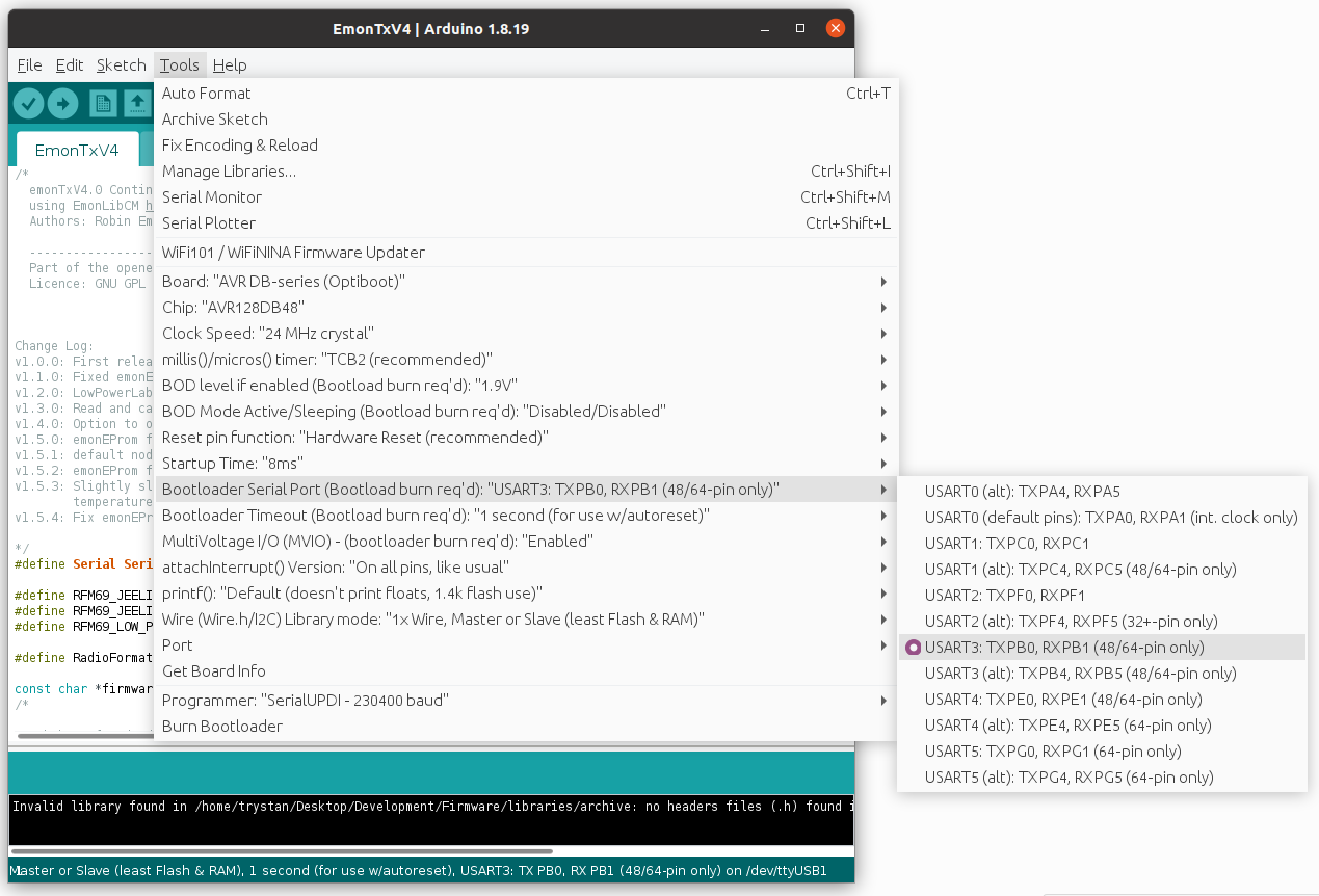

Compilation settings:
With DxCore and the libraries installed the firmware should then compile.
Under Tools, select the following configuration options:
Select Board “AVR DB-series (Optiboot)”
Select Chip: AVR128DB48
Clock Speed: 24 MHz Crystal
Bootloader serial port: UART3: TXPB0, RXPB1
