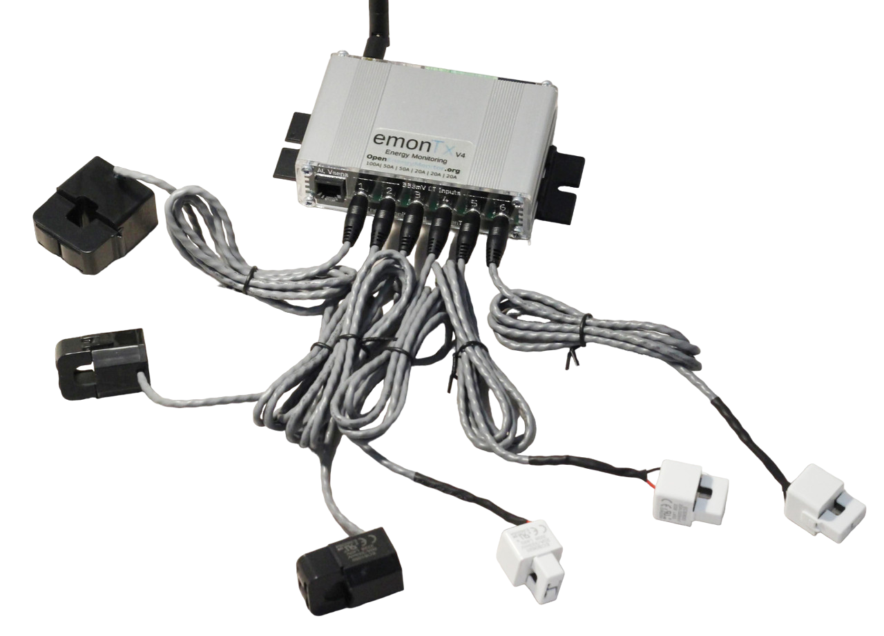

The emonTx4 is part of the AVR-DB based hardware family which now includes the emonPi2 and soon to be released emonTx5. While no longer available in the shop the emonTx4 is still actively supported as part of the latest generation of hardware.
These units provide a redesigned focus on higher accuracy, more CT channels and precision voltage sensing. When combined with the emonVs voltage sensor, the emonBase base-station and a selection of CT sensors, the emonTx4 provides an end-to-end electricity monitoring solution perfect for monitoring home consumption, solar generation, EV charging, heat pumps, battery storage or any AC electrical circuit for that matter.
Key features
6x clip-on CT current sensor inputs (suitable for a range of 333mV voltage output CT sensors).
emonVs precision voltage sensor input.
Full Real/Active power measurement & continuous sampling.
Cumulative energy persisted on reboot.
The initial firmware release supports single phase monitoring only.
Support for 3 phase voltage sensing.
3 pluggable terminal block inputs for DS18B20 temperature sensing, pulse counting or an analogue voltage input.
RJ45 socket for pulse counting and DS18B20 temperature sensors.
On-board USB to UART converter for easier programming and serial output.
433 MHz radio transceiver
Extension header pins for use with ESP8266, ESP32, Pi Pico & Pi Zero development board extension modules
Wall-mount aluminium enclosure
