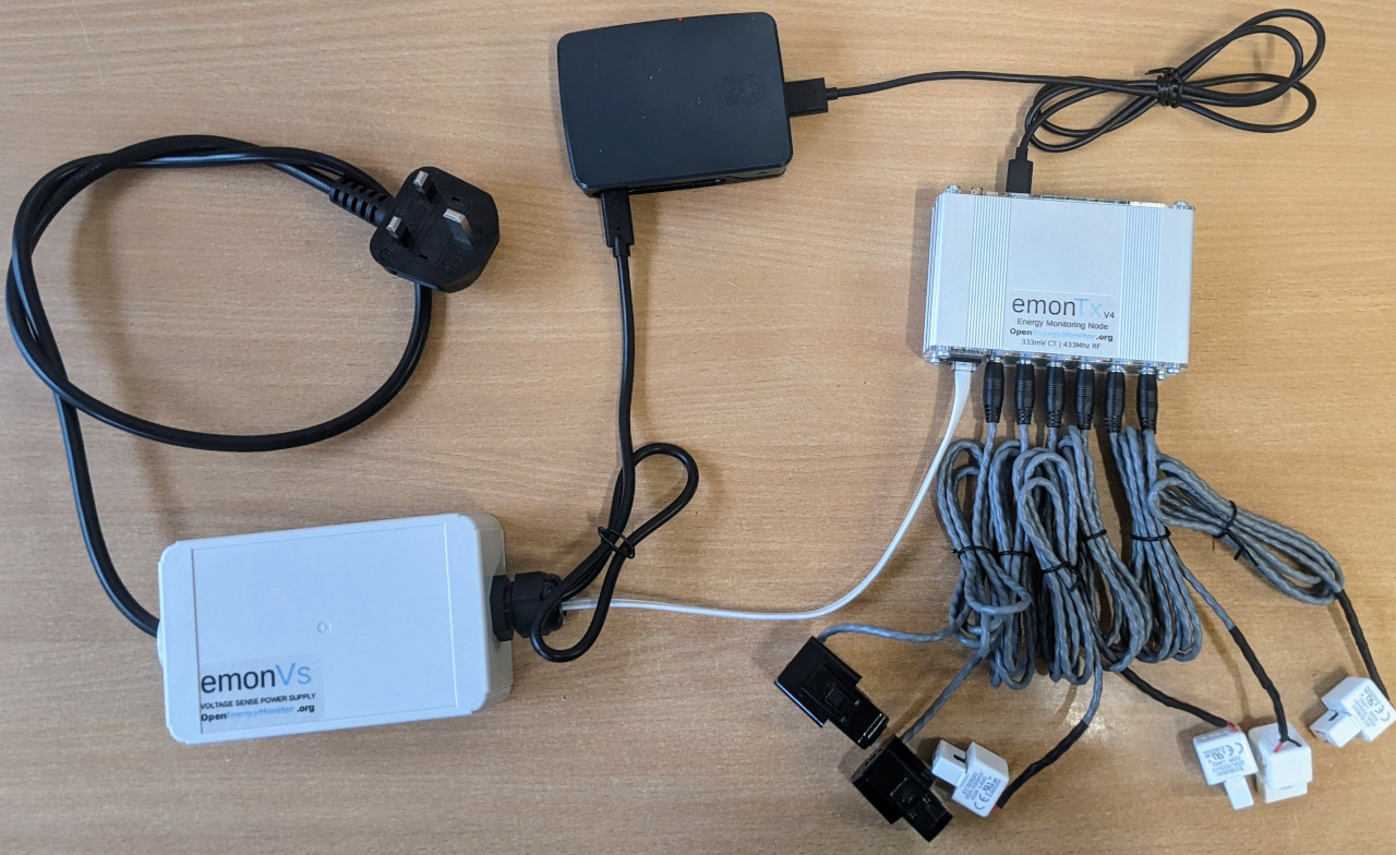

Quick Start
  1. Clip the CT current sensors around Live OR Neutral cable of the AC circuit to be measured (not both), note CT direction K -> L (L: Load), That’s on the Line conductor, the arrow points away from the load on the Neutral.
  2. Plug the CT current sensors into emonTx4 via 3.5mm jack plugs
  3. Plug emonVs RJ11 cable into emonTx4
  4. Plug emonVs USB-C cable into emonBase Raspberry Pi base-station power input connector
  5. Plug emonVs into mains power via a domestic wall socket
  6. (optionally) connect emonBase Raspberry Pi base-station to Ethernet
  7. Switch on mains socket and verify that the red LED on the emonTx4 and the red LED on the Raspberry Pi illuminates.
  8. Continue with step 5. emonBase Setup below.

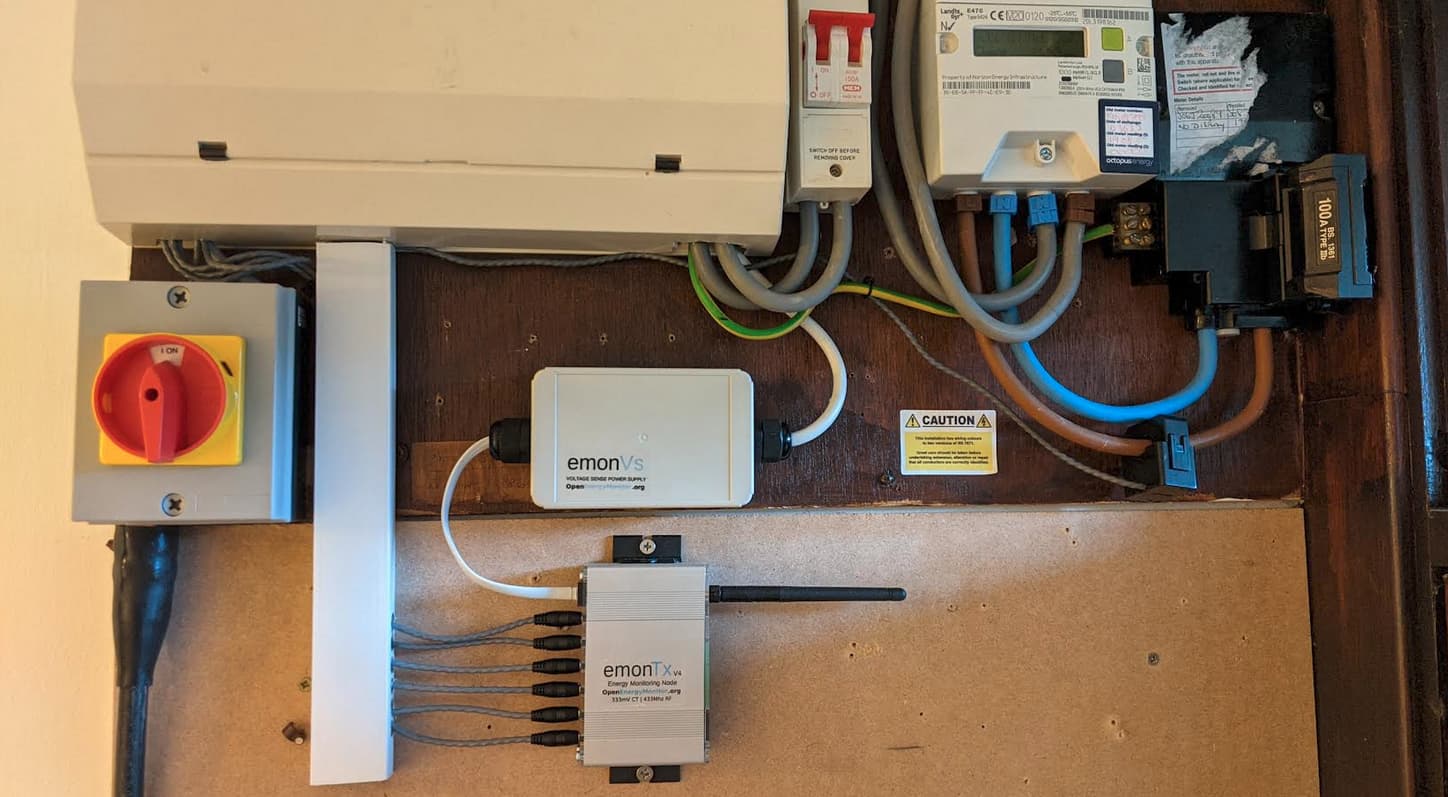

A good place to start is to assess the location where you wish to install the emonTx4, identify the circuits that you wish to monitor using the clip-on CT sensors and decide how you would like to install the emonVs voltage sensor. There are a couple of example installations given below which may provide inspiration.
1. emonVs installation
There are two different ways of installing the emonVs voltage sensor:
Using the mains plug supplied: If you have a convenient socket near-by this will be the easiest and quickest option.
Direct installation: The emonVs can be hardwired by a suitably competent person into a 6A or lower circuit protection device in the fuse board (consumer unit) or a 3A fused spur. The supplied emonVs mains power cable has a cross sectional area of 1.0mm2. This can provide a tidy installation if no socket is available and helps ensure higher monitoring uptime if sockets are at risk of being unplugged for use by other appliances.
The emonVs unit can be wall mounted using the brackets on the enclosure. Start by marking the position of the holes and then, with the emonVs removed, screw in the screw for the bracket below the larger gland first. Slide the emonVs into place before inserting the second screw near the low profile gland used for the power cable.

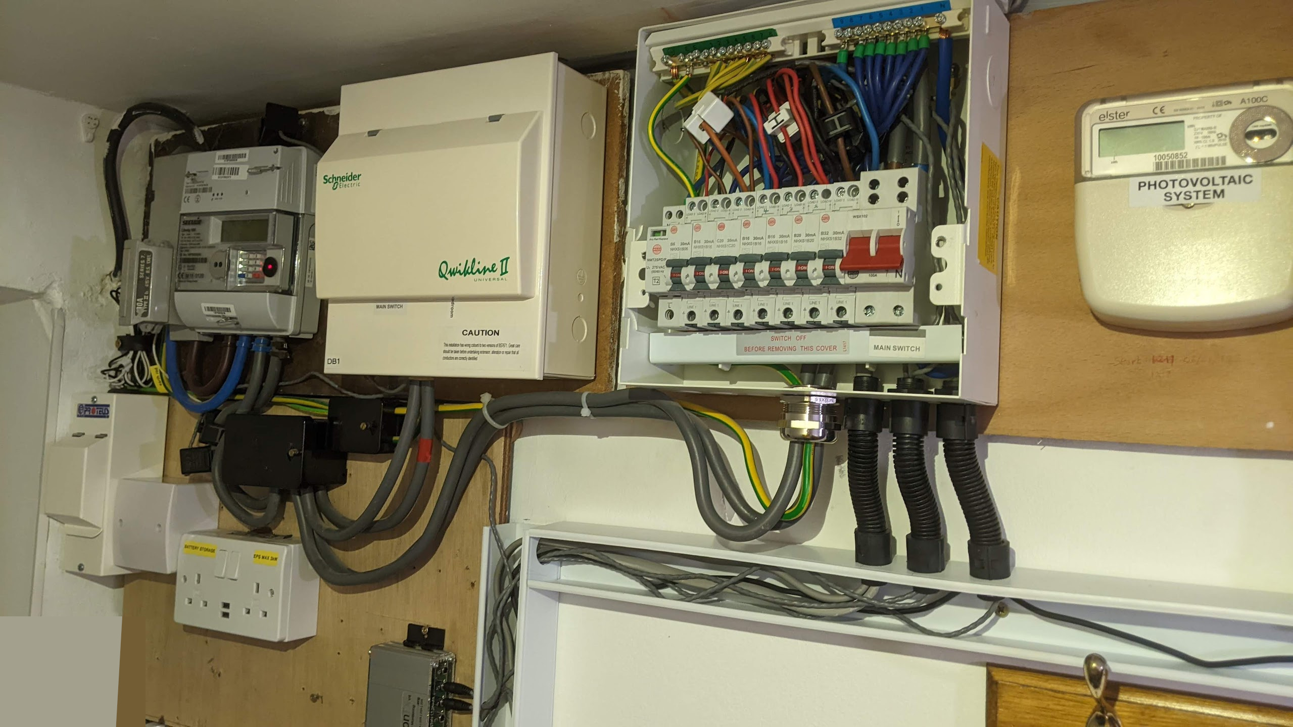

2. CT sensor installation
  • Current transformers (CTs) are sensors that measure alternating current (AC).
  • The emonTx4 supports a wide variety of 333mV voltage output CT sensors. We stock 20A, 50A, 100A & 200A options in the OpenEnergyMonitor shop. The physical size of these CT sensors is also roughly proportional to their current rating. For highest accuracy it’s a good idea to choose CT sensors that match the rating of the circuit being monitored. As an example a 20A CT should be used for 16A or 20A circuits, a 50A CT for 32A EV chargers or 100A CT for whole house monitoring (assuming a 100A rated supply).
  • CT sensors need to be clipped around the Live OR Neutral cable of the AC circuit to be measured (not both). The CT sensors have an indicated direction printed on the case K->L, where L is the direction of the load. That’s on the Line conductor, the arrow points away from the load on the Neutral. This will ensure the correct sign (+/-) on the power readings.

3. emonTx4 Installation
  • The emonTx4 can be wall mounted using the wall mounting kit supplied. A vertical orientation can help reduce risk of things falling onto the sockets and can make for an easier installation in terms of CT sensor routing. See installation example images below.
  • Connect the RJ11 cable (telephone sized connector with 6 pins) from the emonVs voltage sensor to the RJ11 socket which is on the same side as the CT sensor sockets. (The larger RJ45 socket on the other side is for temperature and pulse counting, take care not to plug the RJ11 plug into the RJ45 socket).
  • Plug in the CT sensors, note which CT sensor is plugged into each input on the emonTx4 as each input needs to have the correct calibration applied.

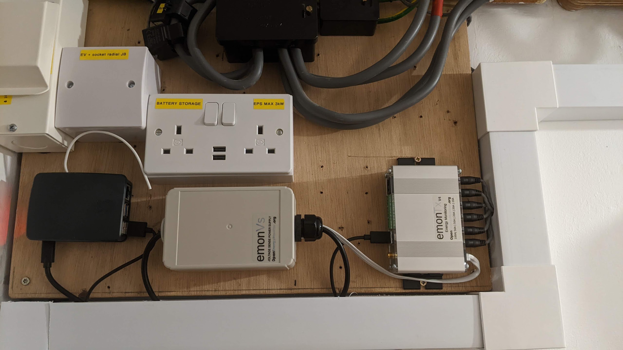

4. emonBase Installation
  • Depending on the installation it may make sense to install the emonBase next to the emonTx4 or further away, perhaps near the internet router for Ethernet connectivity.
  • The emonBase can receive data from the emonTx4 either via 433 MHz radio or if near by via wired USB connection.
  • If near by, the emonBase can be powered by the emonVs USB-C cable.
  • Alternatively a separate USB-C power supply will be required if located elsewhere.

Installation example 1
In this installation example the emonVs has been hardwired into a suitable circuit breaker in the consumer unit. 5 CT sensors are clipped around individual circuits in the consumer unit and 1 CT sensor is clipped around the main supply to the house. The emonBase is located separately in the living room and receives data from the emonTx4 via 433 MHz radio. A short strip of trunking here made all the difference for a neater finish!
Installation example 2
In this installation the emonBase is located next to the emonVs and emonTx4. Both the emonTx4 and the emonBase are powered by the emonVs. The CT cables are routed through the trunking to the consumer unit where they are clipped around the individual circuits that are being monitored.
