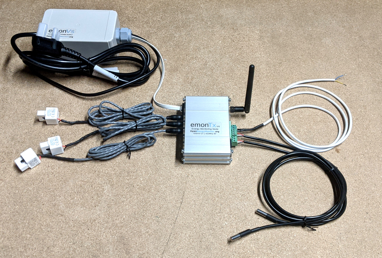

Hardware
The following outlines the kit we would recommend for an emonTx4 heat pump monitor installation. You may want to add more CT sensors or temperature sensors depending on your installation requirements.
1x emonTx4
1x emonVs-psu voltage sensor and power supply
or the emonVs-mini together with a seperate power supply.1x+ CT sensors (rating and number as required)
2x+ DS18B20 temperature sensors
firmware supports 3x by default, additional sensors can be added.1x+ Cable to read from Sika VFS analog output with integrated voltage divider.

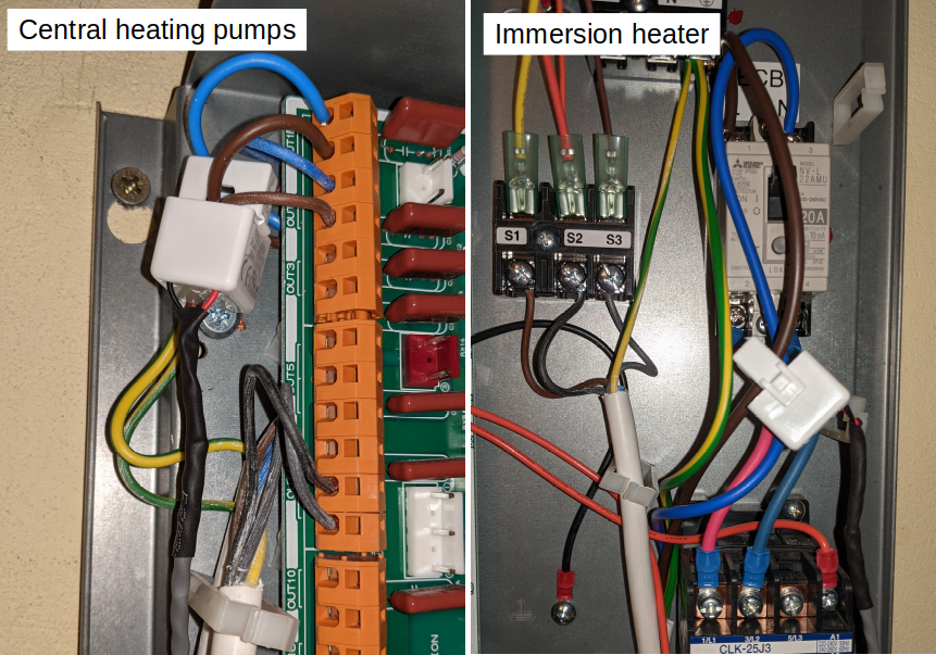

Mitsubishi Ecodan heat pumps usually have 1,2,3,4 & 5 on one supply and circuit breaker, 6 & 7 will usually be connected seperately.
On several EcoDan installations that we have worked with the outside unit was connected via an armoured cable to the main consumer unit - often some distance away. The primary pipework and a signal & power cable then run to a location inside the house where the inside controller is located alongside other components such as the central heating pump, diverter valve, hot water cylinder etc.

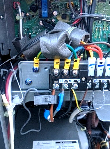

We often find that the most convenient place for the CT sensor that measures the electricity consumption of the EcoDan outside unit (and usually inside controller) is inside the outside unit itself, with a cable extension back to an emonTx4 located next to the inside controller.
The following picture shows a 50A CT sensor on the main supply connection terminals inside the outside unit. This unit is a 11kW (heat output) unit which specifies a 32A MCB rating. The maximum current seen so far on this unit has been 17A.
Warning
The supply to the heat pump should be disconnected before opening the front panel on the outside unit. This work should only be carried out by a suitably competent person due to electrocution risk.
It’s then often convenient to add additional CT sensors at the location of the inside controller to measure central heating pump electricity consumption and the immersion heater separately.

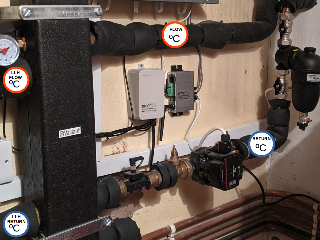

2. Temperature sensing
The next step is to add temperature sensors. It can be useful to measure a wide range of system and environment temperatures when monitoring heat pumps.

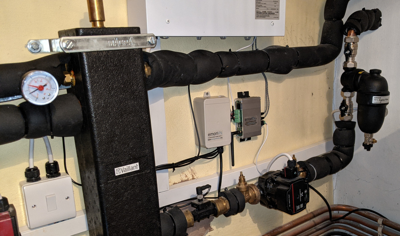

In the following example installation we are monitoring the flow and return temperatures in the primary pipework. Together with a flow rate measurement, we can use these to calculate the heat output of the heat pump.
We are also measuring the flow and return temperatures on the radiator side of the low loss header. These can be used to check how well balanced the flow rates in and out of the low loss header are and how much distortion is present.

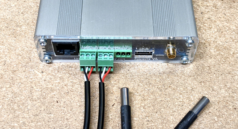

The emonTx4 single phase emonTx4_CM_6CT_temperature firmware supports temperature sensing using DS18B20 temperature sensors. We supply these as encapsulated waterproof sensors in our shop. One of the challenges to accurate temperature measurement is mounting these to the flow and return primary pipework. John Cantor of heatpumps.co.uk, who we have worked with on heat pump monitoring, wrote a useful blog post with suggestions for different ways to mount these sensors here Temperature sensing with OpenEnergyMonitor.
The most accurate mounting method would be to use temperature sensor pockets which immerse the sensor in the fluid being measured. These however require a system drain down and plumbing work to install.

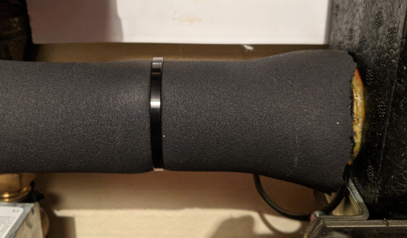

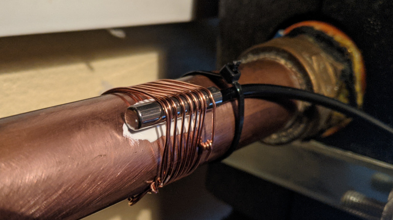

When retrofitting monitoring to an existing system it’s often more practical to mount the sensors to the outside of the pipework. The following illustrates one way of doing this, we are still experimenting with the best approach.
Testing the difference between sensor pockets and pipe surface measurement suggests that pockets read about 0.5C higher than measurements taken at the pipe surface. See temperature sensing error below.
1. Remove the rubber heat shrink cover from the bottom end of the DS18B20 temperature sensor, this ensures that the sensor cylinder is in maximum contact with the pipe.
2. Choose a straight piece of pipe where you can ensure a good insulation cover after installing the sensor, avoid attaching to fittings. Clean the copper pipe with some wire wool to remove any oxide layer.
3. Place a little thermal paste (used for computer CPU heat sinks) on the pipe to aid conduction.
4. In this example we have wound a length of solid core copper wire around the pipe and sensor with the idea that it will aid conduction of heat more evenly around the sensor body. A cable tie on the cable end of the sensor can help keep the sensor in place.
5. Ensure that the sensor and pipework is well insulated.

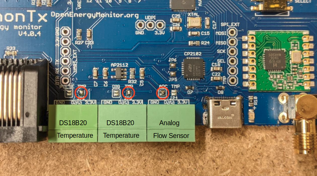

6. Connect temperature sensors to the emonTx
7. Ensure that the emonTx4 solder bridges are configured for temperature sensing on the first two terminal blocks and analog on the last block:

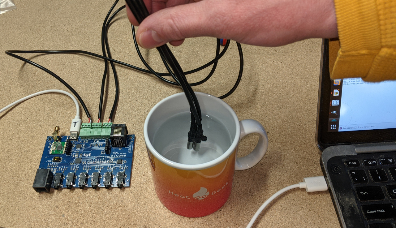

Temperature sensing error
A small error in temperature measurement can make a large difference to heat output measurement accuracy. To give an example, let’s say we have a relative error between the flow and return temperature measurement of 0.2°C. If the flow rate is 20 L/min, the heat error is:
4200 J/kg.K x (20 L/min / 60 s/min) x 0.2 K = 280W
The DS18B20 temperature sensors that the emonTx4 supports have a maximum error of ±0.5°C from -10°C to +85°C. The typical error curve suggests a mean error of -0.2°C at 20°C decreasing to 0°C at 60°C. The default resolution set in the firmware is 11-bit which provides a resolution of 0.125°C.
For heat measurement the relative error between the flow and return temperature sensors is more important than the absolute error of the individual flow and return temperature measurements.
![../_images/temperature_rel_error_test.jpg](../_images/temperature_rel_error_test.jpg)
One relatively simple way to test this relative error is to attach the sensors to be installed together and take comparative measurements immersed in warm water. To give an example of the kind of difference we’ve observed, a test over 138 readings gave an average difference of 0.03°C between two sensors from the same batch and a 0.1°C comparing with a sensor from a different batch. The accuracy of the heat measurement could be improved by calibrating for these differences.
In our experience ecapsulated DS18B20 temperature sensors mounted to the surface of copper pipe as shown above can read ~0.5°C lower than sensors immersed in water using sensor pockets. The flow and return temperature sensors usually read lower by the same amount, which means the deltaT and heat measurement is not necessarily affected. Taking account of this difference and applying a manual adjustment may however be worthwhile when using the flow temperature sensor for carnot COP calculation.

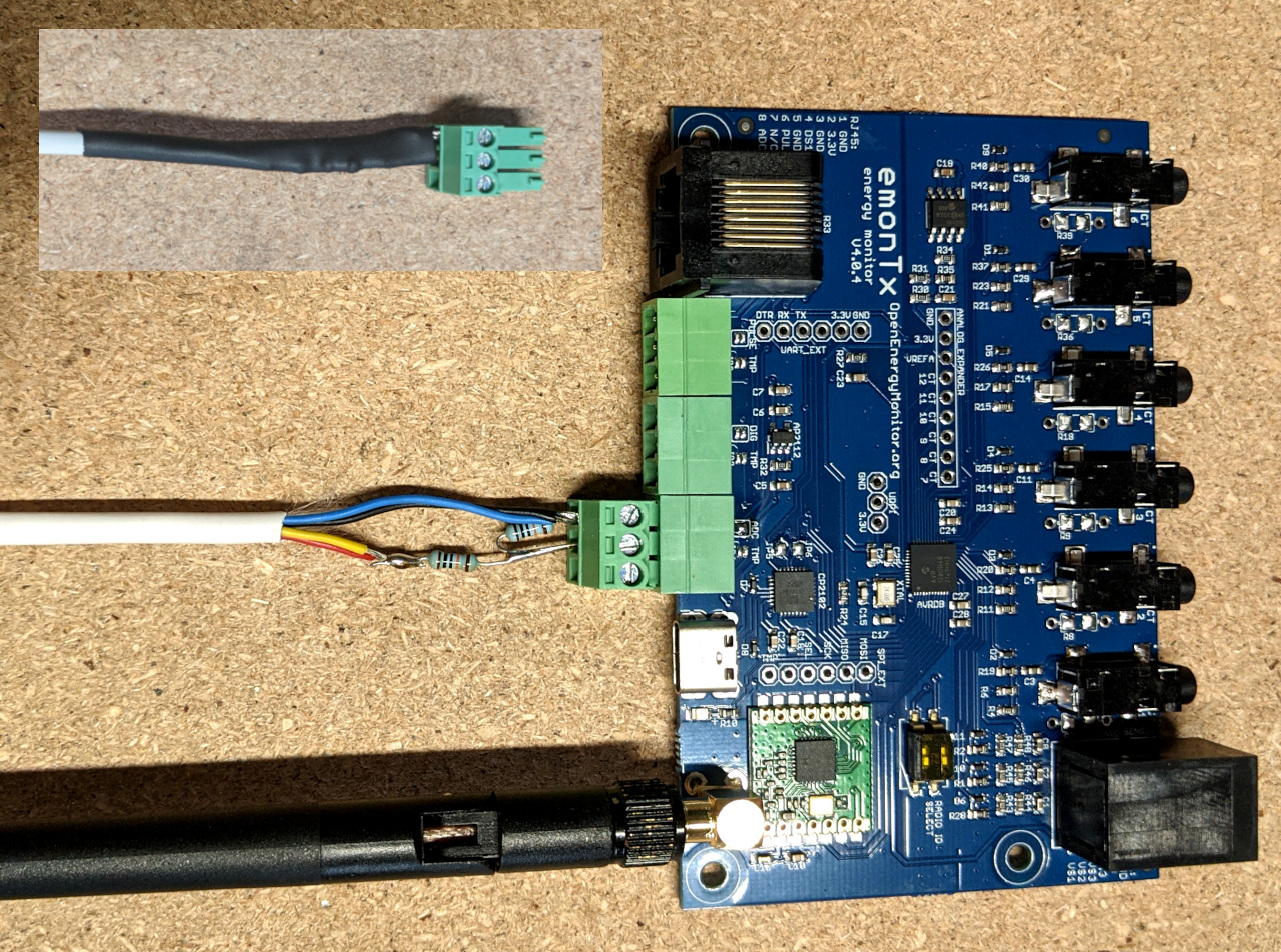

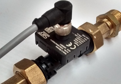

3. Reading from a Sika VFS analog output
Some heat pumps have a Sika VFS flow sensor installed as part of the standard installation package. The Sika VFS flow sensor looks like this:
If you have a Mitsubushi EcoDan, this will usually be installed near your EcoDan controller, which is often mounted close to the hot water tank.
The Sika VFS flow sensor that is usually installed alongside Mitsubushi EcoDan heat pumps has an output of 0.5V at 5L/min and 3.5V at 100L/min. The following lists typical flow rates and Sika VFS output voltages that we might see from a range of heat pump sizes:
5kW heat output at a dT of 5K is ~14 L/min (0.78V)
8kW heat output at a dT of 5K is ~23 L/min (1.07V)
11kW heat output at a dT of 5K is ~32 L/min (1.35V)
14kW heat output at a dT of 5K is ~40 L/min (1.61V)
We can see that at 23, 32 & 40 L/min the output voltage is higher than the 0-1.024V range of the analog input on the emonTx4. We therefore need to scale this voltage down to better fit the emonTx4 input voltage range. This can be done with a simple voltage divider.
In the example pictured below I have choosen a voltage divider with equal values for both top and bottom resistors, 100k each. This halves the voltage seen at the emonTx4 analog input pin. 1.61V will now become 0.8V and the maximum measurable flow rate is just over 50L/min.
Different voltage divider values can be choosen to best fit the range of flow rates expected.

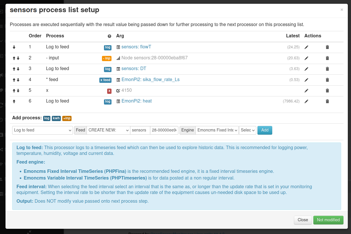

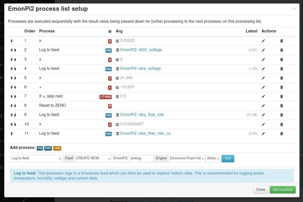

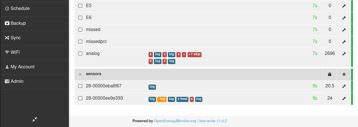

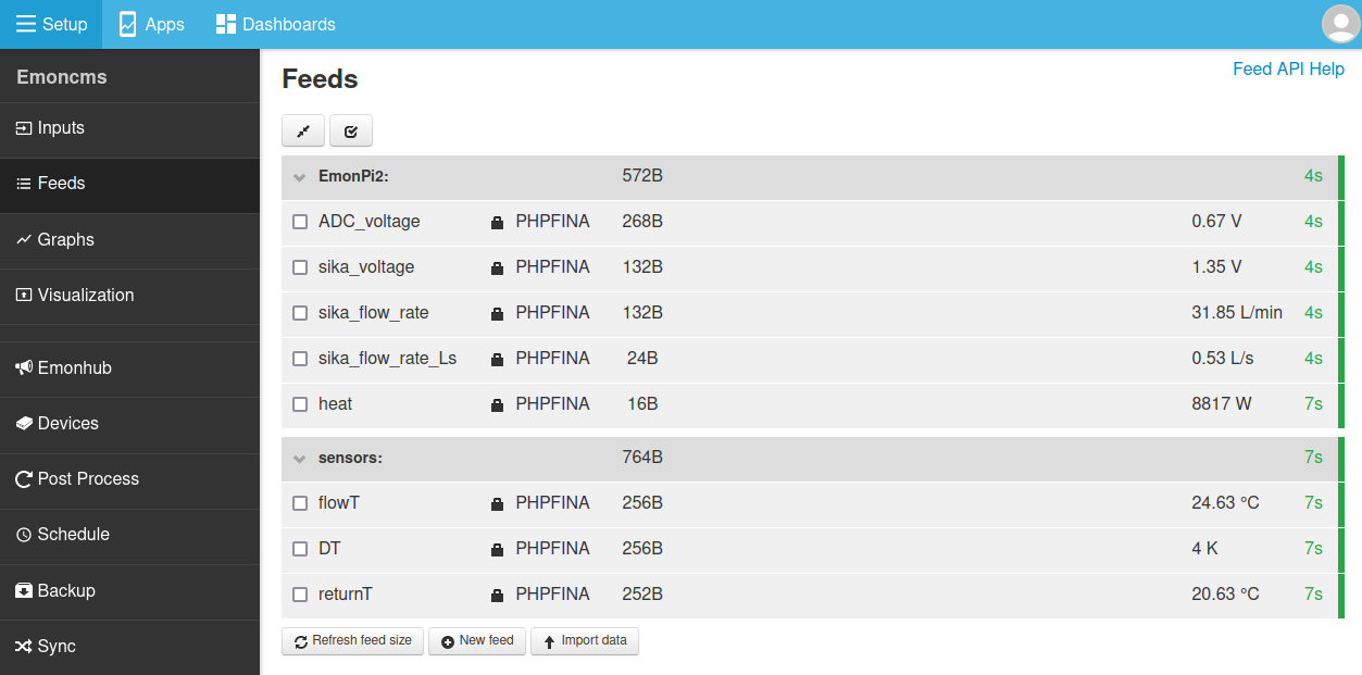

6. Emoncms input configuration
The following set of screenshots gives an example of configuring this analog input for use in reading the flow rate from the Sika VFS flow sensor. The flow rate is then used together with measurement of flow and return temperature to calculate heat.
These screenshots are from the emonPi2 guide, the process is however exactly the same for the emonTx4:
