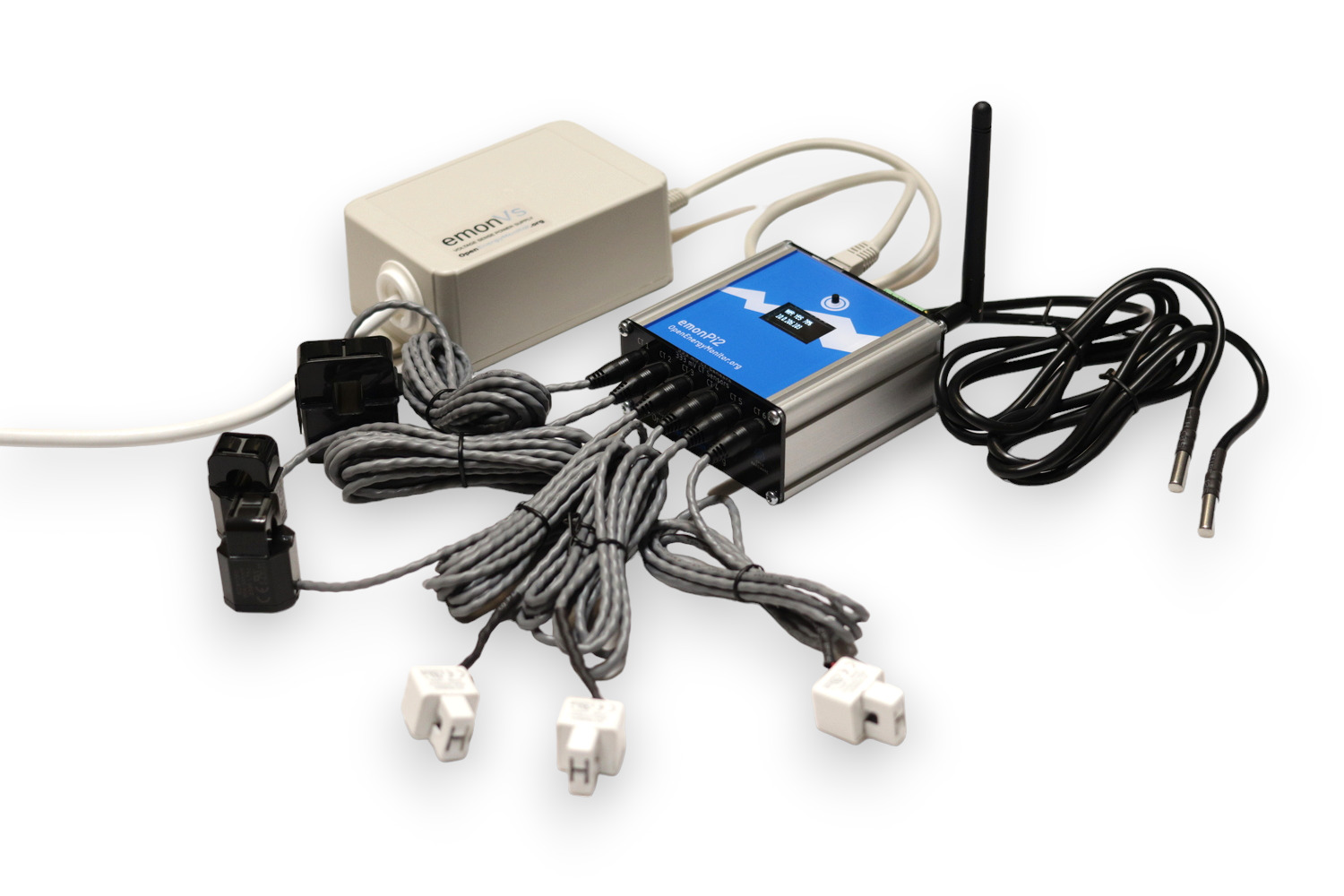

The following guide covers installation of the emonPi2 6x input energy monitor and integrated base-station.
Hardware covered in this guide:
- emonVs: Precision voltage sensor and power supply
- Up to 6 CT sensors
- RJ45 voltage sensor and power supply cable

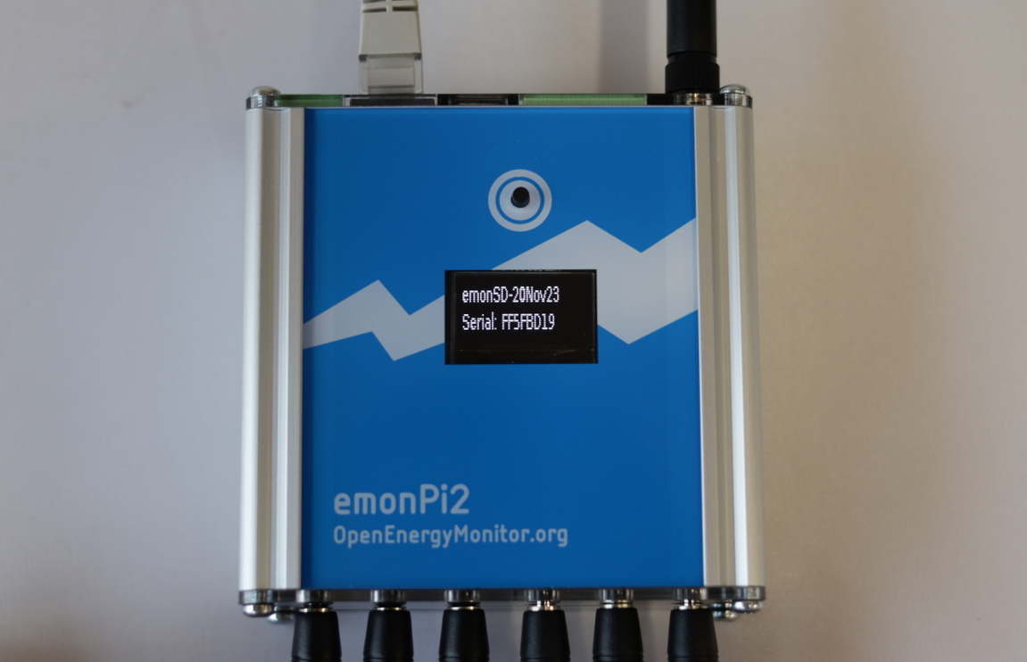

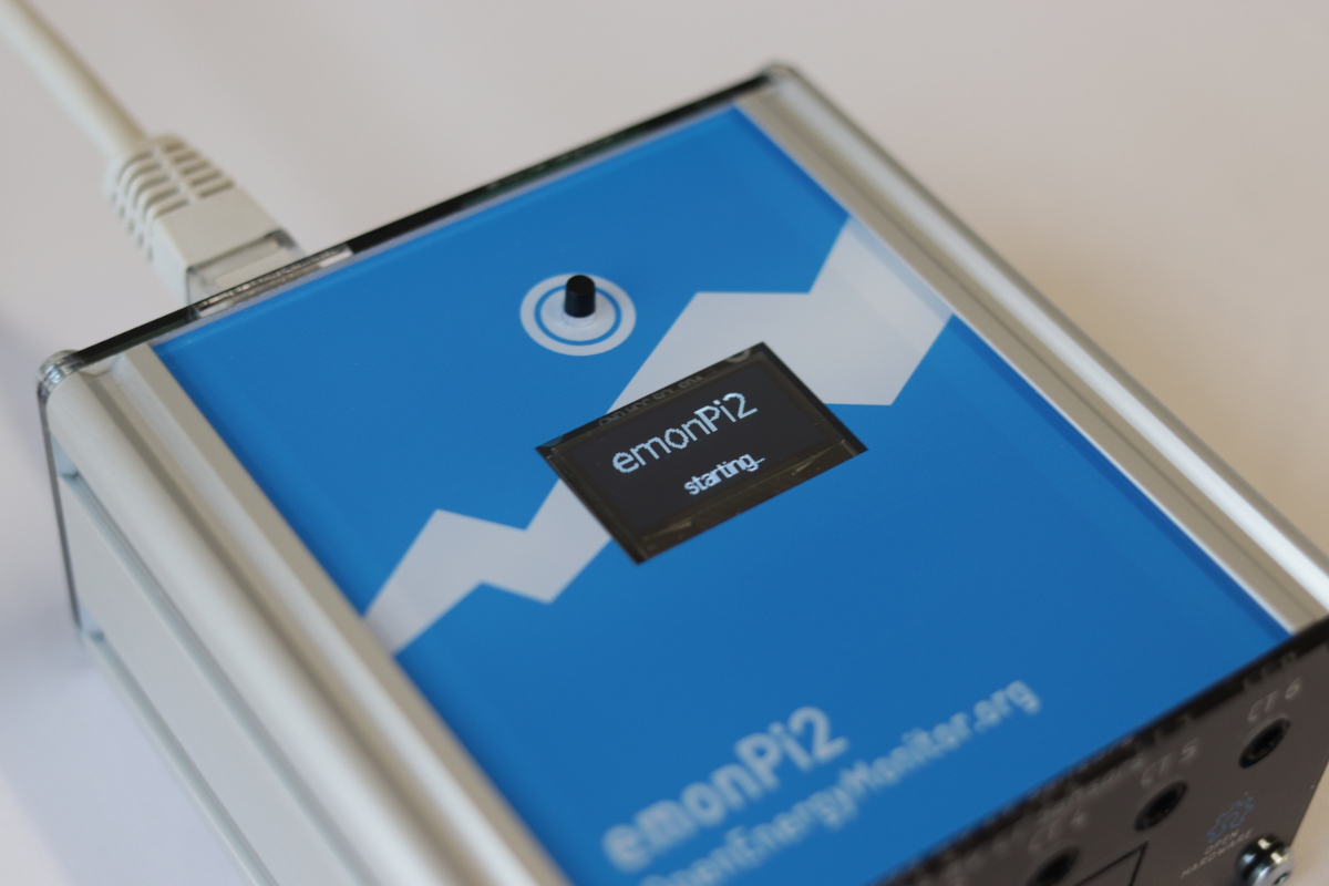

- Switch on mains socket. The display on the emonPi2 will show - emonPi2, starting... On the SD card side of the case the RaspberryPi 4 indicator LED should be visible through the black face plate.

- Current transformers (CTs) are sensors that measure alternating current (AC).
- The emonPi2 supports a wide variety of 333mV voltage output CT sensors. We stock 20A, 50A, 100A & 200A options in the OpenEnergyMonitor shop. The physical size of these CT sensors is also roughly proportional to their current rating. For highest accuracy it’s a good idea to choose CT sensors that match the rating of the circuit being monitored. As an example a 20A CT should be used for 16A or 20A circuits, a 50A CT for 32A EV chargers or 100A CT for whole house monitoring (assuming a 100A rated supply).
- CT sensors need to be clipped around the Live OR Neutral cable of the AC circuit to be measured (not both). The CT sensors have an indicated direction printed on the case - K->L, where L is the direction of the load. That’s on the Line conductor, the arrow points away from the load on the Neutral. This will ensure the correct sign (+/-) on the power readings.
- Take care not to compress the sensor with any sideways force as this can affect the accuracy of the measurement.
- The new range of CT sensors used with the emonPi2 are all voltage output CT sensors with integrated burden resistors and so are safe to clip on to the circuits that you wish to measure before plugging into the emonPi2 if that makes installation easier.

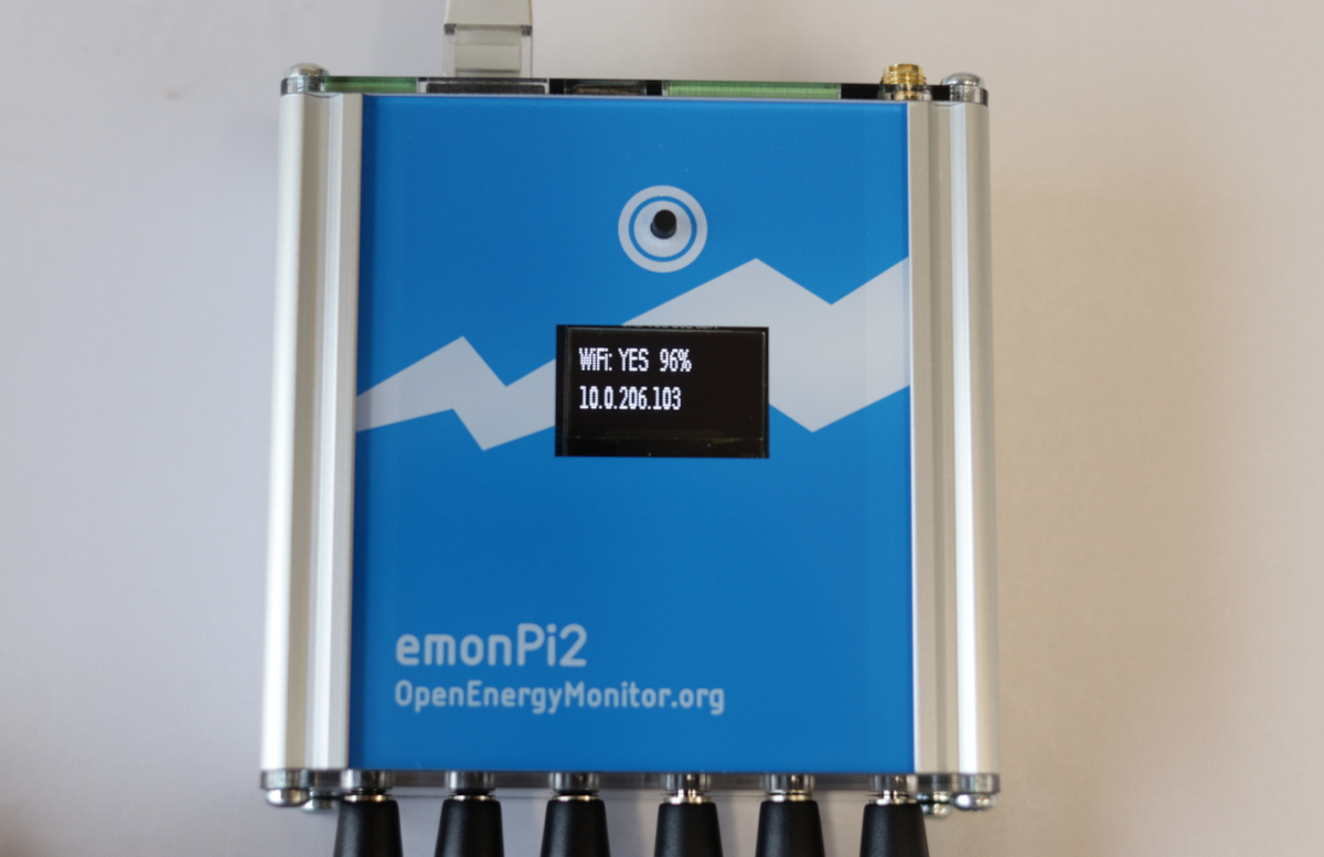

If a wired ethernet connection is available and you have the emonPi2 hardware that supports Ethernet (e.g RaspberryPi 4 shop option), this does usually give the most reliable result. We recommend using shielded Etherent cable to reduce potential electromagnetic interference. Simply plug the Ethernet cable into the Ethernet port found next to the USB ports and CT sensor inputs - NOT the RJ45 port used for the emonVs voltage sensor and power supply.
Scroll to page 3 on the emonPi2 display to find the assigned IP address.

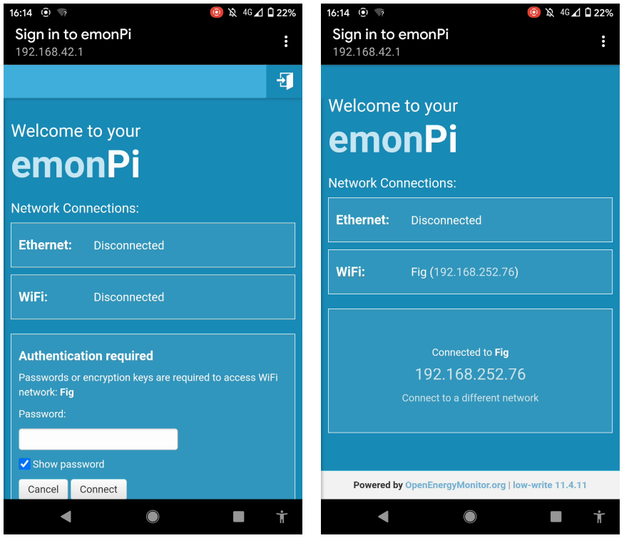

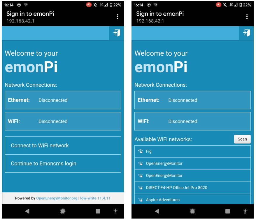

6. Connecting via WiFi
When the emonPi2 is powered up it will create a Wi-Fi Access Point called emonPi. Connect to this using password emonpi2016. On Android devices a captive portal option should pop up with the option to ‘Sign in’. This will bring up the Wi-Fi configuration interface.
Note
Captive portal and the new Wifi setup interface is available on emonSD_01Feb24 or newer. You may wish to upgrade to the latest emonSD image see the emonSD download section.
Note
While captive portal generally works well on Android phones, the current software version may not always provide a consistent captive portal ‘Sign in’ popup on other devices and browsers. If no ‘Sign in’ option appears browse manually to the IP address http://192.168.42.1.
1. Click on ‘Connect to WiFi network’ to show the list of available WiFi networks. Click on the network that you wish to connect to.
2. Enter the WiFi network passkey (often found at the back of the internet router). Click connect. Connecting to a network and relaying the status update back to the user interface typically takes around 20 seconds. Note down the assigned IP address and use this to connect to your emonPi2 once you are connected back to your home WiFi network.

The WiFi IP address can also be accessed by scrolling to page 4 on the emonPi LCD:

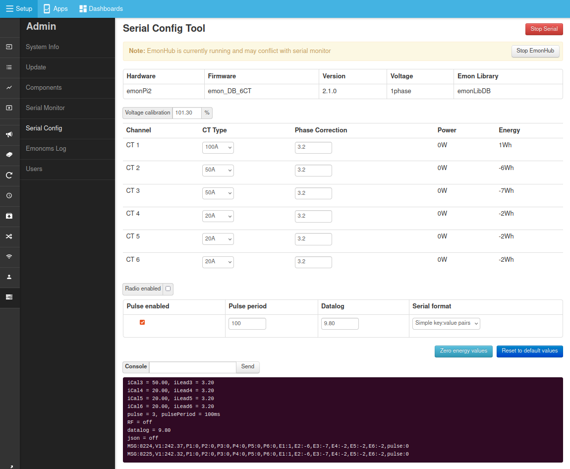

8. CT calibration selection
Different rating CT sensors e.g 100A, 50A, 20A etc, require differant preset calibrations.
CT calibration is usually pre-configured in the shop as part of the order process, but you may wish to double check that your calibration configuration matches the sockets that you have plugged the CT sensors into at this point.
- Navigate to - Setup > Admin > Serial Config
- Click on - Stop EmonHubto temporarily stop the EmonHub service while we perform calibration.
- Select serial port - /dev/ttyAMA0and click- Connect.
- After a couple of seconds the emonPi2 will print out its current configuration which will populate the interface (if it does not do this type - land click- Sendto reload the calibration details from the emonPi2 measurement board).
- Adjust the CT rating to match the CT sensor that you have installed on each channel.
- Click on - Save Changesto ensure that the new configuration is recorded such that it persists when you power cycle the board.
- When finished, click on - Stop Serialto disconnect the serial configuration tool and then- Start EmonHubto restart the EmonHub service.

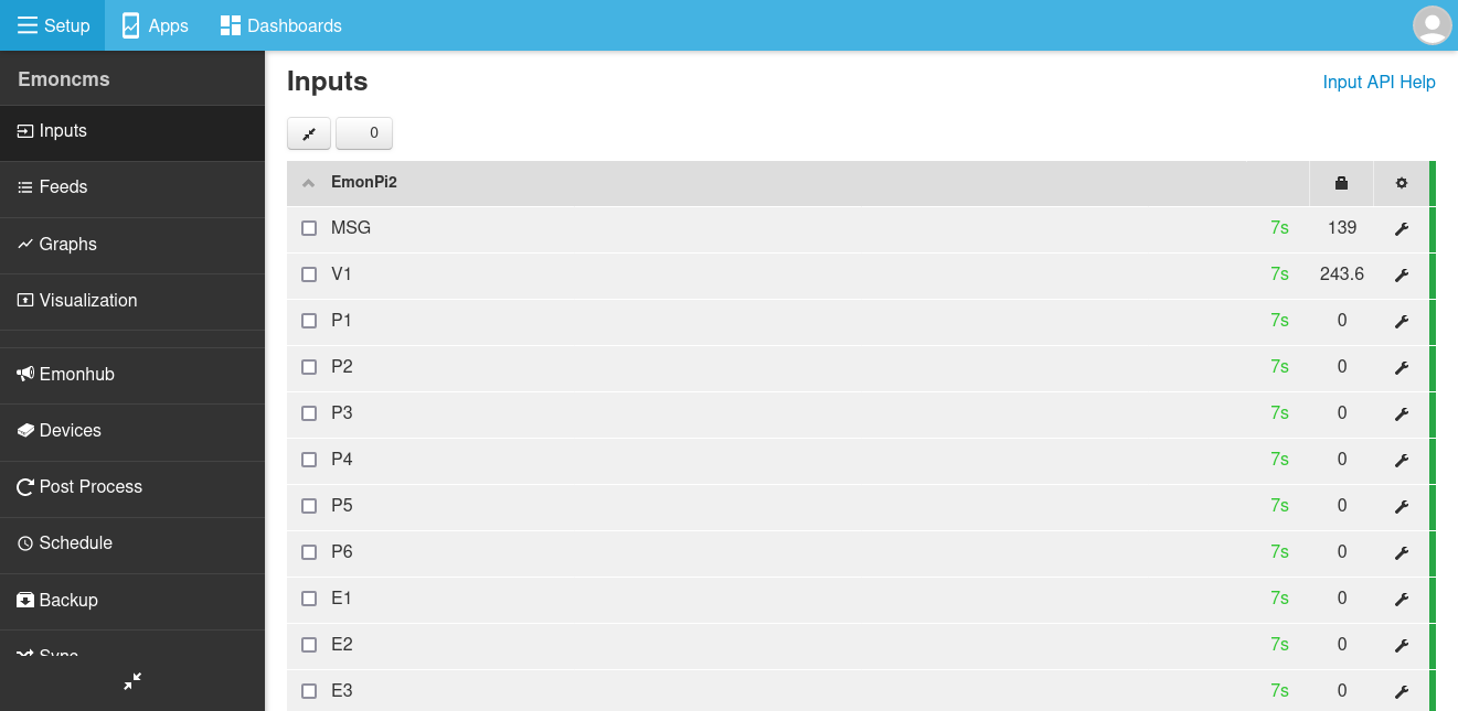

9. Setup input and feeds
Configure inputs by navigating to Setup > Inputs. The emonPi2 will pop up here automatically under the EmonPi2 node name.
The next step is to log the input data to feeds. Inputs are just placeholders showing the latest values sent from the emonPi2, we need to create feeds if we want to record a time-series of these values. It’s possible to either manually configure each input as required, or if you just want to record everything for now and delete what you don’t need later, then you can use the pre-configured Device Template.
Tip
Input configuration using the emonPi2 device template: On the Setup > Inputs page, Click on the cog icon (top right corner) of the emonPi2 node. The ‘Configure Device’ window will appear, click on ‘emonPi2 Standard’, you may need to scroll down a little in the Devices pane to find. Click ‘Save’ and ‘Initialize’. This will create feeds that record real power and cumulative energy for each channel, Vrms, total message count, temperatures and total pulse count. Navigate to Setup > Feeds to see these feeds.
Manual input configuration: You may only want to record specific channels or apply more complex input processing.
With feeds created, explore the data using the graph view. Navigate to Setup > Feeds and click on a feed of interest to open the graph view. Click on the drop down time selector near the title and select the last hour. Click and drag to zoom further to see the new data coming in.
Try creating an Emoncms App. Click on the Apps tab. From the Available Apps list select ‘My Electric’ and click ‘Create’, Select a power feed for ‘use’ and cumulative kWh energy feed for ‘use_kwh’ and then click ‘Launch App’. After a few days this will start to show a daily bar graph of consumption alongside the real-time power graph and totals. There are a wide variety of different app’s to choose from depending on the application.
