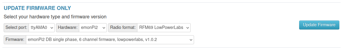

Updating firmware
The easiest way of updating the emonPi2 firmware is to use the firmware upload tool.
In your local emonPi2 web interface, navigate to:
Setup > Admin > Update > Firmware
.Select serial port
ttyAMA0
and then selectemonPi2
from hardware.Select firmware variant as required.

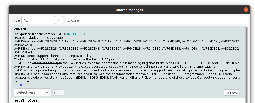

Once you have the IDE installed, you then need to install Spence Konde’s DxCore. This can be done by first pasting the following board manager URL in Arduino IDE > File > Preferences:
http://drazzy.com/package_drazzy.com_index.json
Then navigating to: Tools > Boards > Boards Manager, Select “DxCore by Spence Konde” and click Install.
For more information on DxCore installation see: https://github.com/SpenceKonde/DxCore/blob/master/Installation.md.

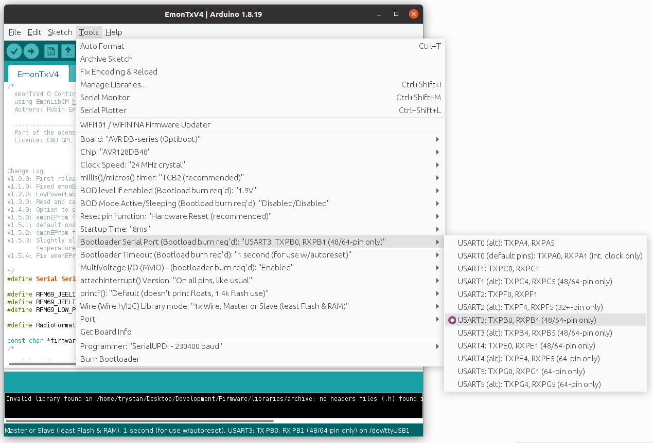

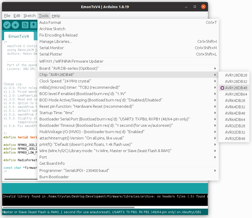

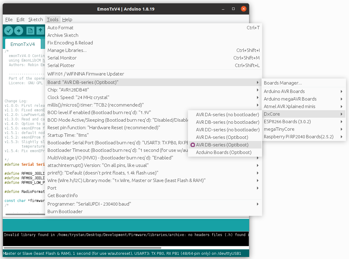

Compilation settings:
With DxCore and the libraries installed the firmware should then compile.
Under Tools, select the following configuration options:
Select Board “AVR DB-series (Optiboot)”
Select Chip: AVR128DB48
Clock Speed: 24 MHz Crystal
Bootloader serial port: UART3: TXPB0, RXPB1
