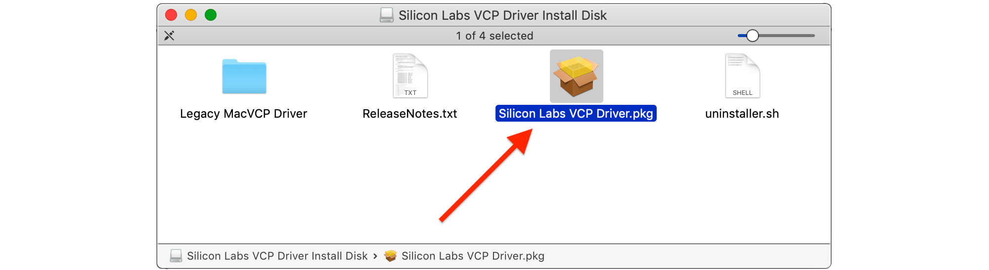

Open the Mac_OSX_VCP_Driver
folder and double-click Silicon Labs VCP Driver.pkg
to install the drivers.

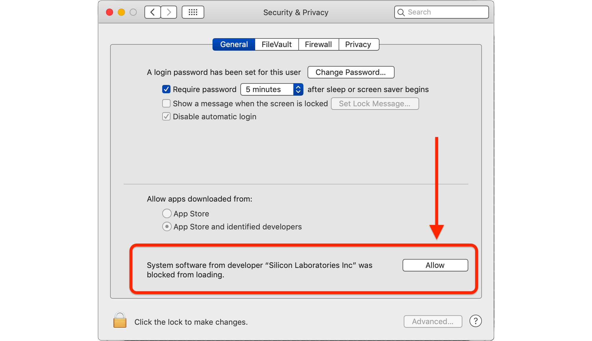

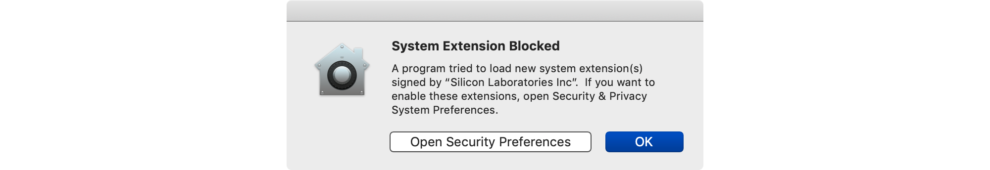

If the software is blocked a window will pop-up with instructions. Click Open System Preferences.
Open the macOS System Preferences
> Security & Privacy
and click Allow.

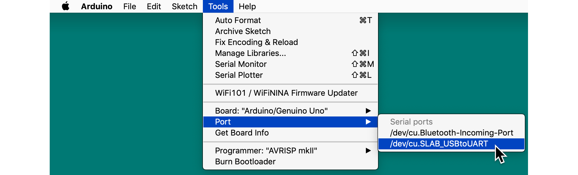

Make sure you restart the Arduino IDE after installing the drivers. Before connecting the programmer, check Tools > Port
and make note of the available ports. Now connect the programmer and your module (emonTx, emonTH, etc). Go back to the main menu and select Tools > Port
again. Port
should be available and showing a new port. Select the port /dev/cu.SLAB_USBtoUART
. And under Tools > Board
ensure Arduino/Genuino Uno
is selected.
