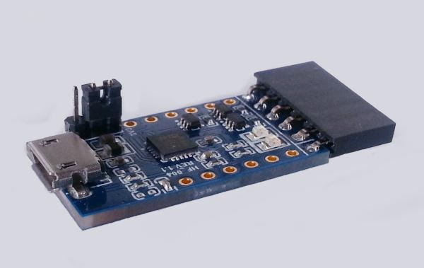

Assembly
As supplied by Future Technology Devices, the programmer comes as 5 parts: the printed circuit board with the voltage selection jumper already fitted in the 3.3 V position, one right-angle 6-way header socket and two 7-pin headers (pins). The two 7-pin headers are not required and can be repurposed, or if you purchased the programmer in kit form from the OEM Shop, they will have been removed from the packet.
If you purchased it pre-assembled, nothing more needs to be done.
Otherwise, insert the right-angled header socket from the component side and solder in position, ensuring that it sits as low as possible on the PCB.

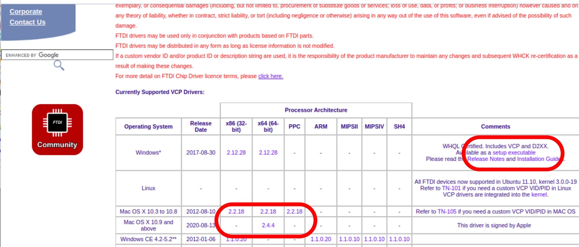

Windows 10 & MacOS
Download the drivers from https://www.ftdichip.com/Drivers/VCP.htm.
If you go via the FTDI home page, click on “Drivers” in the navigation column on the left, then “VCP Drivers” to arrive at the page in the link above.
Scroll down a little way to this table:
Windows 10
Click on setup executable in the “Comments” column against “Windows”.
This will download a zip file CDM21228_Setup.zip to your usual location. It contains just one executable file, CDM21228_Setup.exe Double-click on this (or right-click and select ‘Run as administrator’) and allow it to install the drivers in the normal way.

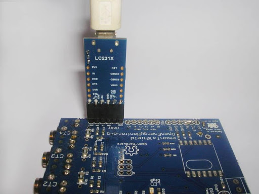

Use a Micro USB cable to connect the programmer to your computer. Before connecting the programmer, ensure the jumper link on the programmer is set to the 3.3 V position for the emonTx, emonTH and emonPi Shield, or 5 V for the emonTx Shield. This sets the voltage levels on the data lines.

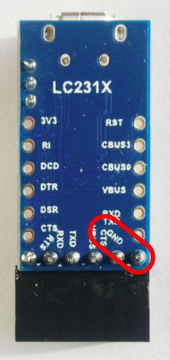

On the UART connector, the GND pin is labelled on the underside.

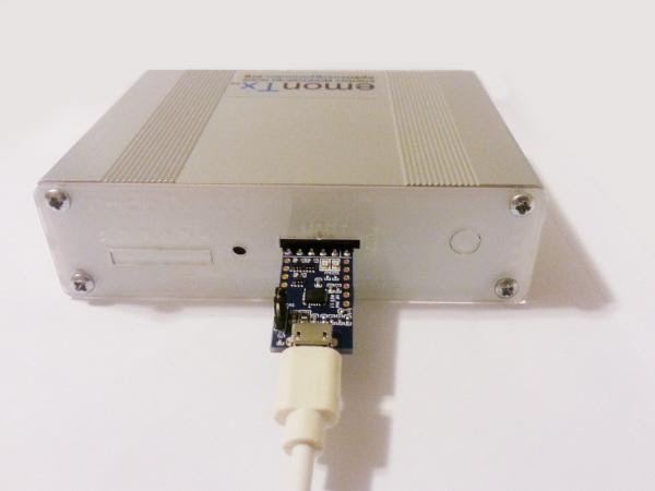

EmonTx
Plug the programmer into the emonTx with the component side of the board facing up and the GND connection aligned with the engraving on the panel; that is, nearest to the aerial socket on the emonTx.

Set the jumper to the 5 V position. Plug the programmer into the emonTx Shield with the component side of the board facing outwards and the GND connection farthest from the jack sockets.

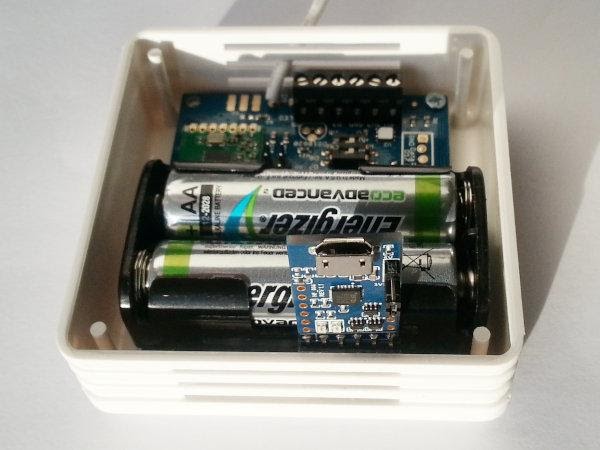

Plug the programmer into the emonTH with the component side of the board facing outward and the GND connection farthest from the corner.

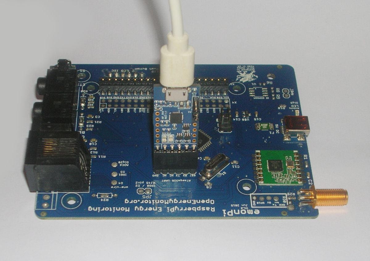

EmonPi Shield
Plug the programmer into the emonPi Shield with the component side of the board facing the name “RaspberryPi Energy Monitoring”. Note that a separate 5 V USB power supply is needed to program the Shield and for the Shield to work.

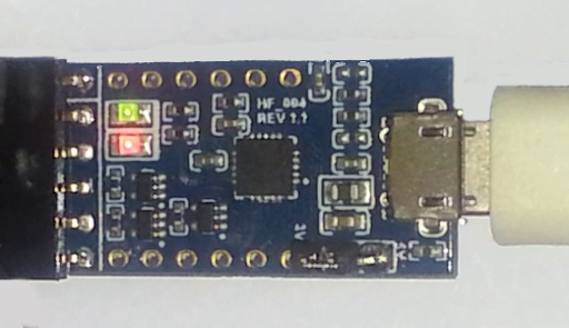

The programmer has two LEDs that indicate activity on the Tx and Rx data lines. Unlike other types, there is no ‘power on’ indication. The green LED lights to indicate data flowing from the programmer to the Emon device, the red LED lights to indicate data being sent from the Emon device to the computer.
