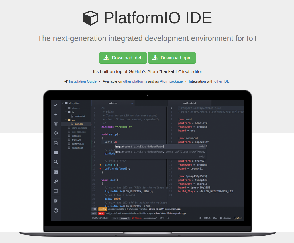

PlatformIO IDE
PlatformIO IDE is built on Atom open-source ‘hackable text editor for the 21st century’ built by the GitHub. See PlatformIO IDE Install guide for more info.
Note: skip this section if your would prefer to use PaltformIO via it’s excellent command-line interface
These install steps have been tested to work on Linux, Mac and Windows.

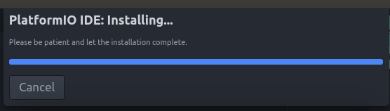

The first time Atom IDE is opened after a few seconds PlatformIO will finish the installation and then display its home page.

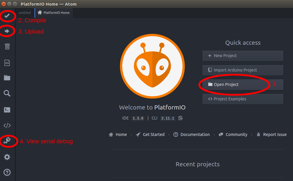

From the PlatformIO Home screen in Atom IDE choose
Open Project (1)*Navigate to the standard emonTx Firmware
emontx3/firmware/emonTx34/emonTx34_CMthen chosenopenYou should see the emonTx34_CM firmware files in the file-tree on the right-hand-side of the editor
Compile Firmware
Once change has been made save then file then compile with PlatformIO by clicking
Compile (2)If this is the first time the code has been compiled PlatformIO will ask if you want to install all the required libs that are specified in
platformio.ini. See PlatformIO library manager.
Upload Firmware
If code compiles successfully upload the firmware by clicking on
Upload (3)Note: A USB to UART cable is required to upload to emonTx / emonTH
After successful upload check nodeID has changed by viewing serial output, click
Serial Monitor (4)and choose115200 baud.
