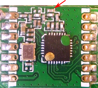

The RFM69CW - 433 MHz Option
![../../_images/RFM69CW-433.png](../../_images/RFM69CW-433.png)
The antenna connection (pin 1) is top left. Distinguishing features are the i.c. is 28-pin square, marked “RF69”. The visible difference between the 433 MHz version and the 868 MHz version is the 433 MHz version has an extra capacitor, shown arrowed above, and green and bronze dots.

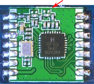

The RFM69CW - 868 MHz Option
![../../_images/RFM69CW-868.png](../../_images/RFM69CW-868.png)
The antenna connection (pin 1) is top left. Distinguishing features are the i.c. is 28-pin square, marked “RF69”. The visible difference between the 433 MHz version and the 868 MHz version is the 868 MHz version has no capacitor in the position shown arrowed above, and might have yellow and bronze dots.

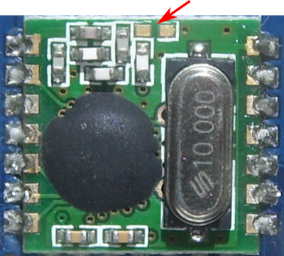

The RFM12B - 433 MHz Option
![../../_images/RFM12B-433_0.png](../../_images/RFM12B-433_0.png)
The antenna connection (pin 1) is top left. Distinguishing features are the i.c. is usually either a 16-pin dual-in-line (as here) or a ‘blob’. The visible difference between the 433 MHz version and the 868 MHz version is the 433 MHz version has an extra capacitor, shown arrowed above.

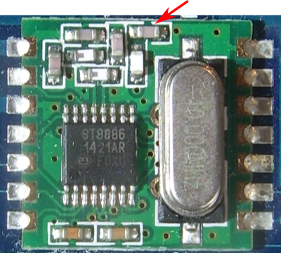

The RFM12B - 868 MHz Option
![../../_images/RFM12B-868.png](../../_images/RFM12B-868.png)

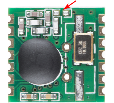

The antenna connection (pin 1) is top left. Distinguishing features are the i.c. is usually either a 16-pin dual-in-line or a ‘blob’ (as here). The visible difference between the 433 MHz version and the 868 MHz version is the 868 MHz version has no capacitor in the position shown arrowed above.

Do not rely on the relative positions of the crystal and the i.c. when orienting the RFM module. The safe guide is the cluster of small surface-mount components, which are nearest to the antenna pin (pin 1) in both the RFM12B and the RFM69CW versions. You should locate the PCB track from a pad to the antenna, which will be either a whip or an SMA socket, to see which is pin 1.
Make absolutely certain that you have oriented the module correctly before soldering, as without a professional rework station it is almost impossible to remove the module without damage either to the module, or to the main pcb, or both.
Difference Between 433 MHz & 868 MHz Modules
The only difference between the modules for the two RF bands is the antenna tuning, hence the additional capacitor that is visible in the photographs above. A 433 MHz band module will work at 868 MHz, and an 868 MHz band module will work at 433 MHz, but because the tuning is wrong, receiver sensitivity, transmitter output power and maximum range are significantly reduced. Operating an RFM69CW at maximum power on the wrong band or without an antenna, can damage the module.

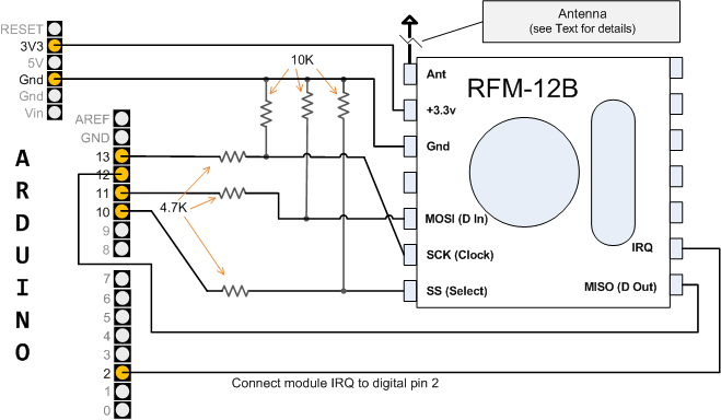

Arduino Uno Connections
An RFM12/69 can be connected to an Arduino running at 5V with the following circuit. The 4.7k and 10k resistors are used to drop the voltage levels from the Arduino down to 3.3V so as not to damage the RFM12/69 module.
The 4.7k resistors can be replaced with a direct wire link and 10k resistors removed if the Arduino or ATmega microcontroller is running at 3.3V.
Credit to Michael Margolis from Arduino Cookbook for Arduino connection diagram.
