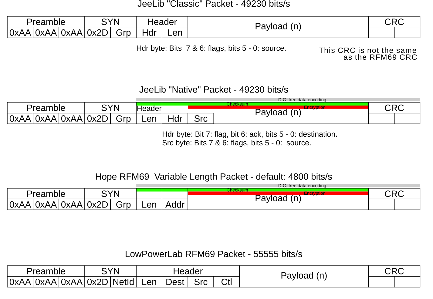

433MHz Radio Format vs Device
There are 3 types of Radio Format in use;
JeeLib ClassicBackwards CompatibilityJeeLib Nativerfm69n (for LibCM on emonPi)LowPowerLabs (LPL)Standard (RF Encryption)(inc. acknowledge/retry)

*1 https://github.com/openenergymonitor/emontx4/tree/main/firmware/EmonTxV4/compiled note: files for all three formats are available here
*2 https://community.openenergymonitor.org/t/the-emonpicm/18173
*3 need to edit JeeLib files
*4 https://mk2pvrouter.co.uk/index.html
*5 needs selection of correct hardware (e.g. including RFM69) and firmware
*6 GLCD RFM69 native packet format firmware is here: [https://github.com/alandpearson/EmonGLCD/tree/master/firmware/SolarPV_rfm69] Also see: https://community.openenergymonitor.org/t/the-emonpicm/18173/15 onwards
*7 The RFM69Pi module has all three formats available at https://docs.openenergymonitor.org/emonbase/rfm69-pi.html It can also be programmed from the emomSD software update page.
RFM Packet Formats
