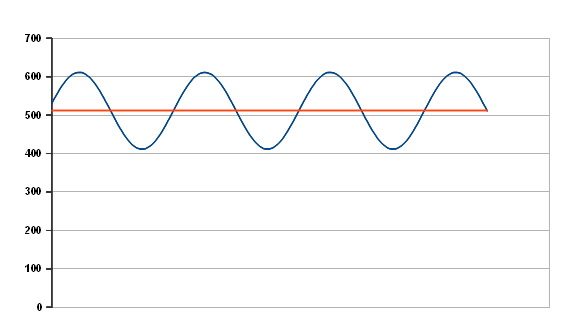

The Atmega ADC (Arduino) has an input voltage range of 0 to Vcc and so when sampling an AC waveform the waveform needs to be biased at Vcc / 2. This translates to a digital offset value of approximately 512. The waveform sample digital value will be between 0 and 1023, centered around 512.
To do the maths for real power, rms voltage and current calculations, we need remove this offset. This can be done with a digital filter. There are two approaches: the high pass filter, which allows the high frequency component through removing the bias, or the low pass filter, which first finds the bias, then subtracts the bias from the signal. Let’s start with the high pass filter.

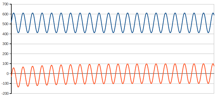

int sample = 0; int last_sample = 0; double a = 0; double filtered_value = 0; void setup() { Serial.begin(9600); } void loop() { // Generate a test signal last_sample = sample; a+=0.1; sample = 512 + sin(a) * 100; // Floating maths implementation of high pass filter takes 36-40 microseconds filtered_value = 0.996 * (filtered_value + sample - last_sample); Serial.print(sample); Serial.print(' '); Serial.println(filtered_value); delay(50); }
Notice that it takes a significant amount of time to settle to the point where filtered_value goes both positive and negative with an amplitude of ±100.

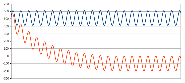

int sample = 0; int last_sample = 0; double a = 0; long filtered_value = 0; void setup() { Serial.begin(9600); } void loop() { // Generate a test signal last_sample = sample; a+=0.1; sample = 512 + sin(a) * 100; long n = filtered_value + sample - last_sample; filtered_value = ((n<<8)-n)>>8; Serial.print(sample); Serial.print(' '); Serial.println(filtered_value); delay(50); }
If you watch the filter settle, it almost works, it appears to be settling correctly, but there’s a problem. filtered_value continues to decrease until it has a positive amplitude of around 0 and a negative amplitude of -200

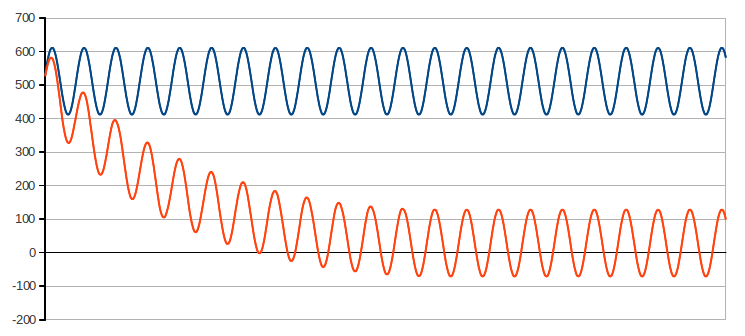

This is partly due to rounding error, we can improve things by adding 128 before bit-shifting right, a trick to round to the nearest integer:
128 is ½ << 8
Changing the filter line above from
to
filtered_value = ((n<<8)-n+128)>>8;
Plotting the result gives:
But it’s still not correct. The problem is the filtered_value variable does not have enough resolution to work correctly. With floating point maths the resolution is in the decimal points, with integer maths we’re rounding to the nearest integer value.

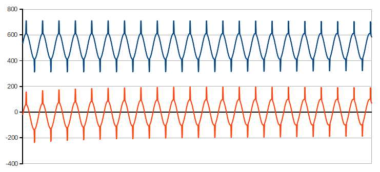

int sample = 0; int last_sample = 0; double a = 0; long shifted_filter = -10000; void setup() { Serial.begin(9600); } void loop() { // Generate a test signal last_sample = sample; a+=0.1; sample = 512 + sin(a) * 100; long shiftedFCL = shifted_filter + (long)((sample-last_sample)<<8); shifted_filter = shiftedFCL - (shiftedFCL>>8); long filtered_value = (shifted_filter+128)>>8; Serial.print(sample); Serial.print(' '); Serial.println(filtered_value); delay(50); }
Here’s the output:
Here’s an example to show that the filter works well with a more complex waveform. The waveform below is what you’d expect from a mixture of resistive loads and a non-linear switch mode power supply for say, a laptop computer.

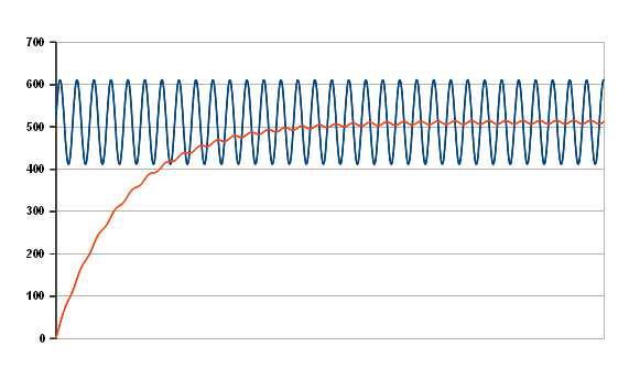

Digital low pass filter
Why a low pass filter? The low pass filter was introduced with the Mk2 Energy Router which uses a common bias supply (buffered by an operational amplifier) to supply the offset voltage for both voltage and current channels. The filter only has to be calculated once, and the resulting offset is naturally the same for both channels and therefore can be subtracted from both readings. This reduces processing time by a significant amount.
The floating point implementation of the classic low pass filter looks like this:
filtered_value = last_filtered_value + 0.004 × (sample - last_filtered_value)
Why 0.004? All that is required is a reasonably small number to provide an adequately long time constant so there is little ripple from the 50 Hz fundamental frequency being measured. α = 0.004 gives a filter time constant of (1 - α)/α = 250 sample periods.
Code example:
int sample = 0; double a = 0; double filtered_value = 0; double last_filtered_value; void setup() { Serial.begin(9600); } void loop() { // Generate a test signal last_filtered_value = filtered_value; a+=0.1; sample = 512 + sin(a) * 100; // Floating maths implementation of high pass filter takes 32-36 microseconds filtered_value = last_filtered_value + 0.004 * (sample - last_filtered_value); Serial.print(sample); Serial.print(' '); Serial.println(filtered_value); delay(50); }
Unfortunately, this takes quite a long time to settle and there is still a significant ripple present. Reducing the filter constant will improve the ripple but worsen the settling time; however because we have a good idea of what the final value should be, it is possible to pre-load the filter by setting the initial value of the output to 512. Now that we have pre-loaded the filter, the filter constant can be reduced to a very small value without forcing a long wait whilst the filter settles before useful readings can be had. This is what the output looks like with a filter α of 0.000122 – the ripple is ¼ count.
