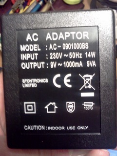

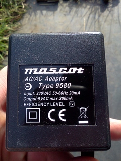

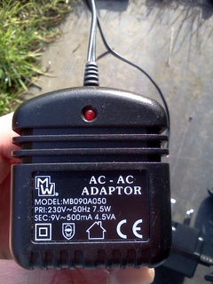

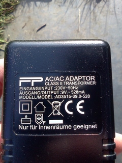

Other AC-AC Adapters
Ac-AC Adapter |
Plug |
Voltage Calibration Coefficient |
UK |
233.67 |
UK |
238.56 |
UK |
234.26 |
Euro |
212.658 |
Ideal Power / TDC |
UK/Euro/US |
see above |
See EmonTx errors for a full analysis of the sources of error in the emonTx.
See Different AC-AC Power Adapters for more detailed information on the different AC-AC adapters.
