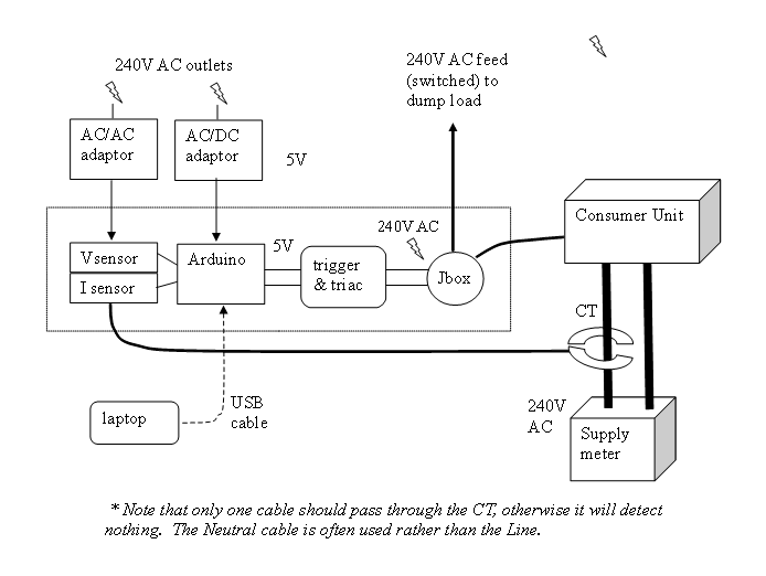

By the use of non-invasive sensors for measuring voltage and current, the rate of energy flow (i.e. Power) is routinely determined in Open Energy Monitor applications. The underlying principles are described in the section “Different ways of Measuring Voltage and Current”.
Energy from the grid normally flows into the premises where consumption is taking place (when importing power). In this situation, the voltage and current waveforms are in-phase; they always have the same polarity.
The situation is reversed whenever surplus PV becomes available. To get energy to flow away from the premises (when exporting power), the instantaneous voltage at the PV’s inverter must always be slightly greater than that of the mains. While in this state, the voltage and current are 180° out-of-phase; their polarities are always opposite.
(If the output from the PV were to exactly match the load, then there would be no flow of current at the grid supply point, in either direction.)
To detect whether energy is being imported or exported at any given moment, it is only necessary to ascertain whether the instantaneous value of Power at the grid connection point (i.e. Voltage × Current) is positive or negative. There is a full explanation of how the direction of energy flow may be detected here Electricity Monitoring: An Introduction to AC Power. However, it is also necessary to determine how much surplus power is available so that the right amount of power can be diverted for an alternative purpose.
The standard OpenEnergyMonitor sketch for V & I runs for a short period of time (around a second or two) and then indicates the average power which has been flowing during that period. By repeated use of this routine, a “dump load” can be made to switch on and off as necessary in order to consume any surplus power. This type of system can work very effectively, and many tankfuls of hot water have been provided by this means. The development of several such systems is described at https://openenergymonitor.org/emon/node/176. My own first system, which was of this type, can be seen working here, and the sketch is here.
With the above type of system, power to the load is diverted on the basis of surplus power that is predicted to be available over the next period. If conditions change, then too much or too little power could be diverted. The response time is also rather slow, and measurements are not continuous.

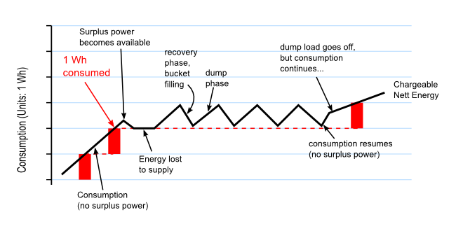

For the purpose of detecting surplus energy, the concept of an “energy bucket” has recently found great favour with DIY constructors. This concept is central to all versions of my Mk2 PV Router sketch. When using this system, the energy content of every individual mains cycle is calculated (no gaps!), and a running total of their sum is held in a suitably named variable in the controller’s code such as energyInBucket. Surplus energy is only diverted when there is sufficient virtual energy in the “energy bucket”.
The “energy bucket” approach is directly analogous to the operation of the utility meter at the grid connection point. The Mk2 PV Router monitors the flow of energy adjacent to the supply meter and adjusts power to the dump load in order to maintain zero net flow.

To consume a variable amount of surplus PV energy, power to the dump load needs to be cycled on and off as necessary in order to maintain an accurate balance between import and export. When power is cycled in this way, the effect on the supply meter needs to be considered.
All supply meters allow a certain range within which energy can flow freely in either direction. The extent of this range is typically 1 Wh or 3600 Joules. Providing that the net flow of energy into or out of the premises never exceeds this value, there will be no charge to the user nor will any surplus energy be lost. We call this the “sweet zone”, and the capacity of the energy bucket in all Mk2 PV Router systems to date has been set to 3600 J to match. Any system that diverts power needs to be able to operate reliably within this zone, and in order to do this, power to the dump load needs to be switched on and off at precisely defined times. The switching device that is normally used for this is a triac.

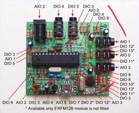

The emonTx Hardware
(This section applies particularly to the emonTx V2.)
The emonTx provides an RF-ready sensor platform with multiple inputs. The AC/AC adaptor for the voltage sensor needs to be purchased separately. This adapter has been formally tested as being suitable for this application and is inherently safe. Full construction details are available. It is possible to use the pulse input jack socket (DIO 3) to connect to the opto-isolator I.C and if that is done, the emonTx can be assembled exactly according to the build guide. In the unlikely event that the pulse input is required, or if extra outputs are needed, then a 3-pin header needs to be added to the port or ports of your choice (DIO 4-7) to provide the connection.
The emonTx I/O connections.
Using the emonTx V3
The emonTx V3.2, which uses the RFμ 328 module, can be used provided that the high sensitivity opto-trigger described in Choosing an Energy Diverter is used. The same applies to the emonTx V3.4 if the RFM12B radio module is fitted. If the emonTx V3.4 is fitted with the RFM69CW radio module, operation using the ac adapter as the sole power supply is not guaranteed and an external 5 V power supply should be used.
Using the emonTx Shield
It should be possible to use the emonTx Shield along with an Arduino Duemilanove, Leonardo or Uno instead of the emonTx. This will replace the p.c.b. for the voltage and current inputs, but as with the emonTx, a p.c.b. or stripboard for the output stage will still be required. The different input configuration will also necessitate some changes to the sketch.

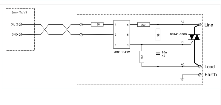

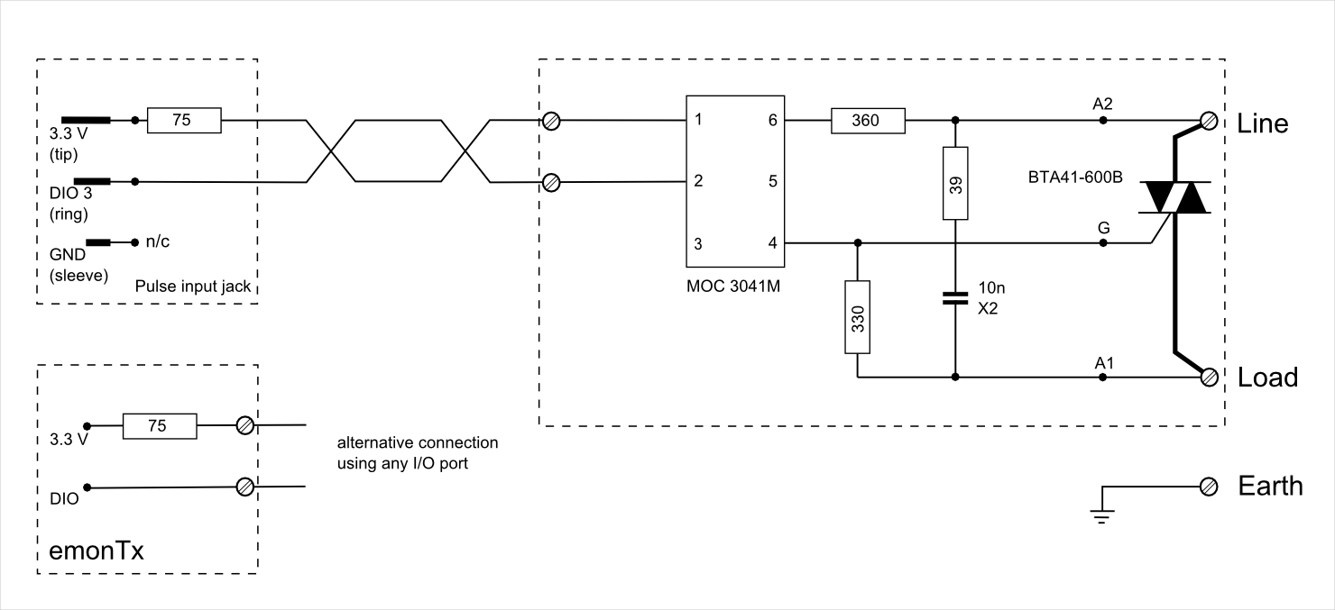

The Output Stage Hardware
If it is not convenient to route the power wiring close to the measurement point, it is easy to separate the controller from the triac assembly. A simple low voltage twisted pair (‘telephone’ or CAT5) cable is all that is required to link the two parts, and it should be good for many tens of metres. If the two parts are in the same enclosure, the current limiting resistor may be more conveniently located on the output circuit board, as shown for the emonTx V3.
Output stage circuit diagram for emonTx V2.
Output stage circuit diagram for emonTx V3. The differences between this and the emonTx V2 are explained in the overview.
The pcb for the output components mentioned above may be used with both the Arduino Uno and emonTx variants, and is available separately. Details can be found at https://openenergymonitor.org/emon/node/2044.

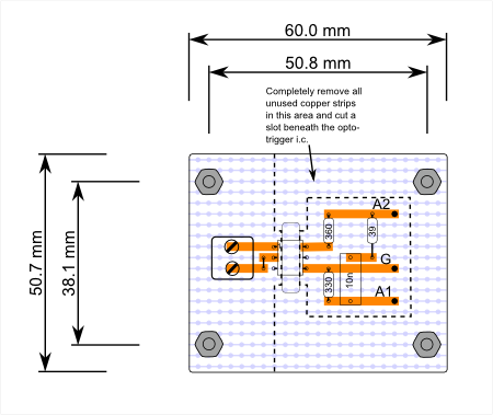

Alternatively, ‘Stripboard’ is the favoured method for many home construction projects.
Suggested stripboard layout – component side. The 75 Ω or 180 Ω current-limiting resistor may be mounted here if desired (with a minor modification to the low voltage side).
The optoisolator I.C. provides adequate isolation between the low voltage circuit and the mains provided its integrity is not compromised by the circuit board layout. You should have at least 7 mm of “creepage distance” between the high voltage and low voltage sides, and the only way to achieve this will be to cut a slot beneath the opto-isolator I.C, as shown.
The recommended triac is an insulated tab device, meaning that it is possible to bolt the tab directly to the heat-sink. However, an insulation kit comprising a silicone rubber washer and insulated bush is recommended and might improve the heat transfer from the device to the heat sink. In any event, the heatsink will need to be either outside the box or the box itself for performance reasons, so if touchable must be solidly earthed, and the high voltage wiring must be appropriately rated and insulated. All other live parts must be enclosed in an earthed metal box or double-insulated.

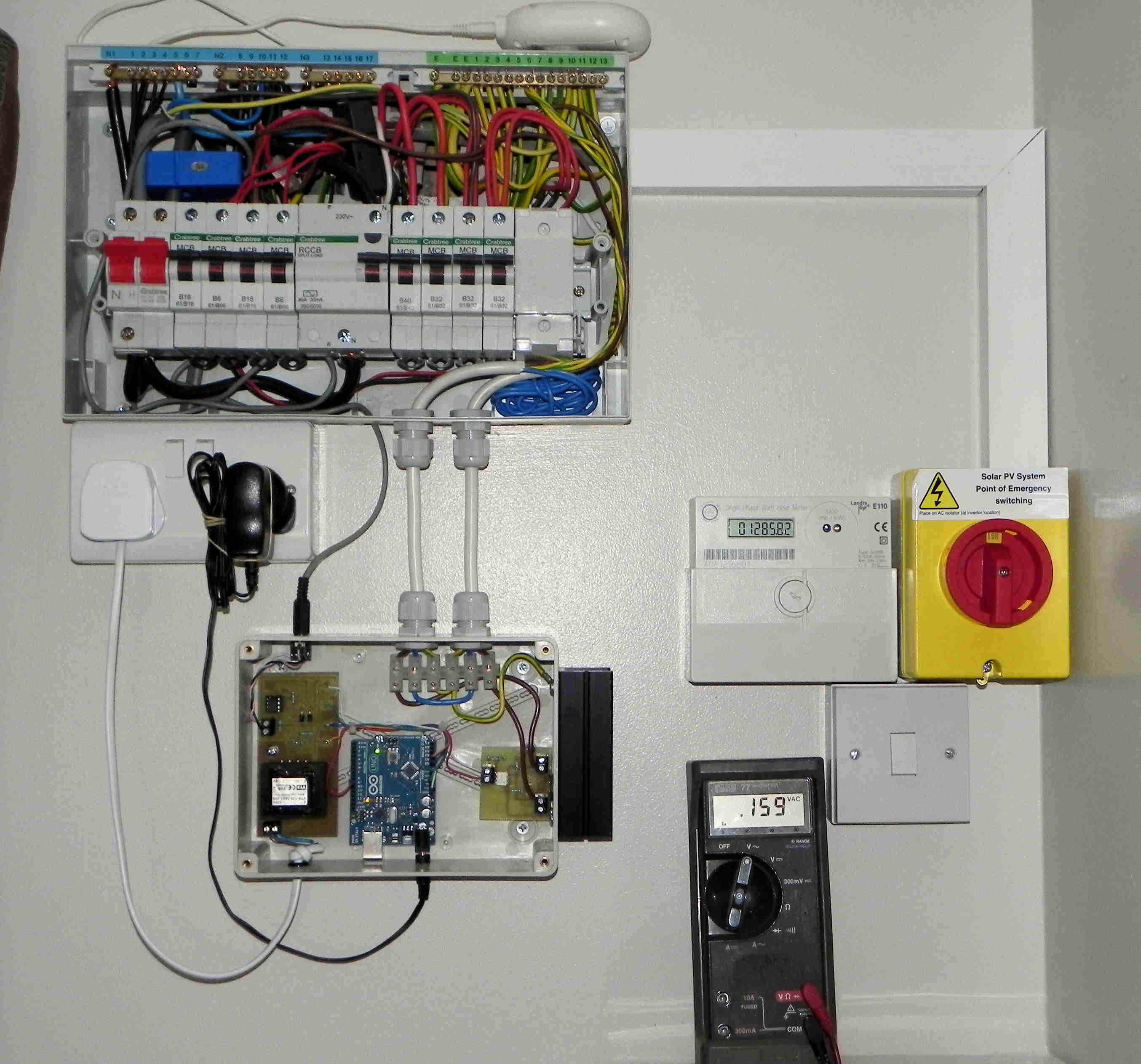

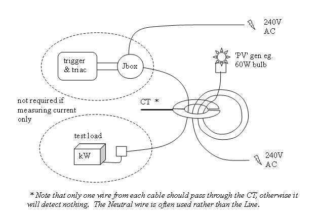

Having assembled the basic components (i.e. voltage and current sensors, and the processor), the measurement side of the system can then be tested. Various tools are available to allow this part of the system to be thoroughly checked. “Tallymode”, in any of the later Mk2 builds, provides an easy means for accurate calibration of the system. Although an AC supply is needed to stimulate the sensors, and to power the processor if a USB supply is not being used, no direct connect to the mains is required at this stage.
With the measurement side in order, the output stage needs to be tested. Any convenient appliance can be used as a temporary dump load for system checks; an immersion heater is not required. By running one core of the cable of the output circuit through the same CT as is measuring the PV, feedback is established so that the system can operate in a state of balance just as it would when working for real. A video which shows this technique in action is mentioned in my Mk2 summary list.

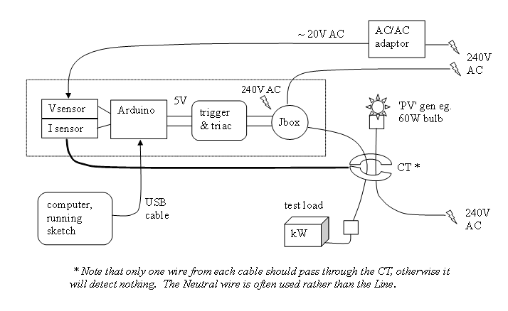

A Suggested Test-Rig for the Mk2 PV Router
The use of “Tallymode” can provide a complete picture of the system in its working state. By this means, a high degree of confidence can be obtained on a test rig before the hardware is moved its final location.
My recommended order of activities would be:
check that you can communicate with your Arduino. Does the “blink” sketch work?
connect the voltage and current sensors to suitable test circuits
run the MinAndMaxValues tool to check that the ADC’s output values are scaled appropriately for the values of voltage and current that are to be measured (80-90% of full scale is ideal). A second tool, RawSamplesTool, provides a one-shot display of the samples that are taken during a single mains cycle
adjust the value for voltageCal if necessary (see sketch for details)
run “Tallymode” in any of the later sketches to check/adjust the calibration for power
check the o/p stage. The load should go on at 1800 J. If it doesn’t, try reversing the CT.
set up a balance test with a 60 W bulb or similar for the ‘PV’. The load should ‘flicker’.
run any of the later builds in anti-flicker mode. It should still cycle, but more slowly
Congratulations. You appear to have a working system.
All versions of the Mk2 PV Router require the CT’s direction to be such that the energy bucket’s level increases when power is being exported, and decreases when power is being imported. This is the opposite way around to the guidance in the OpenEnergyMonitor’s Solar PV Application Note.
A Typical Installation
