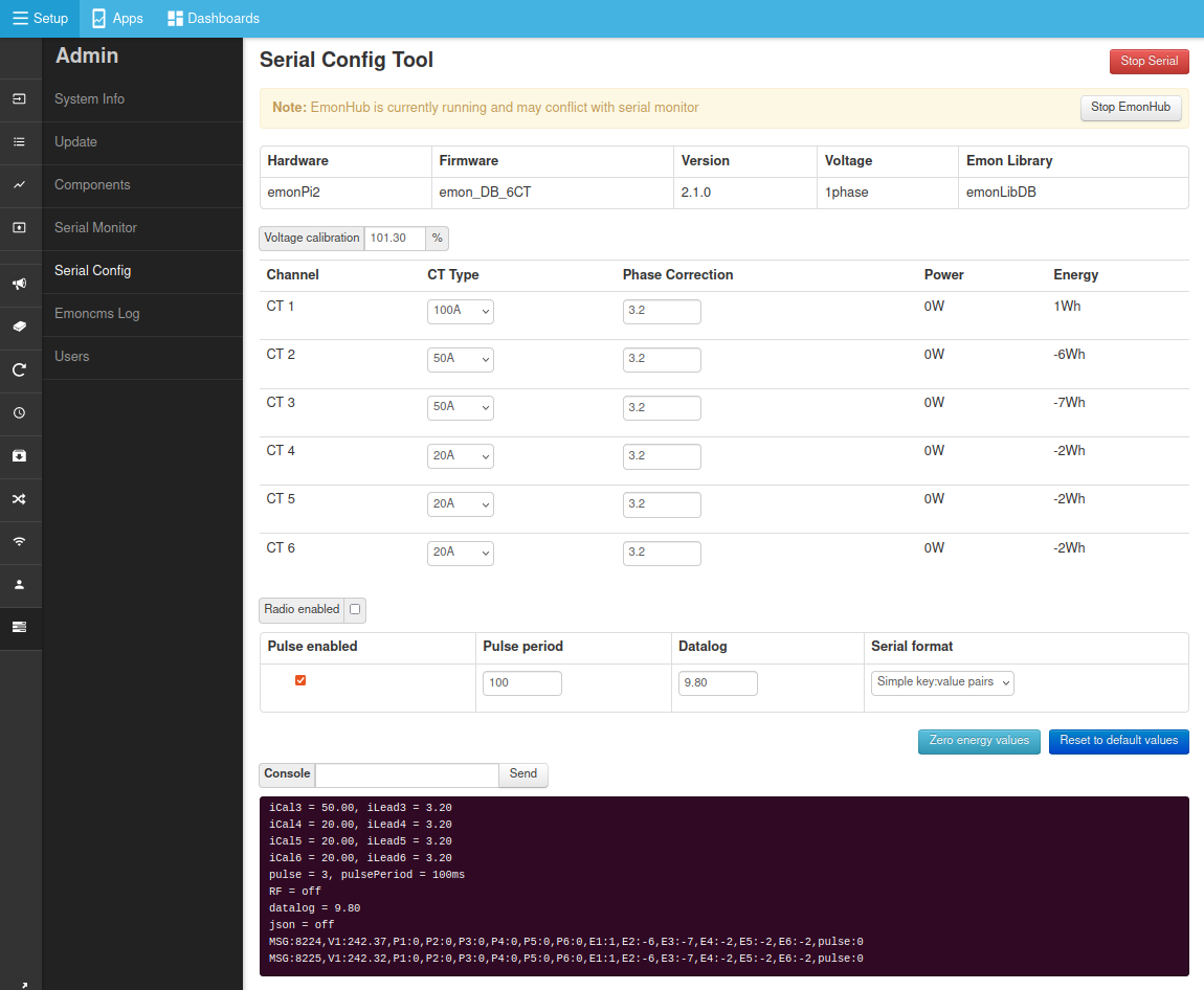

Through EmonCMS
The emonPi3 is usually pre-configured in the shop as part of the order process but can be re-configured at any point using the Serial Config tool available from the emonPi3 local EmonCMS interface.
  • Navigate to Setup > Admin > Serial Config
  • Click on Stop EmonHub to temporarily stop the EmonHub service while we perform calibration.
  • Select serial port /dev/ttyAMA0 and click Connect.
  • After a couple of seconds the emonPi3 will print out its current configuration which will populate the interface (if it does not do this type l and click Send to reload the calibration details from the emonPi3 measurement board).
  • Adjust any settings you need to change.
  • Click on Save Changes to ensure that the new configuration is recorded such that it persists when you power cycle the board.
  • When finished, click on Stop Serial to disconnect the serial configuration tool and then Start EmonHub to restart the EmonHub service.
