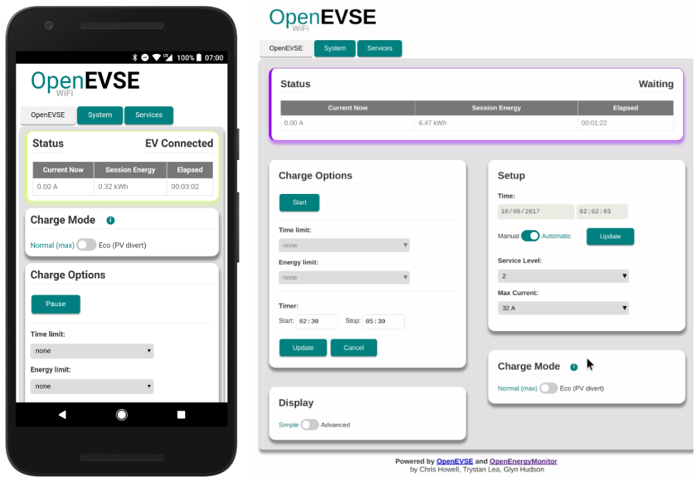

Web Interface Setup
All functions of the EVSE can be controlled via the web interface, see https://openevse.openenergymonitor.org for a live demo. This interface is optimised to work well on a mobile device.

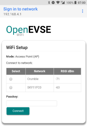

WiFi Setup
Once powered up connect to WiFi network with SSID
OpenEVSE_xxxx
with passwordopenevse
using a computer or mobile device.You should get directed to a captive portal where you choose to join a local network. If captive portal does not work, browse to http://192.168.4.1

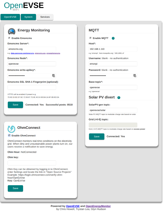

Emoncms Server Setup
Note
Emoncms server (HTTP) and MQTT both post the same status updates. Emoncms server and MQTT should not be connected to the same emonPi, since this will result in duplicate data. However, it is possible to use MQTT to post data to a local emonPi and Emoncms to post to a remote server e.g emoncms.org.
OpenEVSE can post data directly to an Emoncms server via HTTP(S), enter the following:
Emoncms server url e.g emoncms.org
Node-name is the name given to the OpenEVSE data in Emoncms Inputs
Write API key, obtained from Emoncms account page
SHA-1 fingerpint, if posting over HTTPS/SSL is required enter Emoncms server SHA-1 fingerprint. Recomended leave blank. The emoncms.org SHA-1 finger print will change ever few months.
See Emoncms Setup below for details of how to log the EVSE data in Emoncms

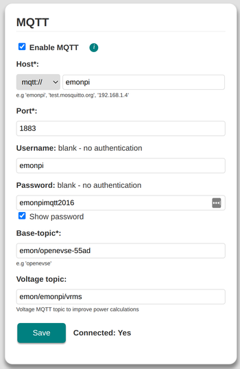

MQTT Setup
The OpenEVSE supports MQTT connection.
MQTT can used to communicate with an emonPi for Solar PV Divert (EcoMode) feature.
Note: MQTT will also send the same status updates as Emoncms HTTP (see above). MQTT and Emoncms HTTP should not be both enabled to post to the same Emoncms server e.g emonPi since this will result in duplicate inputs.
Note
For Solar PV Divert (EcoMode) to work emonPi and OpenEVSE need be on the same local network or at least access to emonPi MQTT server (port 1883)
Check your local emonPi hostname, this should bt emonpi/ or emonpi.local/. On some networks local hostname lookup doesn’t work. In this case use emonPi local IP address, highly recommend assigning emonPi a reserved local IP address to avoid it changing via DHCP.
Enter emonPi local network
To connect to an emonPi MQTT server on local network use pre-populated username and password
Base-topic is the base topic used by the OpenEVSE to publish data. If posting data to local emonPi via MQTT is required change base-topic to
emon/openevse
. EVSE data should will now appaar in local emonPi Emoncms InputsIf Solar PV Divert feature is required see Solar PV Divert section below for more info
![../_images/mqtt-setup.png](../_images/mqtt-setup.png)

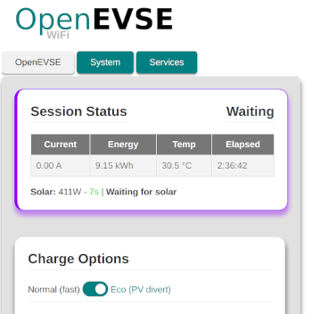

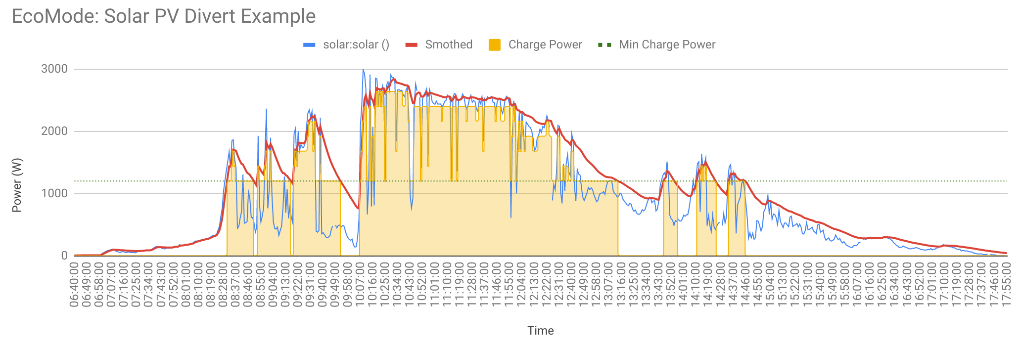

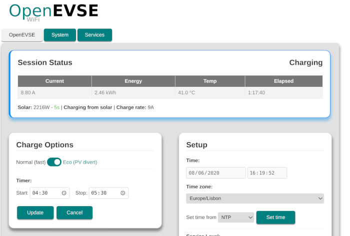

Eco Mode: Solar PV Divert
Eco Mode feature allows the OpenEVSE to adjust the charge rate based on the amount of available solar PV production or excess power (grid export).
An OpenEnergyMonitor solar PV energy monitor with an AC-AC voltage sensor adaptor is required to monitor solar PV generation and grid excess.
When Eco Mode is enabled the EVSE will begin charging when Solar PV Generation or Grid Excess > 1.4kW (6A the minimum EV charge rate). Charging will pause if Generation or Excess drops below this threshold for a period of time.
![../_images/ecomode-example.png](../_images/ecomode-example.png)
![../_images/ecomode-waiting.png](../_images/ecomode-waiting.png)
![../_images/ecomode-charging.png](../_images/ecomode-charging.png)

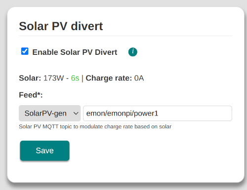

Solar PV Divert Setup
To use ‘Eco’ charging mode MQTT must be enabled and ‘Solar PV divert’ emonPi MQTT topics must be entered.
Integration with an OpenEnergyMonitor emonPi is straightforward:
Note: This guide assumes an OpenEnergyMonitor emonPi system is already setup monitoring solar PV, see not emonPi Solar PV Setup Guide
Connect to emonPi MQTT server, emonPi MQTT credentials should be pre-populated
MQTT Explorer can be used to view MQTT data e.g. subscribe to
emon/#
to see all OpenEnergyMonitor MQTT data. To lean more about MQTT see MQTT section of OpenEnergyMonitor user guide
![../_images/ecomode-setup.png](../_images/ecomode-setup.png)
Divert Total PV Generation:
Preferable if another solar PV diversion system is fitted e.g hot water immersion, battery storage or the solar PV system is small. Setting the EVSE to divert the total PV generation to the EV will ensure the EV takes priority over other diversion systems that may be fitted.
Enter MQTT topic of the solar PV generation into the
Solar PV Generation
field e.g if emonPi CT1 is monitoring generation enteremon/emonpi/power1
or if using emonTx CT2emon/emontx3/power2
. Leave the Grid field empty

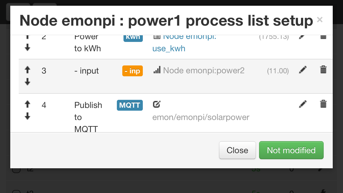

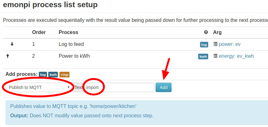

Advanced Solar PV Divert Setup
In some installations it may be not possible measure the correct metric required by the EVSE e.g solar PV gen or grid import / export. However if is possible to calculate the required metric by addition or subtraction using Emoncms Input Processing the resulting value then then be published to a new MQTT topic which can be used by the EVSE. eg This maybe required for a Type 1 solar PV system: Grid (import/export) = site-consumption – Generation
To publish a value to a new MQTT topic feed use the Emoncms Publish to MQTT
Input Process then enter a new unique MQTT topic e.g grid
or import
then use this new MQTT topic in the EVSE config.
For more advance solar PV divert config it’s possible to modify the MQTT feed value and republish to a new topic using Emoncms Input processing or something like NodeRED.

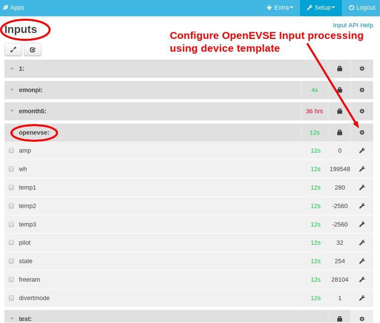

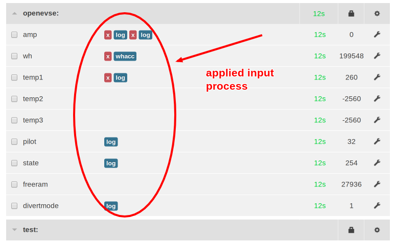

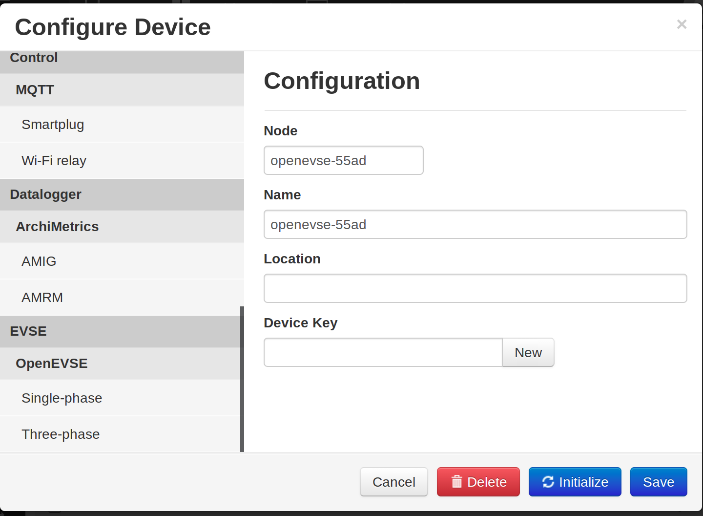

Input Processing
On the Emoncms Inputs page click the ‘cog’ icon on the OpenEVSE device to log OpenEVSE Inputs to Feeds using Device Module template:
Note: If OpenEVSE Inputs are not present see section 1 to check OpenEVSE WiFi Emoncms service setup settings.
Choose OpenEVSE device template then click Save:

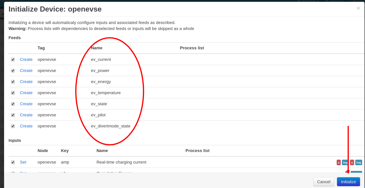

Device Module shows the Feeds and Input Processing which will be applied:
Once Initialized and saved the Device Module has automatically applied the correct Input Processing to the OpenEVSE Inputs:

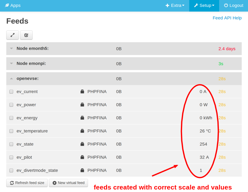

On the Emoncms Feeds page the OpenEVSE Feeds should now be there with correct scale, names and units:

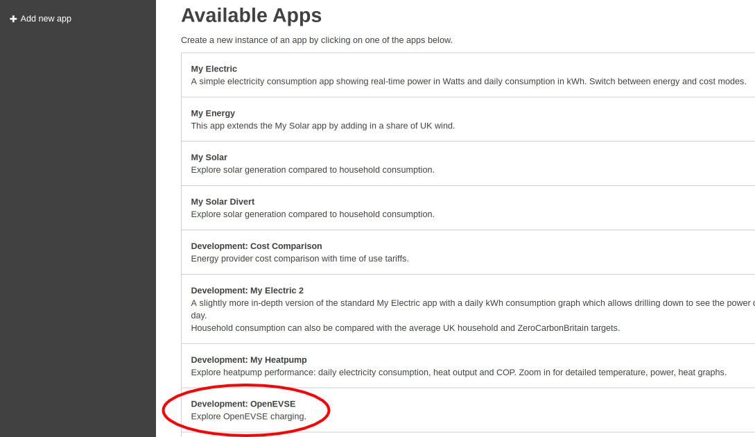

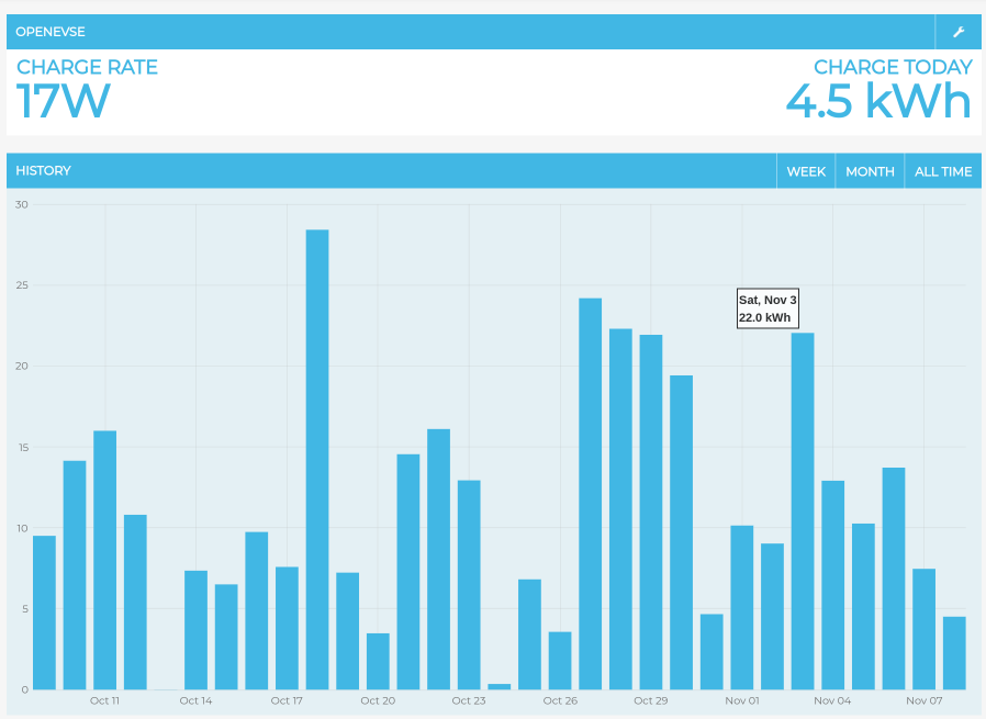

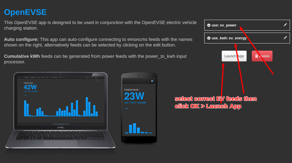

Emoncms ‘Apps’ Dashboard
Click on ‘Apps’ on the Emoncms top bar then select new OpenEVSE App

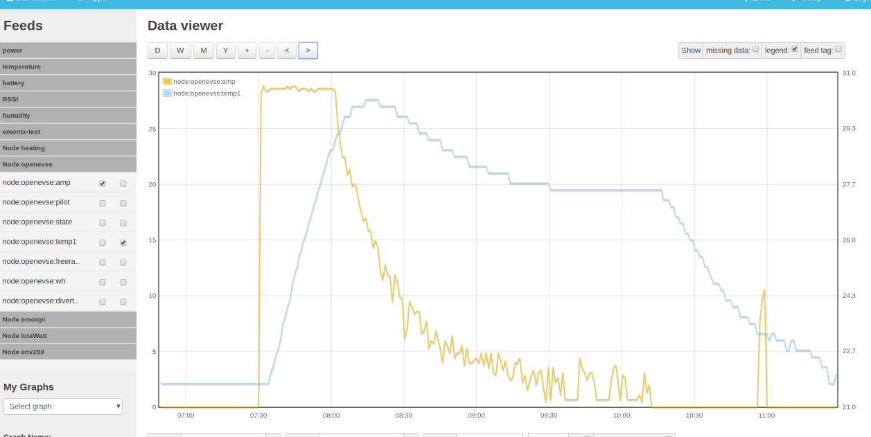

Clicking on a Feed on the feeds page will open the Emoncms Graph display to show the raw feed data. Various Feeds van be displayed at once, e.g. looking at the effect of the internal temperature of the OpenEVSE unit during a charge:
The OpenEVSE has integrated temperature monitoring and will automatically throttle charging current and eventually stop a charging session if the temperature gets too hot.
