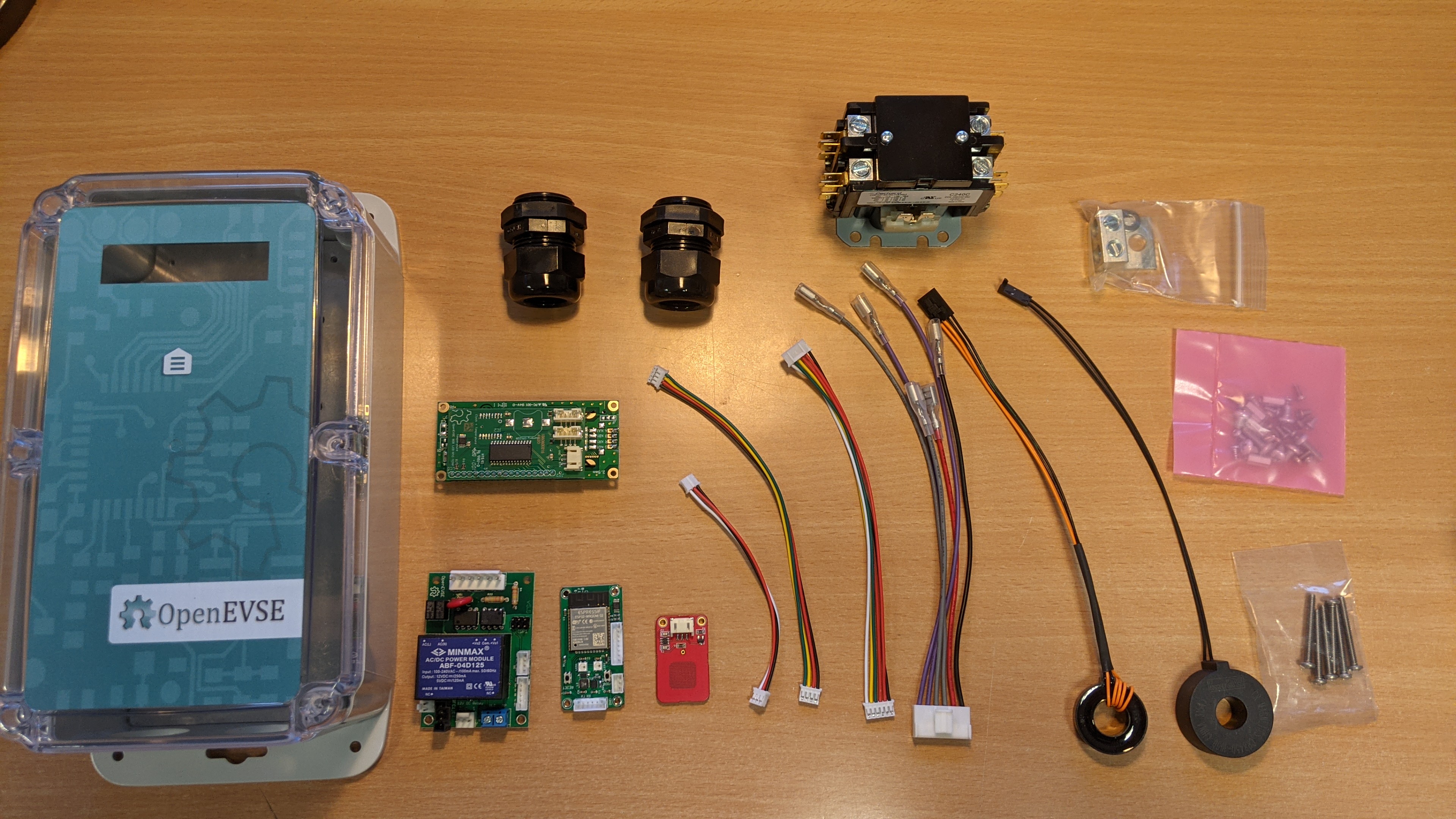

Step 1
Check kit contents
Note: cable glands and base-plate are inside the enclosure in the photo

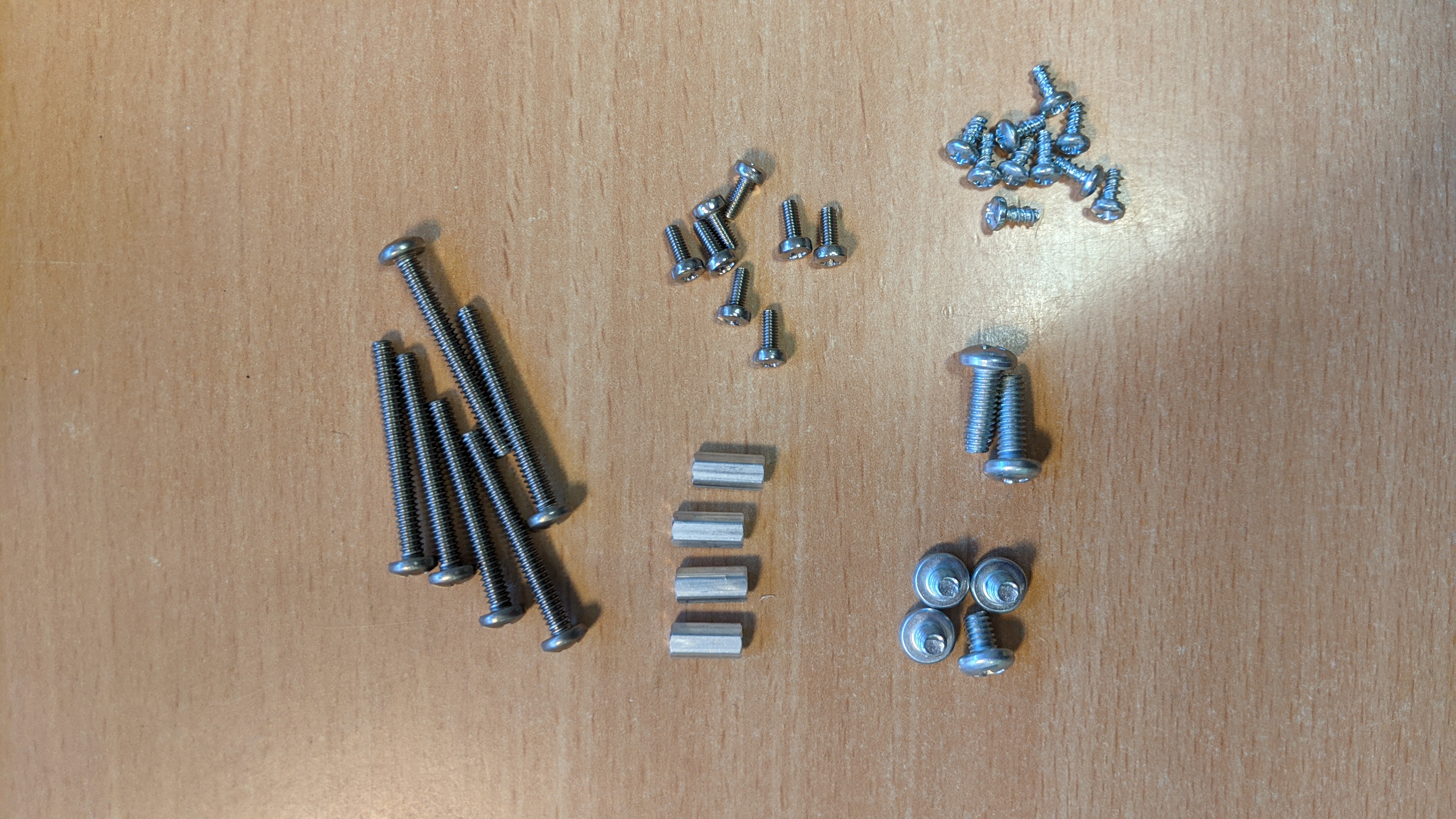

Step 2
Check screws and fastners
Note: there may be spare screws included

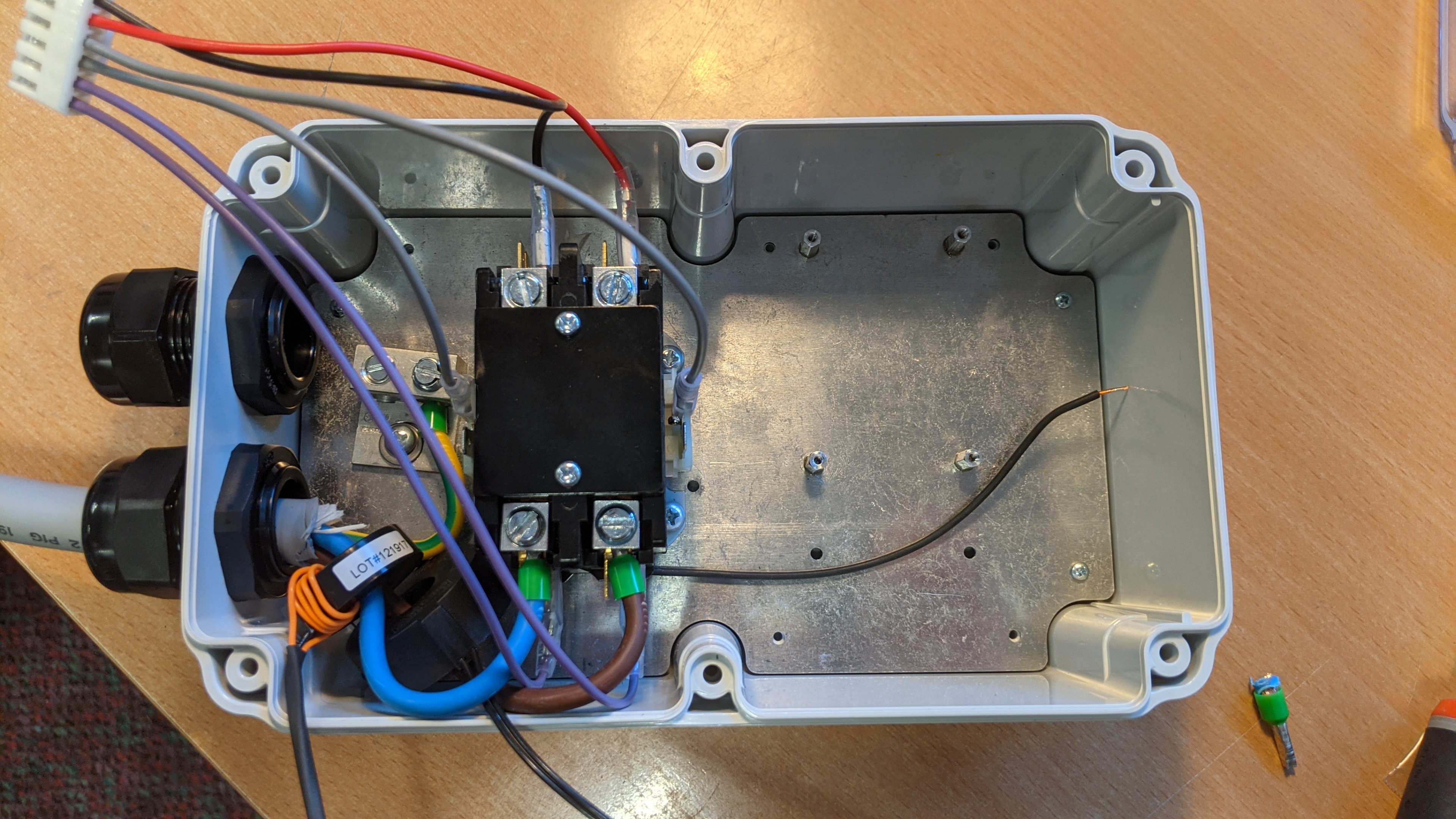

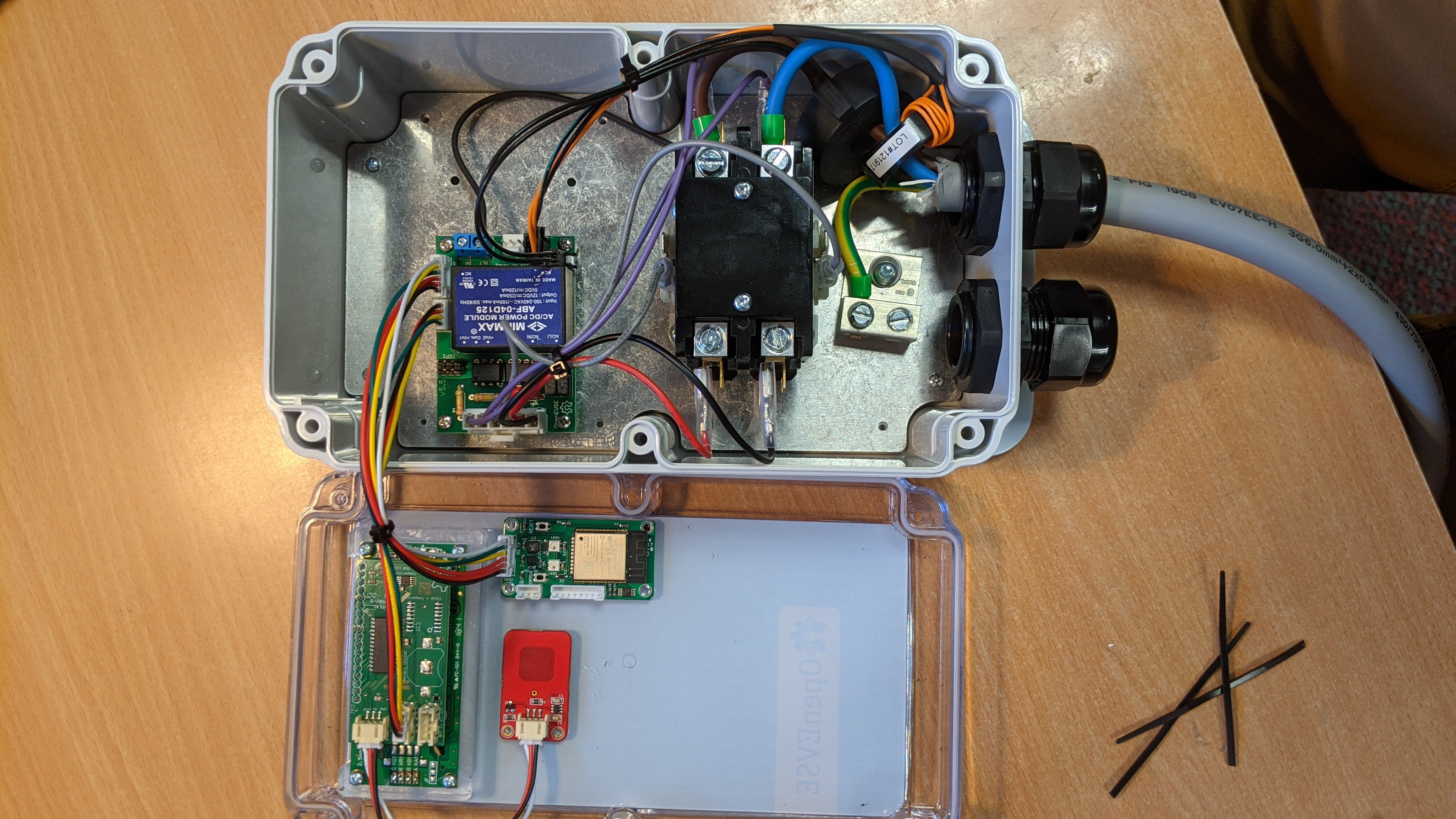

Step 3

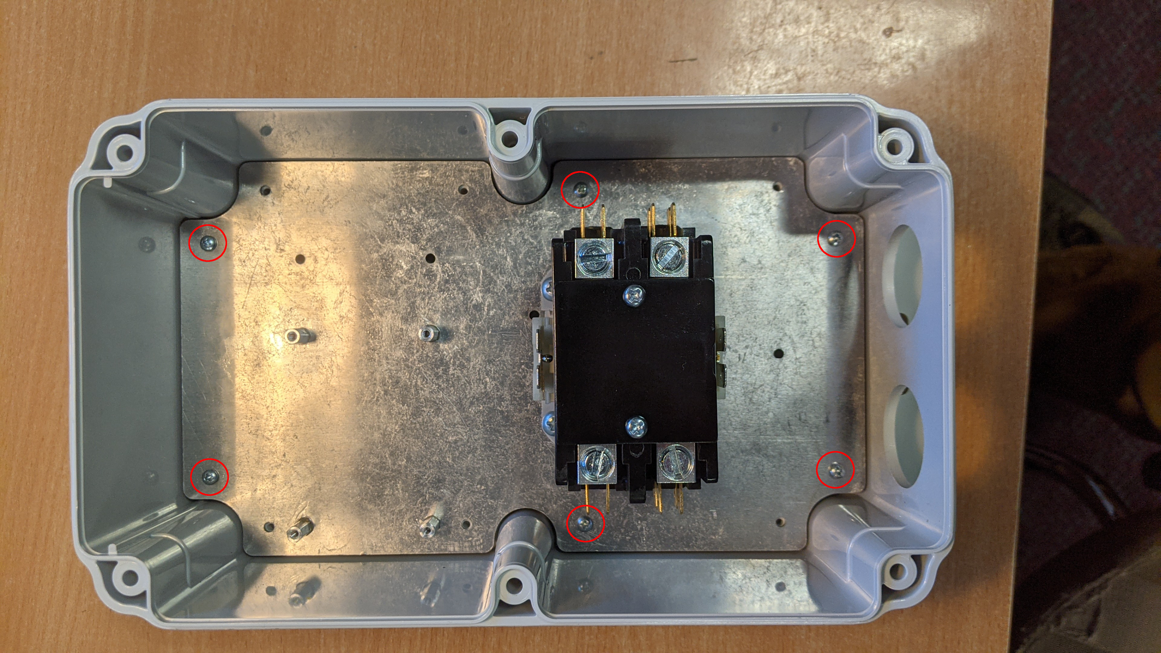

Screw contactor to base plate using FOUR self-tapping screws
Mount the FOUR 10mm standoffs to the top side of the plate with FOUR M2.5 x 6 mm screws
Mount Earth bar to the plate with ONE 1/4” self tapping screws
Mount plate in enclosure with SIX coarse threaded 6mm screws

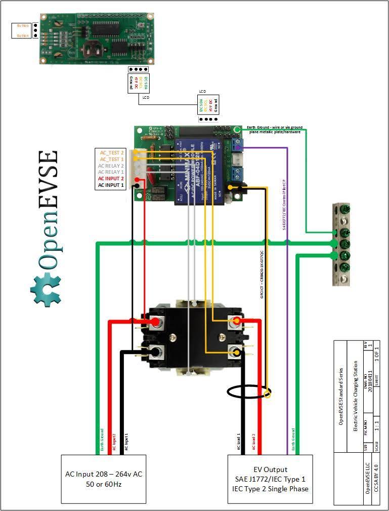

Step 4

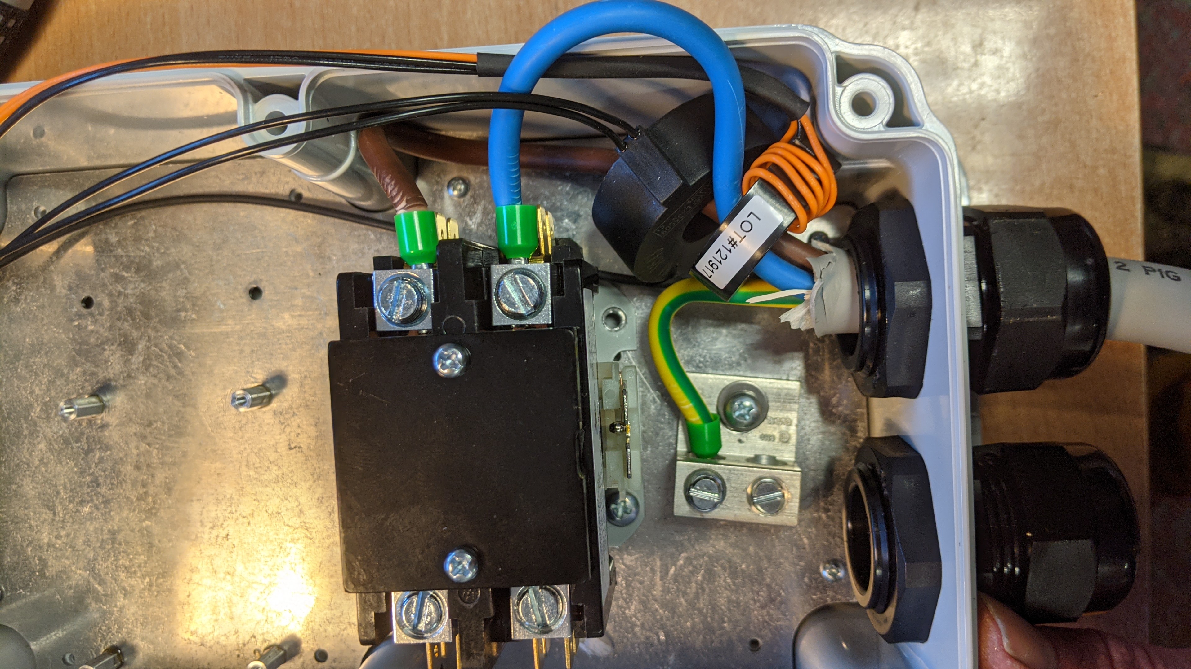

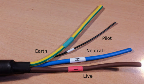

EV cable wiring

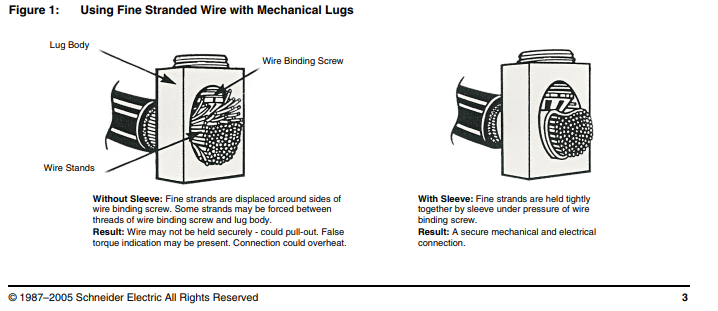

Bootlace ferrules crimped terminals should be used for EV cable connections. This fine stranded wire is susceptible to creeping out of a terminal due to thermal cycling resulting in possible overheating
Install the TWO cable glands
Insert EV Cable through the Cable Gland on the right and tighten
Connect the ground wire to the ground block
Thread BOTH Line and Neutral wires through the 4 wire GFCI coil with the orange self test loop (do NOT thread the Earth wire through)
Thread EITHER Line OR Neutral through the Current Measurement Coil

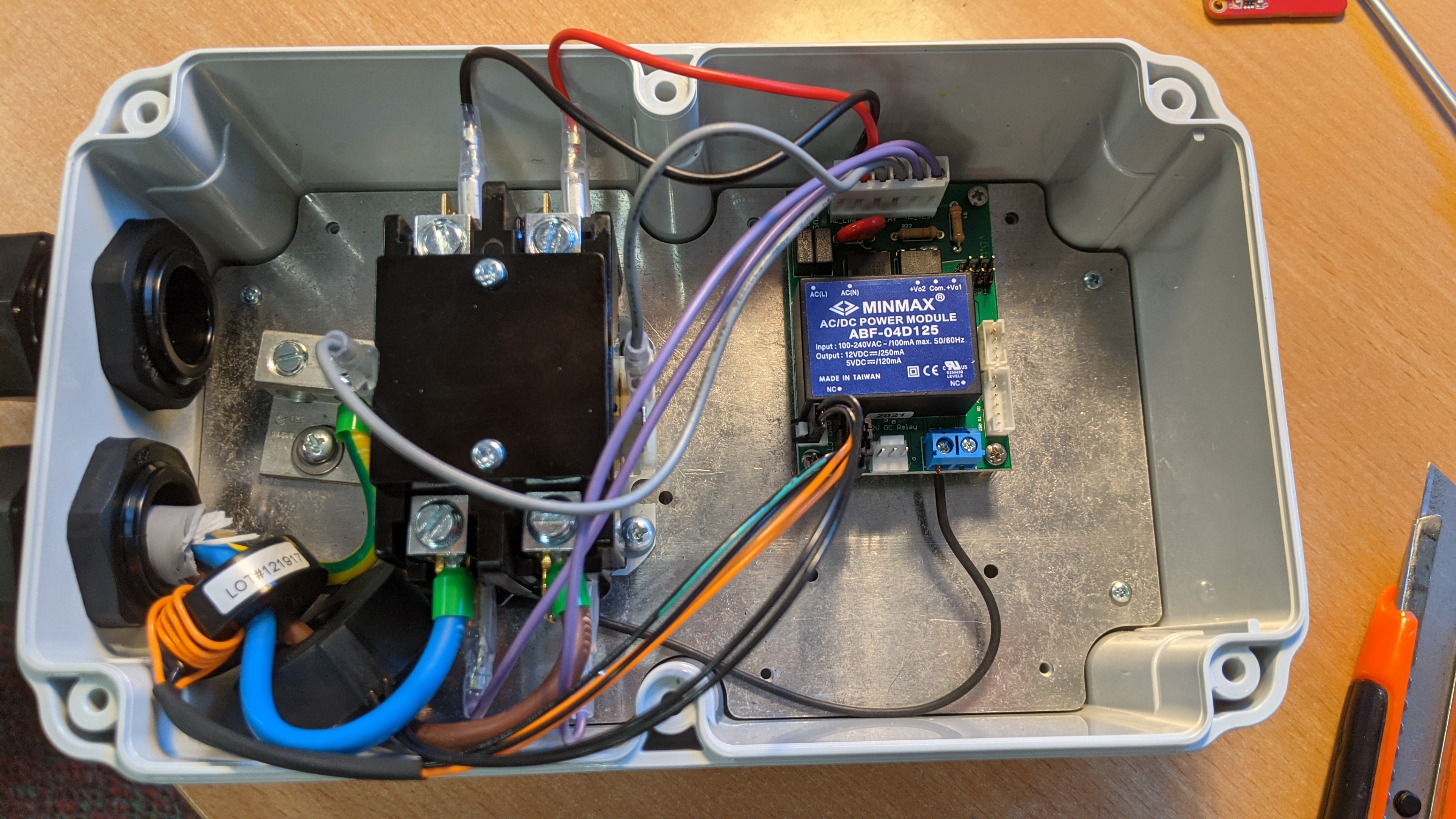

Step 5
Connect the controller harness to the contactor
Step 6
Install the OpenEVSE controller
Connect the pilot wire to the controller
Connect the controller harness to the controller
Connect the GFCI coil and the Current measurement coil to the controller

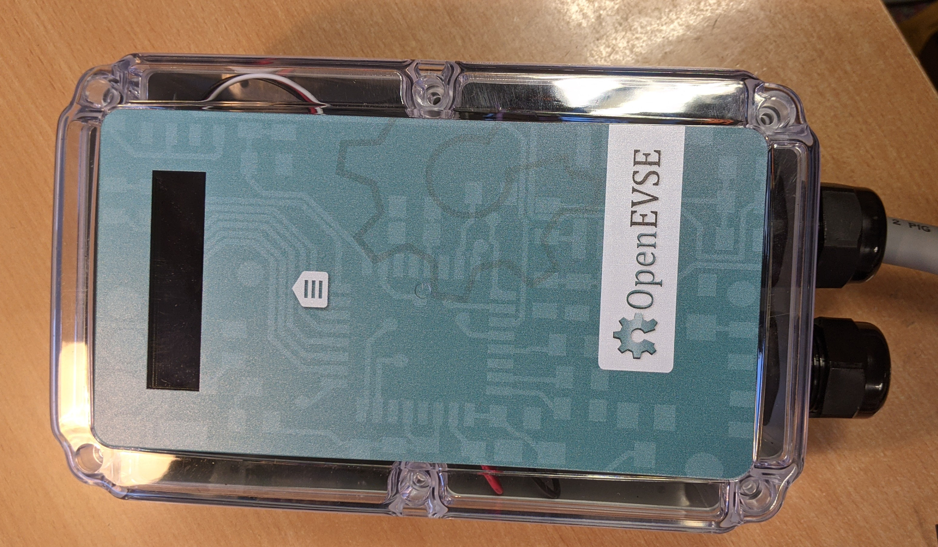

Step 7

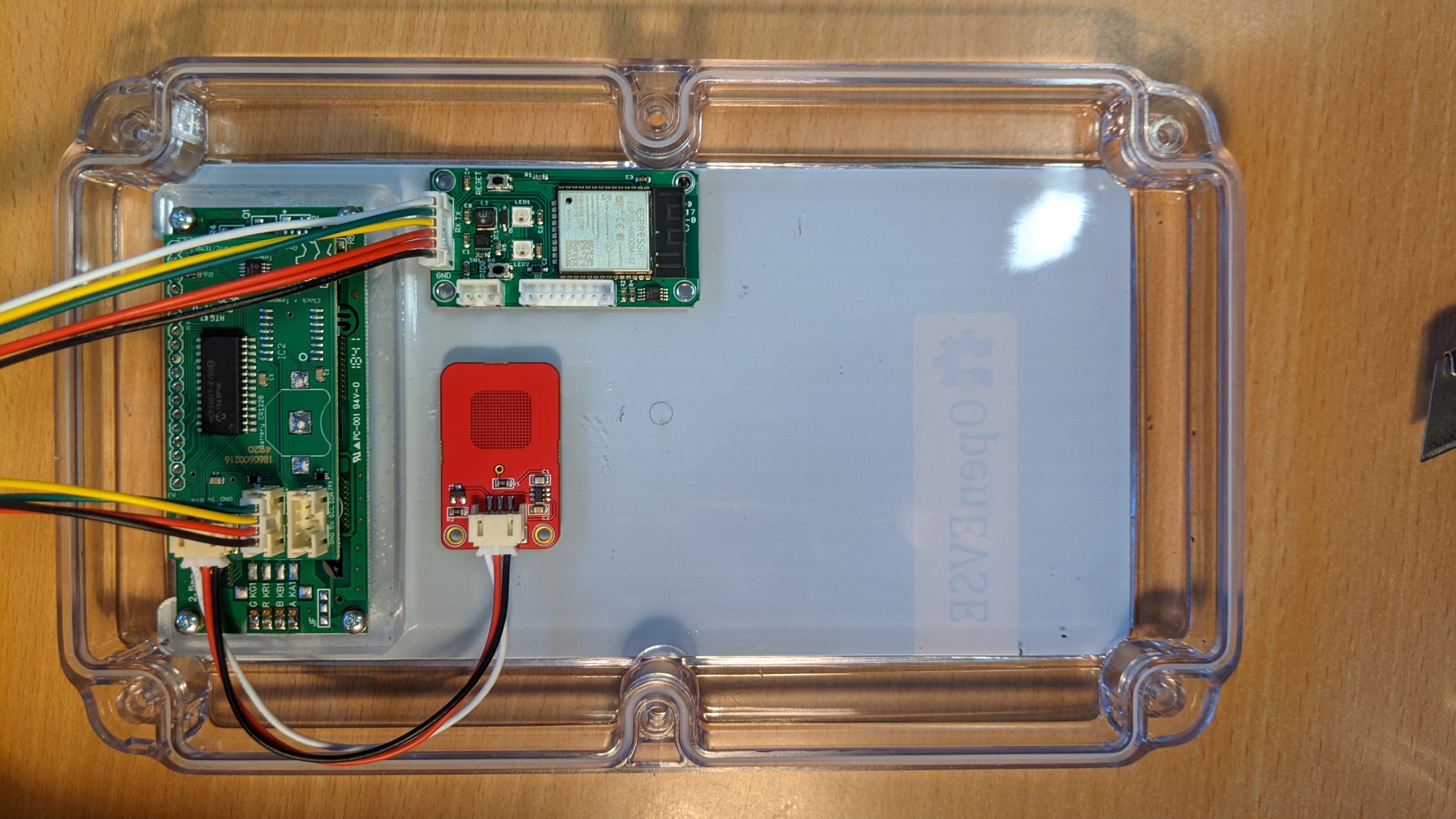

Screw the LCD to the enclosure lid using self tapping screws
Stick the touch button and WiFi module to the enclosure lid using double sided sticky tape. On current models the touch button has been substituted for a physical push button
Step 8
Use zip ties to tidy up the cables
Ensure low voltage cables are routed away from 230V connections
