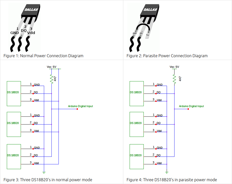

Multiple sensors can be connected to the same data bus. Each sensor identifies itself by a unique serial number.
The sensor can operate in normal or parasite mode. In normal mode, a 3-wire connection is needed. In parasite mode the sensor derives its power from the data line. Only two wires, data and ground, are required.
Note: The Arduino positive supply rail is referred to as Vcc and the positive supply for the DS18B20 as Vdd. In this context, the two are the same.
Normal Mode
In normal mode, each sensor is connected between a power line (Vdd pin 3) and ground (GND pin 1), and the data output (DQ pin 2) connects to a third, data, line. The data output is a 3-state or open-drain port (DQ pin 2) and requires a 4k7 pull-up resistor. The data line is connected to an available Arduino digital input or Screw Terminal 6 on the emonTx V3, or DIO 4 on the emonTx Shield. GND is available on Screw Terminal 3 and switched power on terminal 5 of the emonTx V3. When using the RJ45 connector on the emonTx V3.4 or the emonPi, the connections are GND: pin 5, power (not switched): pin 2, data: pin 4.
Normal mode is recommended when many devices and/or long cable runs are involved.
Parasite Mode
Parasite power mode requires both DS18B20 GND (pin 1) and Vdd (pin 3) to be connected to ground. The DQ pin (pin 2 - the middle pin) is the data/parasite power line. The data line requires a pull-up resistor of 4k7 connected to + 5 V. The data line is connected to an available Arduino digital input or Screw Terminal 6 on the emonTx V3, or DIO 4 on the emonTx Shield.
Parasite mode should be used only with a small number of devices, over relatively short distances.
