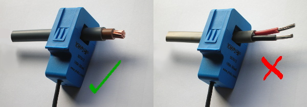

THE CURRENT TRANSFORMER MUST BE INSTALLED ON A SINGLE CURRENT-CARRYING WIRE…
CT on cable - right & wrong
…as in the left-hand picture.
If you put it on a twin-core, or any multi-core cable, as in the right-hand picture, then it will measure the sum of the currents in each of the conductors. In the case of a twin-core or twin-core & earth cable, the same current will be flowing in opposite directions and the sum will be zero. This is almost certainly not what you want.

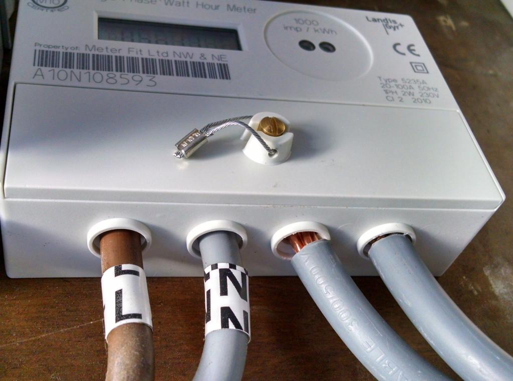

If any part of your wiring looks like this:
then you must get professional advice. Even though the meter shown above was (presumably) installed and sealed by the electricity distribution authority, it is dangerous and illegal because a bare conductor is exposed.
(Exposed copper is visible on both the line and neutral conductors. Just because the worst is the neutral conductor is no excuse. If the neutral is damaged and broken anywhere on the supply side of this meter then that neutral will become live at the full mains voltage if anything is switched on downstream.)
