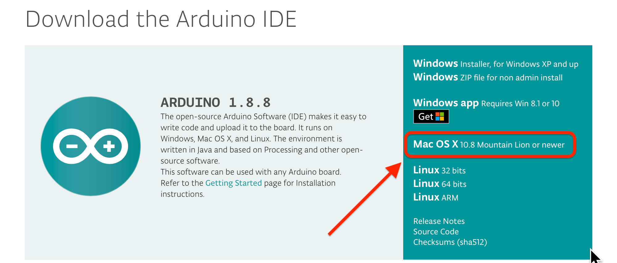

Download the latest Arduino IDE here and click on the Mac OS X installer.
This will download the Arduino app to the Download folder. After completion move the Arduino.app to your Applications folder.
Note: If the file is downloaded as a ZIP file then double-click to uncompress. And then move the file to the Applications folder.

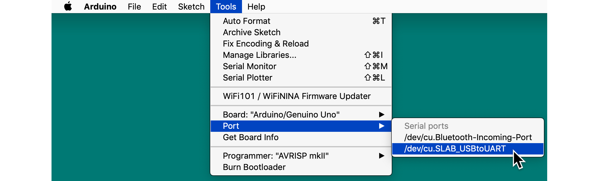

Make sure you restart the Arduino IDE after installing the drivers. Before connecting the programmer, check Tools > Port and make note of the available ports. Now connect the programmer and your module (emonTx, emonTH, etc). Go back to the main menu and select Tools > Port again. Port should be available and showing a new port. Select the port /dev/cu.SLAB_USBtoUART. And under Tools > Board ensure Arduino/Genuino Uno is selected.
