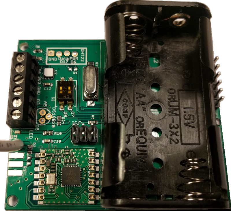

The Si7021 sensor can be seen in the top right-hand corner of the PCB. The white film on top of the sensor is a dust film and should not be removed. The dust film is factory fitted and will protect the sensor from dust and air contaminants.
