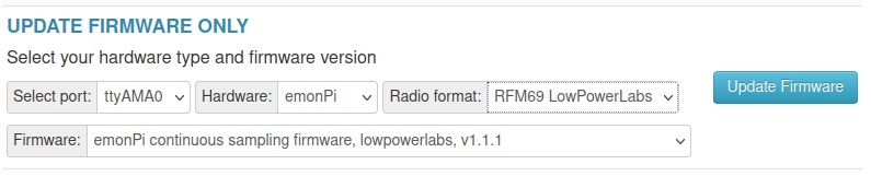

Updating firmware directly from the emonPi user interface
The easiest way of updating the emonPi firmware is to use the firmware upload tool available at Setup > Admin > Update > Firmware.
Select port: ttyAMA0 and Hardware: emonPi. Then depending on which firmware variant you wish to upload as described above select the radio format and firmware as required.
Click Update Firmware to upload the firmware.
