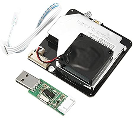

SDS011 Air-Quality sensor
1. Plug the SDS011 sensor into a USB port on either the emonPi or emonBase.
../_images/sds011.jpg

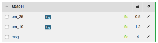

3. The SDS011 readings will appear on the Emoncms Inputs page within a few minutes and should look like this:
../_images/sds011_emoncms.png
Tip: When logging the SDS011 inputs to feeds, make sure to set the feed interval to match the sensor readinterval, e.g select 5 minutes if readinterval is set to 5.

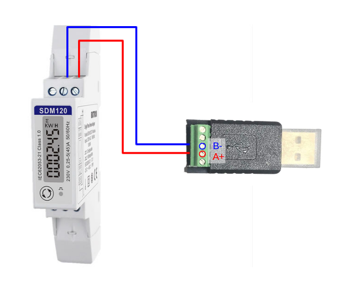

SDM120 and SDM230 single-phase
The SDM120-Modbus-MID and SDM230 are single phase electricity meter provides MID certified electricity monitoring up to 45A or 100A, ideal for monitoring the electricity supply of heat pumps and EV chargers. A USB to RS485 converter is needed to read from the modbus output of the meter.The SDM120 / SDM230 meter comes in a number of different variants, be sure to order the version with a modbus output (SDM120-MBUS-MID).
1. Connect up the USB to RS485 converter to the modbus output of the SDM120 meter and plug the converter into a USB port on either the emonPi or emonBase.
../_images/sdm120_modbus.png
2. Login to the local copy of Emoncms running on the emonPi/emonBase and navigate to Setup > EmonHub. Click on ‘Edit Config’ and add the following config to the interfacers section to enable reading from the SDM120 meter:
read_interval: Interval between readings in seconds

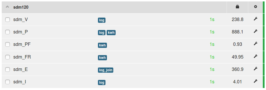

3. The SDM120 readings will appear on the Emoncms Inputs page within a few seconds and should look like this:
../_images/sdm120_emoncms.png
Tip: When logging the cumulative energy output (sdm_E) to a feed, use the ‘log to feed (join)’ input processor to create a feed that can work with the delta mode in graphs. This removes any data gaps and makes it possible for the graph to generate daily kWh data on the fly.

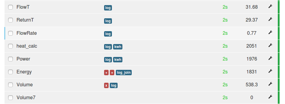

ZPmeter Heat Meter 223F
EmonHub can read from a ZPmeter Heat Meter 223F made by Hangzhou Zhongpei using the following config.
Note: The ZPmeter modbus interface requires 5V, this can be taken from RaspberryPi GPIO pin 2 or pin 4.
    [[ZPMETER]]
        [[[init_settings]]]
            #device = /dev/serial/by-id/usb-1a86_USB_Single_Serial_56D1092300-if00
            device = /dev/ttyACM*
            baud = 9600
            datatype = int
            parity = none
        [[[runtimesettings]]]
            pubchannels = ToEmonCMS,
            read_interval = 10
            nodename = zpmeter
            [[[[meters]]]]
                [[[[[heatmeter]]]]]
                     address = 7
                      registers = 1,3, 5, 7, 9, 15, 13,11,16,17,21
                      names = Energy, CoolEnergy, FlowT, ReturnT, dT, Power, FlowRate, Volume, 16unknown, runtime, Error
                      scales = 0.01,0.01,0.01,0.01,0.01,10,0.0001,0.01,1,1,1
                      units = kWh,kWh,C,C,C,W,m3/hr,m3
The default modbus ID for the Zpmeter we tested was 7. It’s unknown how to set the ID and it’s unknown if the ID is always 7.
The modbus ID was found using using this scan tool, this will scan from ID 1-247: mbpoll -a 1:247 -b 9600 -d 8 -P none -s 1 -m rtu /dev/ttyACM0

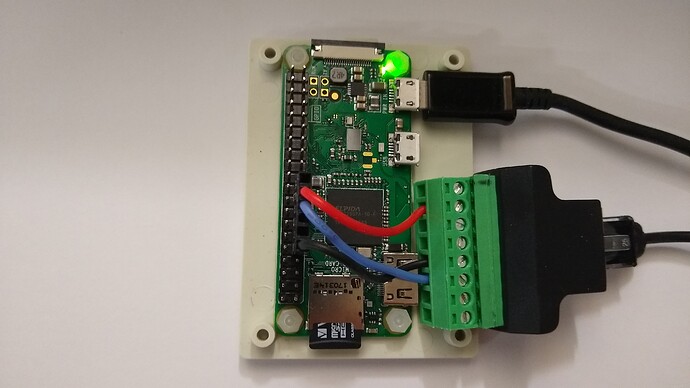

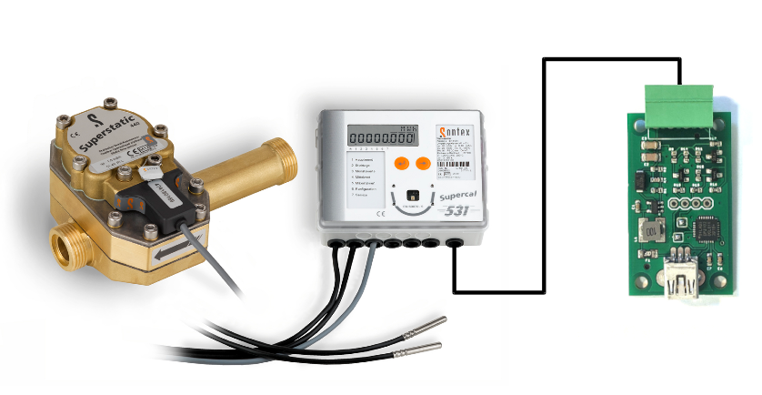

M-Bus Reader for Heat meters
Many electricity and heat meters are available with meter bus (M-Bus) outputs. Using an M-Bus to USB converter, these can be read from an emonPi or emonBase. For heat pumps, this provides a convenient way of monitoring the heat output, flow temperature, return temperature, flow rate and cumulative heat energy provided by the system.
1. Connect up the USB to M-Bus converter to the M-Bus output of the meter and plug the converter into a USB port on either the emonPi or emonBase.
../_images/mbus_reader.png
2. Login to the local copy of Emoncms running on the emonPi/emonBase and navigate to Setup > EmonHub. Click on ‘Edit Config’ and add the following config in the interfacers section to enable reading from the M-Bus meter:
  • baud: The M-Bus baud rate is typically 2400 or 4800. It is usually possible to check the baud rate of the meter using the meter configuration interface.
  • read_interval: Interval between readings in seconds.
List attached meters as shown in the example below.
  • address: The address of the meter is also usually possible to find and or set via the meter LCD configuration interface. If in doubt try 0 or 254. It’s also usually possible to set the ID by M-Bus interface Here is a script to check and set the address which has been tested to work on Kamstrup Multical 403 and Sontex 531.
  • type: Available options include: standard, qalcosonic_e3, sontex531, sdm120
Note: We’ve experienced reliability issues reading from the M-Bus version of the SDM120 electric meters. We recommend using the Modbus version with a seperate Modbus reader for more reliable results. For more information please see https://community.openenergymonitor.org/t/sdm120-mbus-meter-freezing-drop-out/20765/2.

The battery powered Sontex 789 receives power via the M-Bus reader, thefore battery will last indefinitely.
Qalcosonic E3
[[MBUS]]
    Type = EmonHubMBUSInterfacer
    [[[init_settings]]]
        device = /dev/ttyAMA0
        baud = 2400
        read_interval = 10
        validate_checksum = False
        nodename = MBUS
        [[[[meters]]]]
            [[[[[heatmeter]]]]]
                address = 1
                type = qalcosonic_e3
Sharky 775
[[MBUS]]
    [[[init_settings]]]
        baud = 2400
        read_interval = 10
        nodename = mbus
        [[[[meters]]]]
            [[[[[heatmeter]]]]]
                address = 25
                type = standard
Example heat meter data:
../_images/mbus_emoncms.png
Tip: When logging the cumulative energy output (Energy) to a feed, use the ‘log to feed (join)’ input processor to create a feed that can work with the delta mode in graphs. This removes any data gaps and makes it possible for the graph to generate daily kWh data on the fly.

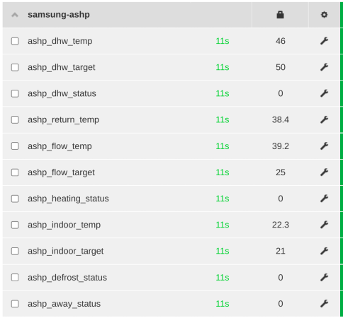

Samsung ASHP
../_images/samsung-ashp.jpg
EmonHub (V2.3.4) can read data directly from a Samsung Air Souce Heat Pump (ASHP) or HVAC unit equipped with the Samsung Modbus Interface MIM-B19.
Example emonhub config:
[[SAMSUNG-ASHP-MIB19N]]
    [[[init_settings]]]
        device = /dev/ttyUSB0
        baud = 9600
        parity = even
        datatype = int
        read_interval = 20
        nodename = samsung-ashp
        # prefix = sdm_
        [[[[meters]]]]
            [[[[[ashp]]]]]
                device_type = samsung
                address = 1
                registers = 75,74,72,65,66,68,52,59,58,2,79,87,5,89
                names = dhw_temp,dhw_target,dhw_status,return_temp,flow_temp,flow_target,heating_status,indoor_temp,indoor_target, defrost_status,away_status,flow_rate,outdoor_temp,3_way_valve
                scales = 0.1,0.1,1,0.1,0.1,0.1,1,0.1,0.1,1,1,0.1,0.1,1
                precision = 2,2,1,2,2,2,1,2,2,1,1,2,2,1
Example Samsung ASHP data in Emoncms:
../_images/samsung-ashp-emoncms.png
EmonHub also makes this data available via MQTT emon/samsung-ashp
