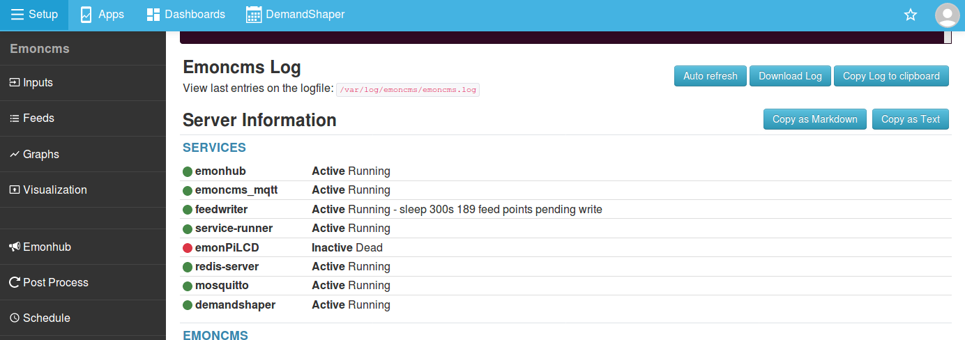

There are a number of things to check if inputs or feeds are not updating. The first is to check the status of emoncms services on the Emoncms > Admin page:
Services: emonhub, emoncms_mqtt, feedwriter, redis-server and mosquitto should all be ‘Active Running’.
Service status can also be checked via SSH command, e.g:
sudo systemctl status emoncms_mqtt.service
Potential causes of services not running may be:
  • Incorrect configuration
  • Incorrect installation
  • Full /tmp partition
  • Full /var/log partition
  • Unclean power cycle / power-cut related SD card corruption
redis-server is a dependency of emoncms_mqtt and feedwriter.
mosquitto is a dependency of emonhub and emoncms_mqtt
